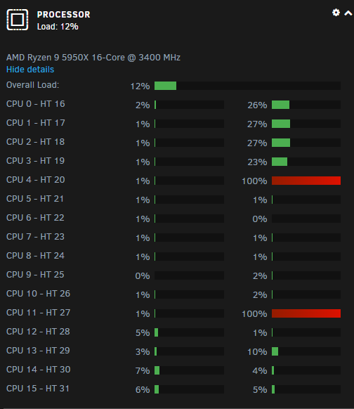

Also, it "half-crashed" again, but this time half of my containers stopped working completely and 2 of my cores are maxed out. Again, I have no idea where to look through the diagnostics file
asta-diagnostics-20230425-1230.zip
