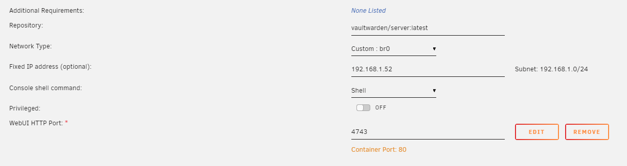

Hey guys,
I've setup VaultWarden using the default WebUI HTTP Port of 4743, but this doesn't seem to be working. I can only get this to work with port 80. I'm wanting to get this setup with a different port and use Nginx for my proxy manager. Thanks!
So the webgui doesn't load?  What's not working?
If i change the port to 4743 it still only works on port 80.
If you use a custom network then I believe that port mapping does not apply and you can only use the ports built into the container.
Oh really? I am using the custom network type. That's interesting. So I would need to use a bridge network type?
