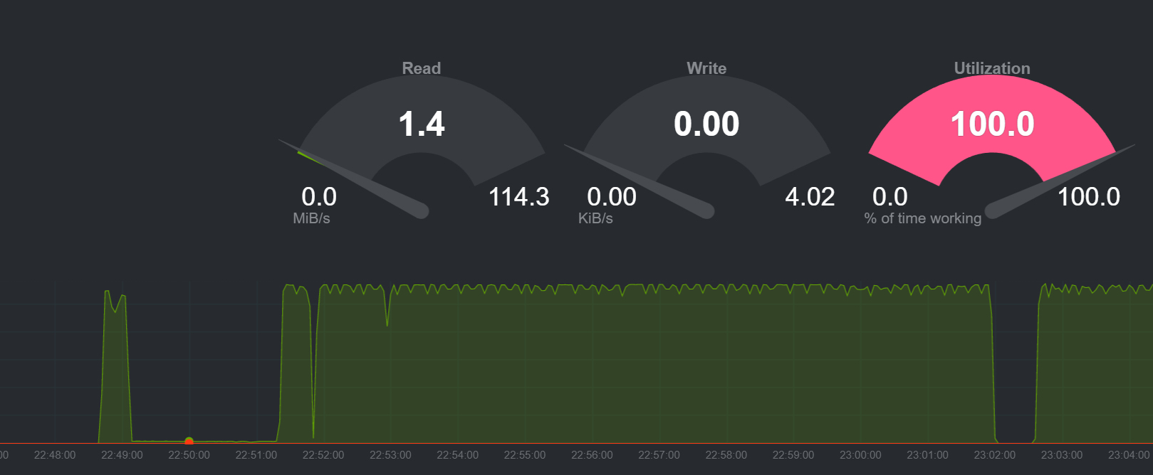

I started running in to issues when playing 4K content from my Plex container, where videos would start to buffer shortly after starting. After installing the Netdata container to monitor the system more closely when the issue occurs, I identified the following:
  • When a large (50+ MiB/s) read starts after the drive has had at least 10 minutes idle (but still spinning), the read will work fine for about 30 seconds, before slowing to 1-2 MiB/s
  • While this is happening, Netdata reports that the disk is 100% busy, and the CPU is 40% utilized with IOWAIT
  • After 1-3 minutes, the read rate returns to normal, and the disk utilization returns to a normal level for the rate of data being read
  • The issue won't occur again until the disk has been left idle for at least 10 minutes
I can reliably reproduce the issue playing content through Plex, and copying large files off an SMB share.
Attached are a screenshot of Netdata showing the disk read rate, on which you can see the long dip at the start while the disk isn't returning data correctly, and a short video I took of the noise the hard drive makes while the issue is occuring.
Could it just be as simple as a bad drive out of the box? And if that's likely, are there any tools I can use to confirm that for an RMA?

Hi JorgeB, I've tried disabling EPC and Low Current Spinup on both HDDs and retested, but it has the same issue. Before testing I confirmed that the drives were spinning, and as before it spent 3.5 minutes clacking away before starting to read successfully.
I also ran a full Parity check (which ran without any errors), and noticed that both Ironwolf drives did the same thing at the beginning of the check, before settling down to 200-250MB/s read rate and running uneventfully for the remainder of the 10 hour check.

It does indeed appear to have been a faulty drive. After pulling out the data drive, replacing it with a new Ironwolf drive and doing a data rebuild, the new drive is behaving just fine, even with the energy saving features turned on. I have to admit I've not seen this as a failure mode before, but given both the parity and data drives are faulty (bought from the same retailer at the same time), I'm guessing it was a bad batch of drives or they got dropped somewhere in the warehouse. Off for warranty replacement they go.
