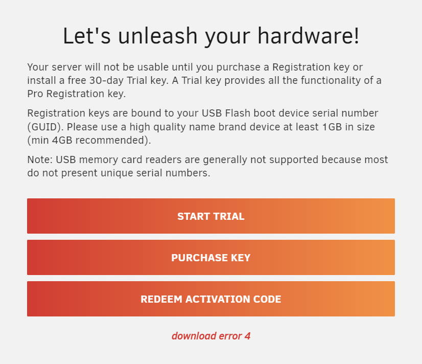

I booted Unraid for the first time and tried to start my free trail from the gui, but got an error. (Screenshot attached)

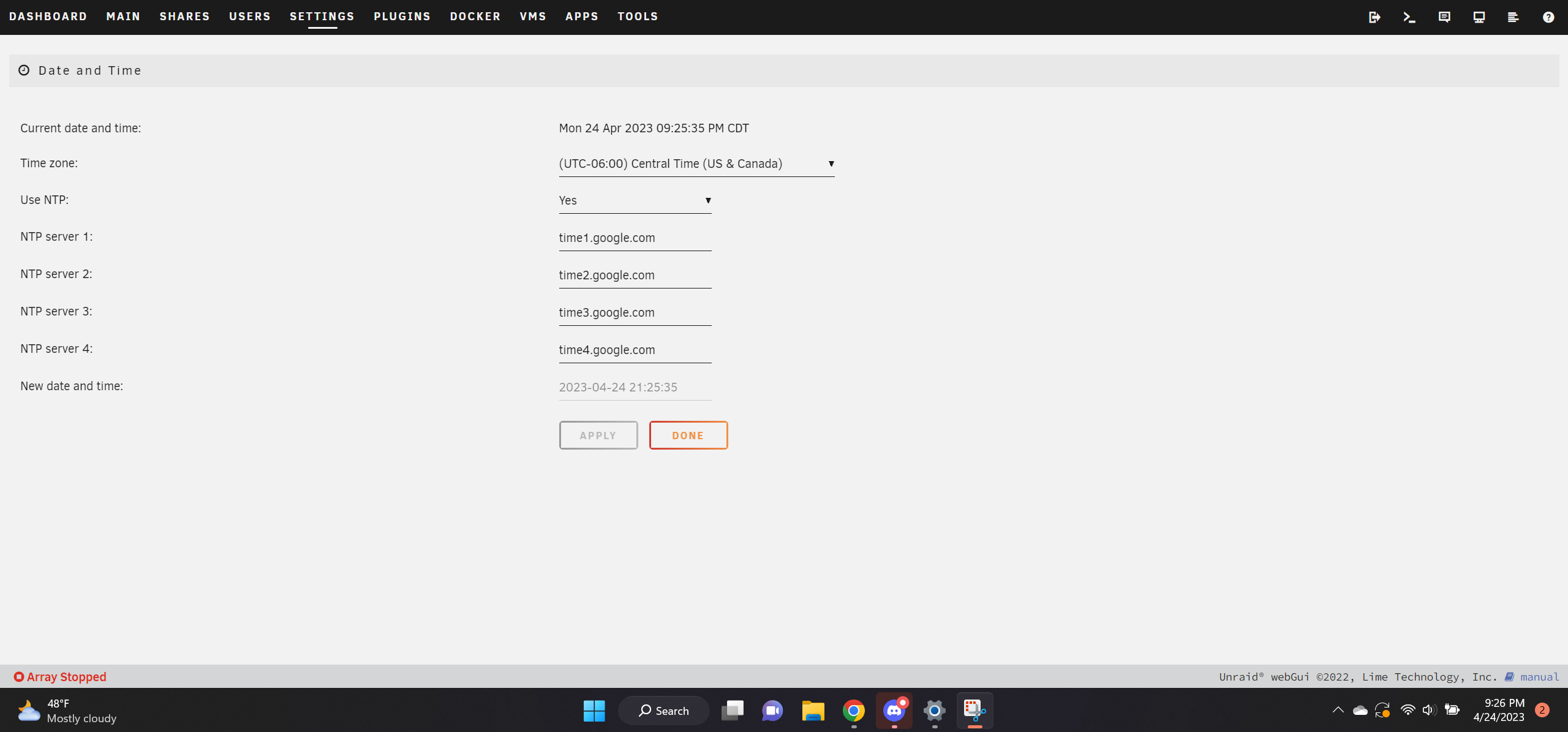

I searched for previous threads with this issue, the most common reply was the check Date and Time. I updated the date and time under the tools tab, but this didn't fix the issue. (Screenshot attached)
My server is connected to my network and has internet access. (Pinged Unraid server from another device on my network)
Any suggestions to solve this issue?

Try setting static DNS addresses in Settings - Network Settings.  Set up #1 and #2 and 208.67.222.222 and 208.67.220.220 (openDNS)
That worked, thank you!
