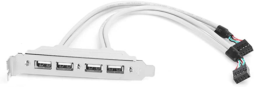

Or this cable, which I use in both of my servers.  I prefer the cable to the adapter, as it allow you to locate the flash in a spot out of the way and not likely to get bumped if you need to go into the case.
I prefer the cables that are meant to be put in a rear slot, I screw it inside the case instead, bending the bracket to fit if needed.
Guess that's okay if you have a place to secure it, out of the way of it impeding airflow.  And I would want that to be secure, as the metal bracket falling on electronics would not be ideal.  I find the cable with rubberized cover around the Type-A connector more versatile.  A zip tie or two can secure it where you want, out of the way.  If your server behaves, you shouldn't need to unplug it for years.
I bend the tab at the top straight, then screw it down to one of the slot cover screws. It sticks out over the motherboard, typically at the very bottom or side of the case. Very secure.
