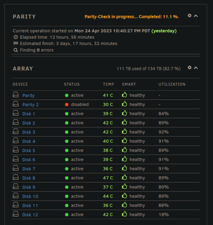

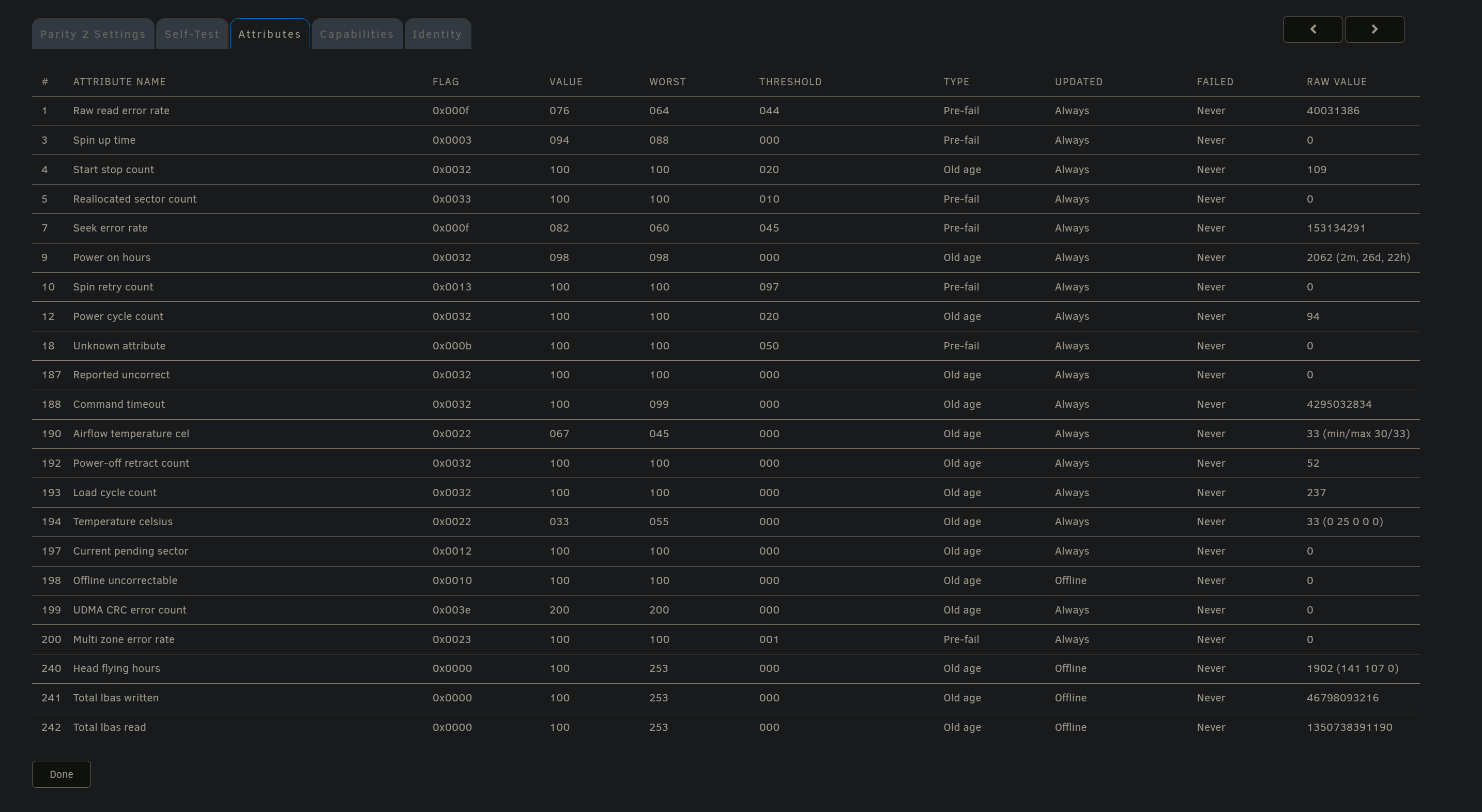

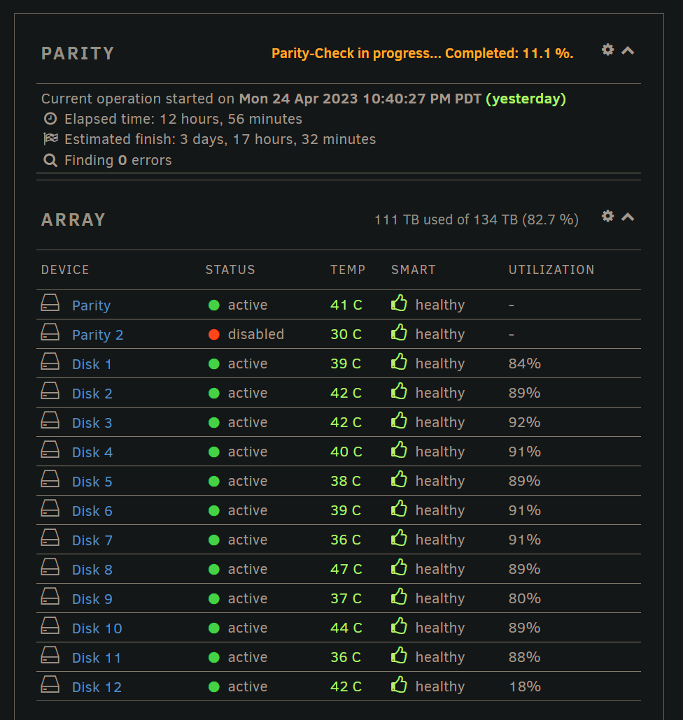

One of my Parity drives keeps showing up as disabled.

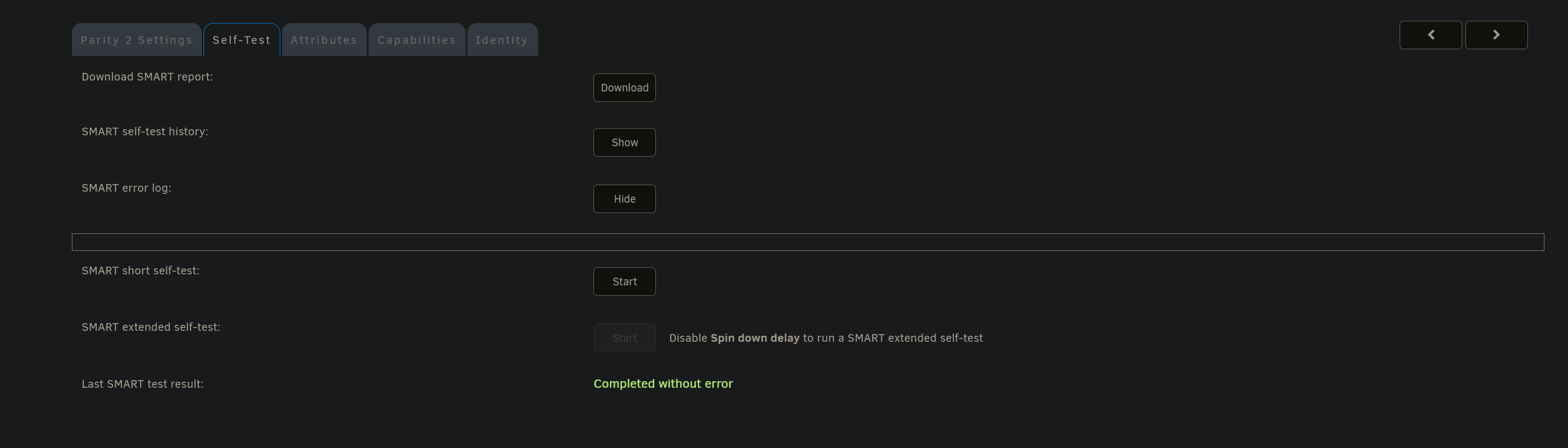

I replaced the SATA and power cables three times. I also swapped out the PCIe adapter that has the SATA connections.
The tests come back as good but I have no idea why the drive keeps getting disabled.
Any help is appreciated.

What do you mean the issue is the same? Parity2 was already disabled at array start, if you attempted a rebuild and it failed we need those diags.
P.S. the unassigned Seagate 12TB disk appears to be failed, so you should remove it.

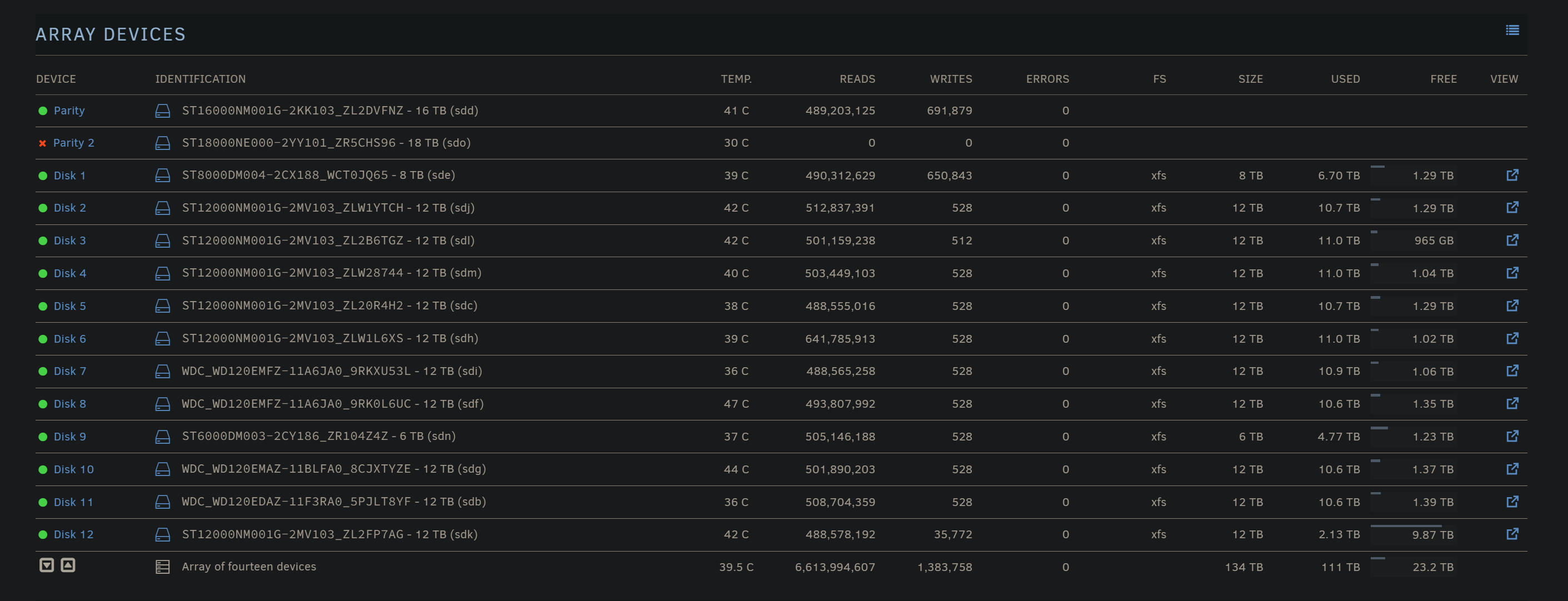

I removed the drive from the array and added it again. the Parity sync started (albeit at a super slow pace (100kb/sec average) but now the docker and vm will not launch.
I even stopped the sync removed the drive and started the array again but those services wont start.
tower-diagnostics-20230504-0845.zip
You are having issues with multiple disks across multiple controllers, so possible power/connection issues.

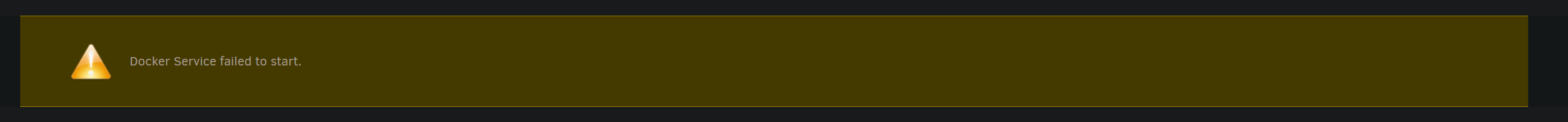

Sadly I am still now stuck in the situation of nothing loading. The Array says it is working but docker, vms and shares don't run.

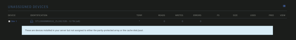

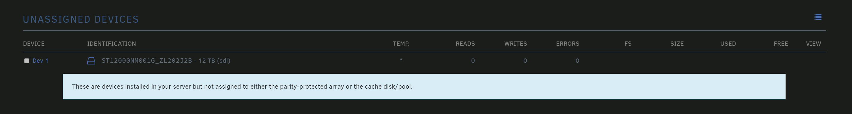

Disconnect this unassigned disk which is causing a lot of errors:
May  4 12:06:17 Tower  emhttpd: ST12000NM001G_ZL202J2B (sdl) 512 23437770752
And check filesystem on disk1.
Still didn't do this, this disk is spamming the log with disk errors, making checking the log more difficult.

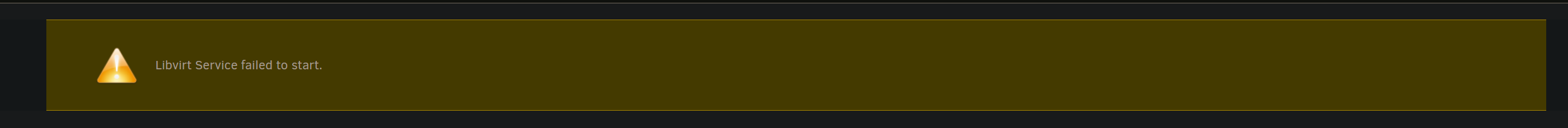

Libvirt start and it image is not new, are the VMs still missing?

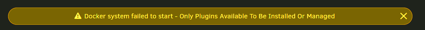

Docker images started but it's new, see here to recreate:
https://forums.unraid.net/topic/57181-docker-faq/?do=findComment&comment=564309
That drive is not attached to anything. I need to locate it and remove it but its not part of the array.

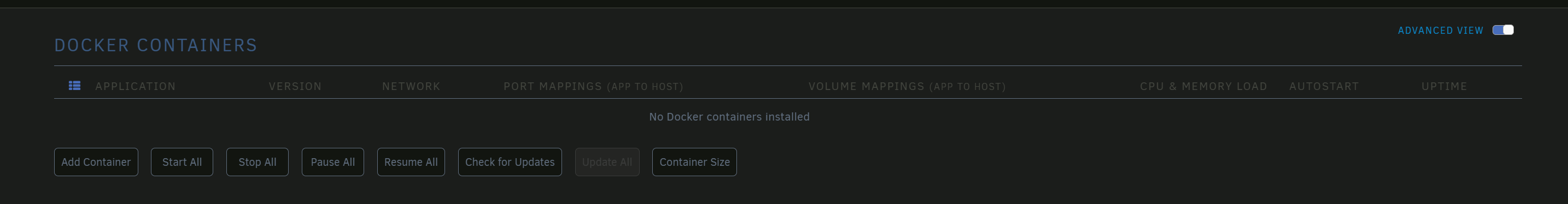

VM now shows up but dockers show as empty.

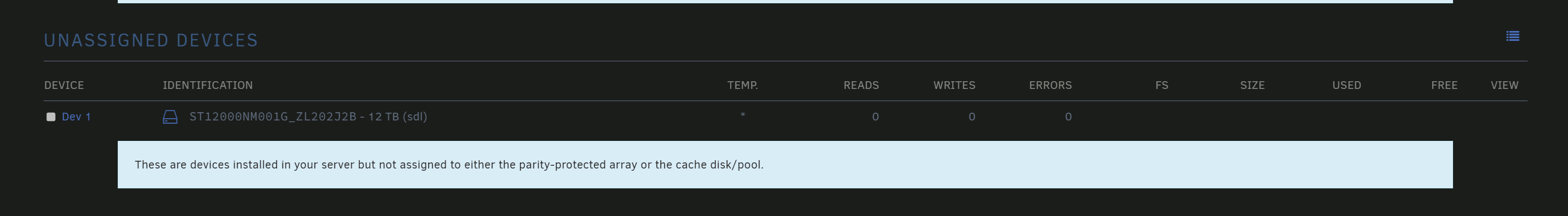

That drive is unassigned. I need to find it and remove it but I have not done that yet.
Doing the steps here is to create the docker img from scratch. Is there a way I can recover all the dockers?
Read the entry, you can recover all the containers, assuming appdata is still there.
