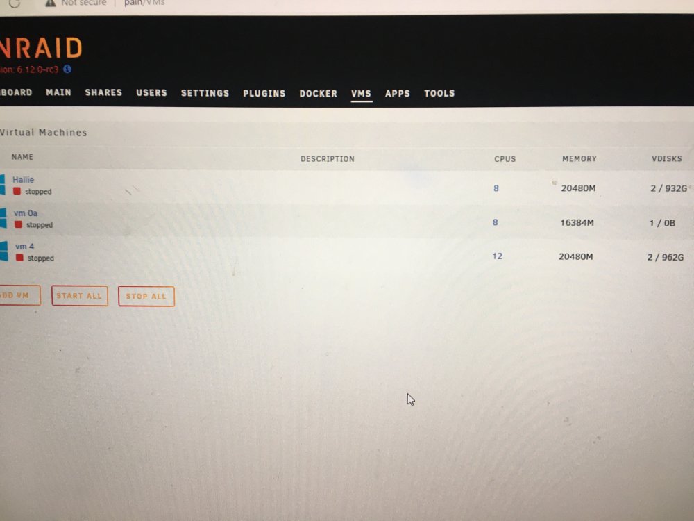

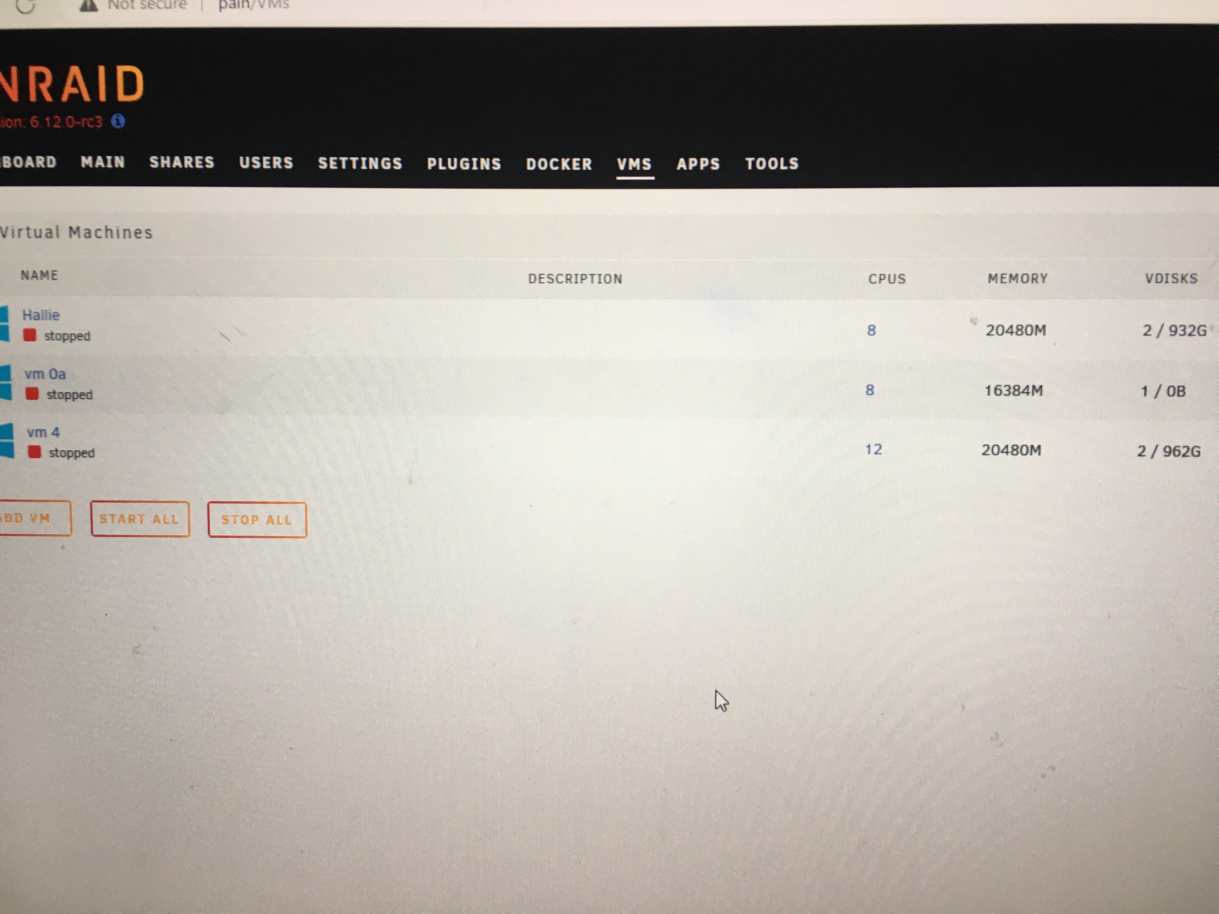

all 3 vms i have aren't recognizing drives properly they say
A -2/932 gb
B -1/0B
C -2/962 gb
they have
A -480gb SSD + 1 TB HDD
B -1TB HDD
C -480gb SSD + 1 TB HDD
I don't know what you mean, I though this post was about a couple of array disks not mounting, please explain the current problem in detail.
the problem is my vms stopped recognizing some of the drives assigned to them and wont boot now because of this

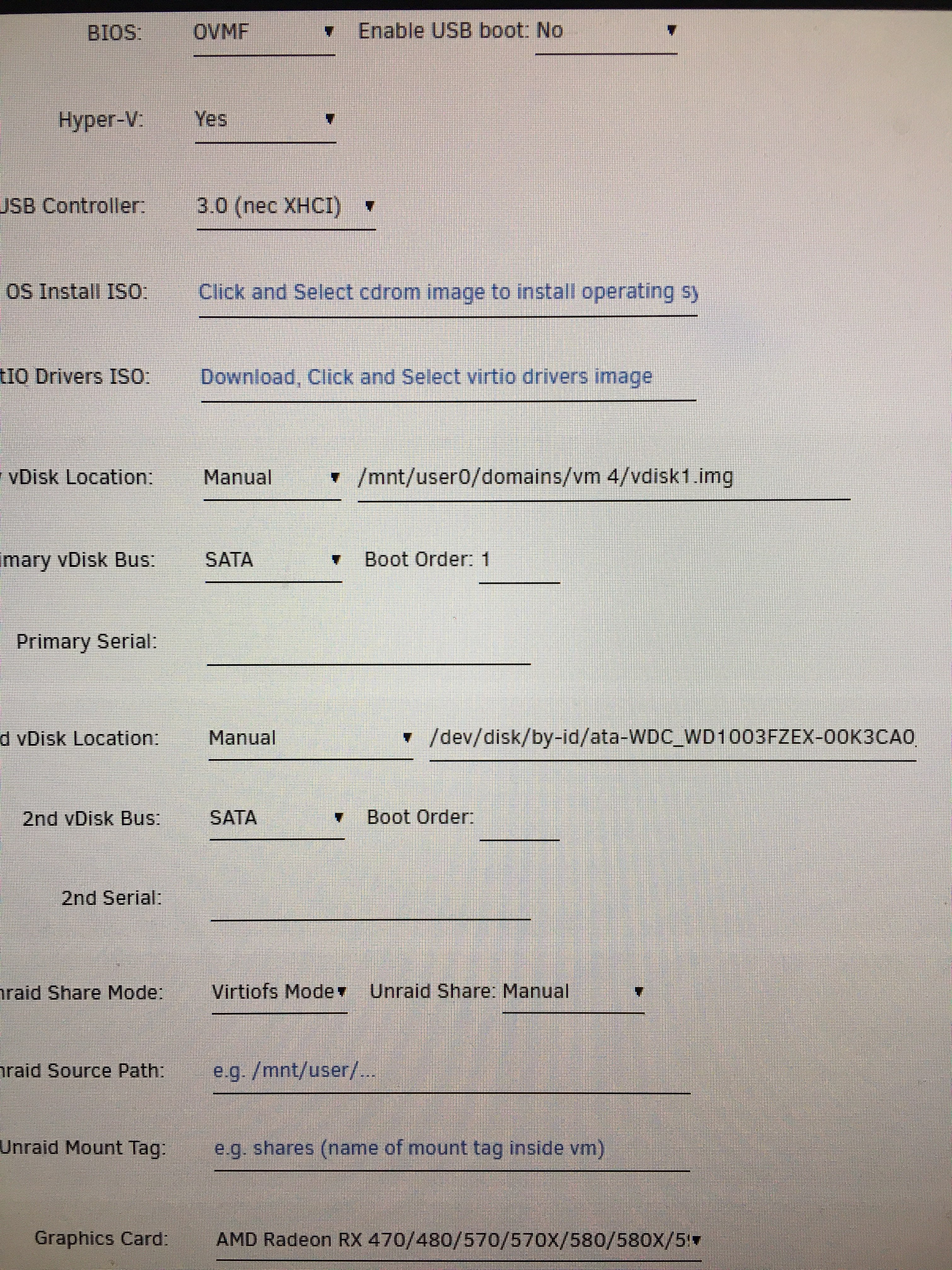

Post a screenshot for the 'form view' for one of the VMs, and I still don't understand why you had NTFS disks assigned to the array.
they were set to auto and would go into NTFS and when i made them XFS instead the issue still persisted
If you want to pass-through complete disks to a VM do not assign them to the array (or pool) like they were, just leave them unassigned.
