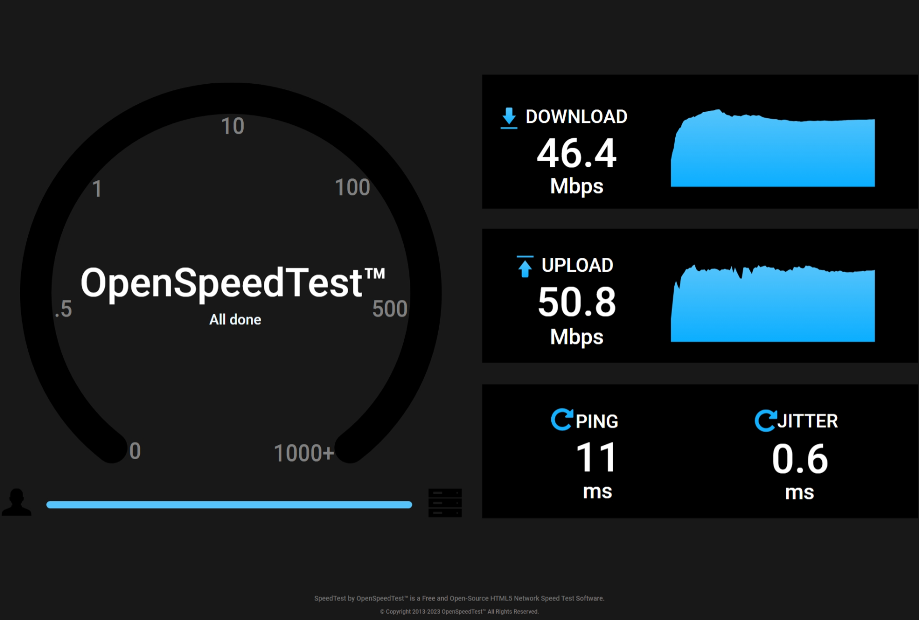

Connection from Laptop:
Wifi at my Desk: (My AP's are NOT nearby)
SSID:        Paradise
Protocol:        Wi-Fi 6 (802.11ax)
Security type:        WPA2-Personal
Network band:        2.4 GHz
Network channel:        11
Link speed (Receive/Transmit):        86/155 (Mbps)
IPv4 address:        10.40.70.192
IPv4 DNS servers:        10.40.70.1
Manufacturer:        Intel Corporation
Description:        Intel(R) Wi-Fi 6 AX200 160MHz
Driver version:        22.200.0.6
Physical address (MAC):        78-2B-46-C7-0D-21

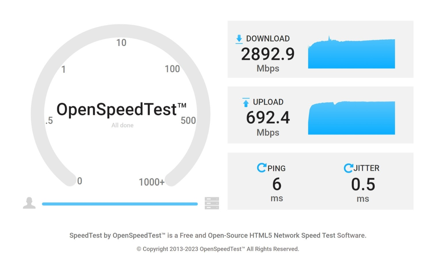

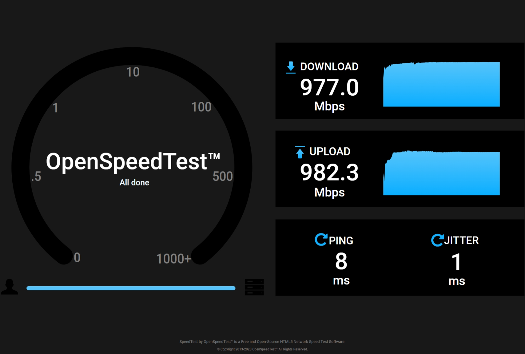

Cabled at my Desk:

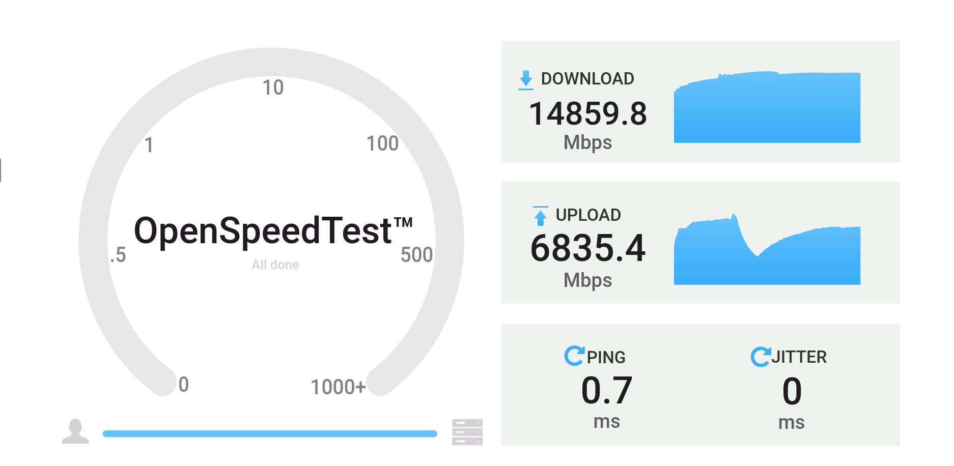

Connection from Chrome Docker:
What the Hell?

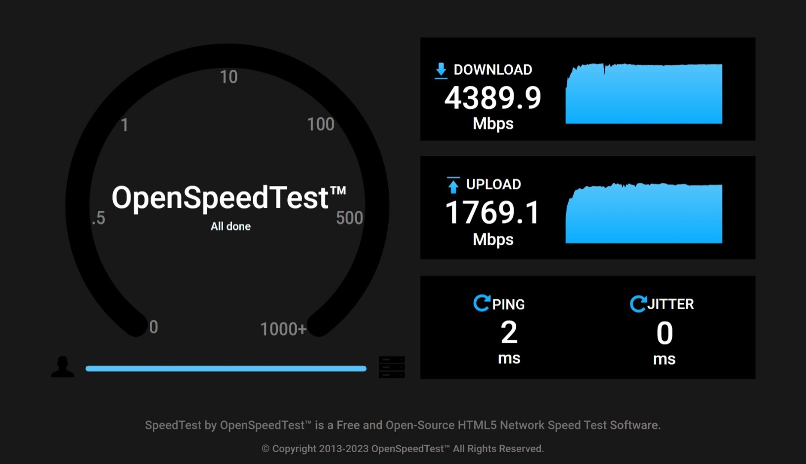

Connection from VM (Goat):
Connection from Gaming VM:
