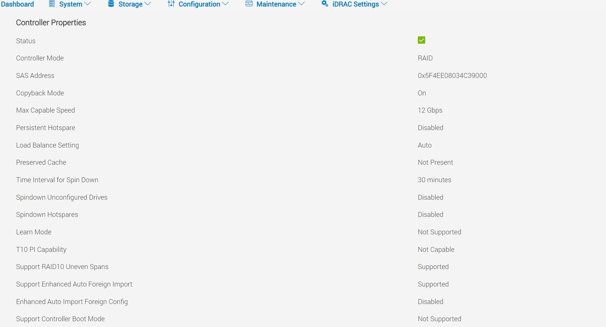

I have a Dell T350 with a controller PERC H345 Adapter.
I dont use the RAID function but i can see in the Idrac settings it is enabled
What will you recommend to do?

Most RAID controllers don't support spin down, you'd need a true HBA.
