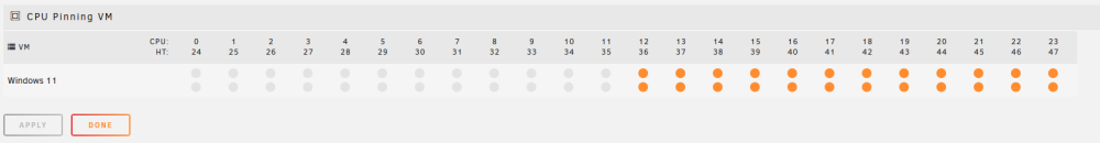

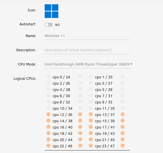

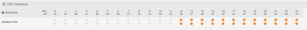

Under general use (primarily programming, webseaching and gaming) there is an intermittent lag/hitch that makes the experience of running the VM a little "jank". Attached is the latency-mon report which shows as soon as it starts it says it has difficulty handling real-time audio due to dxgkrnl.sys and msmpeng.exe (which I know is windows security). Unsure how to proceed as most dxgkrnl.sys latency issues mentioned on the web says it's a RAM issue but tested all the RAM sticks independetly and together shows no errors. Running out of ideas. (Maybe it's the AMD Windows 11 jitter issue? Didn't experience when I had it booting straight to windows)
Hardware:
Processor: AMD Threadripper 3960X 24-Core CPU
    Processor Note: VM has the same pinned cores isolated (See CPU isolation/pinning images)
