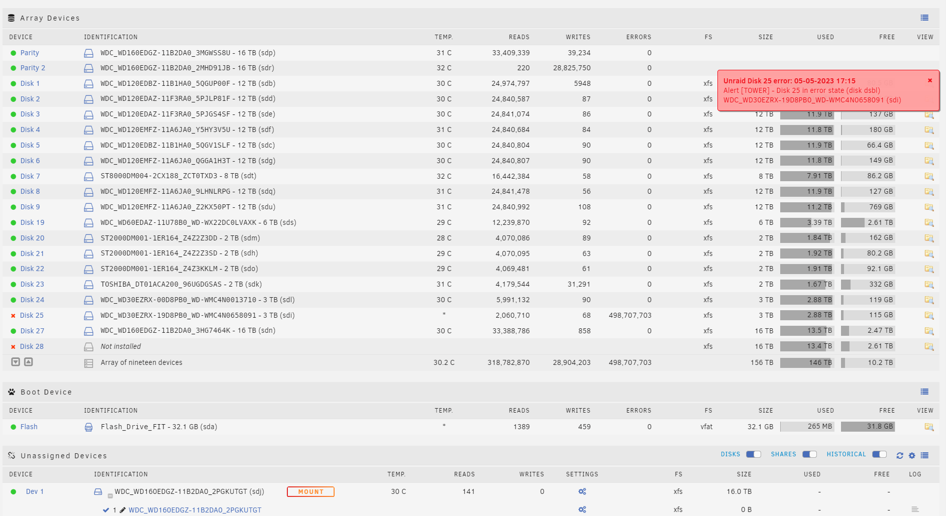

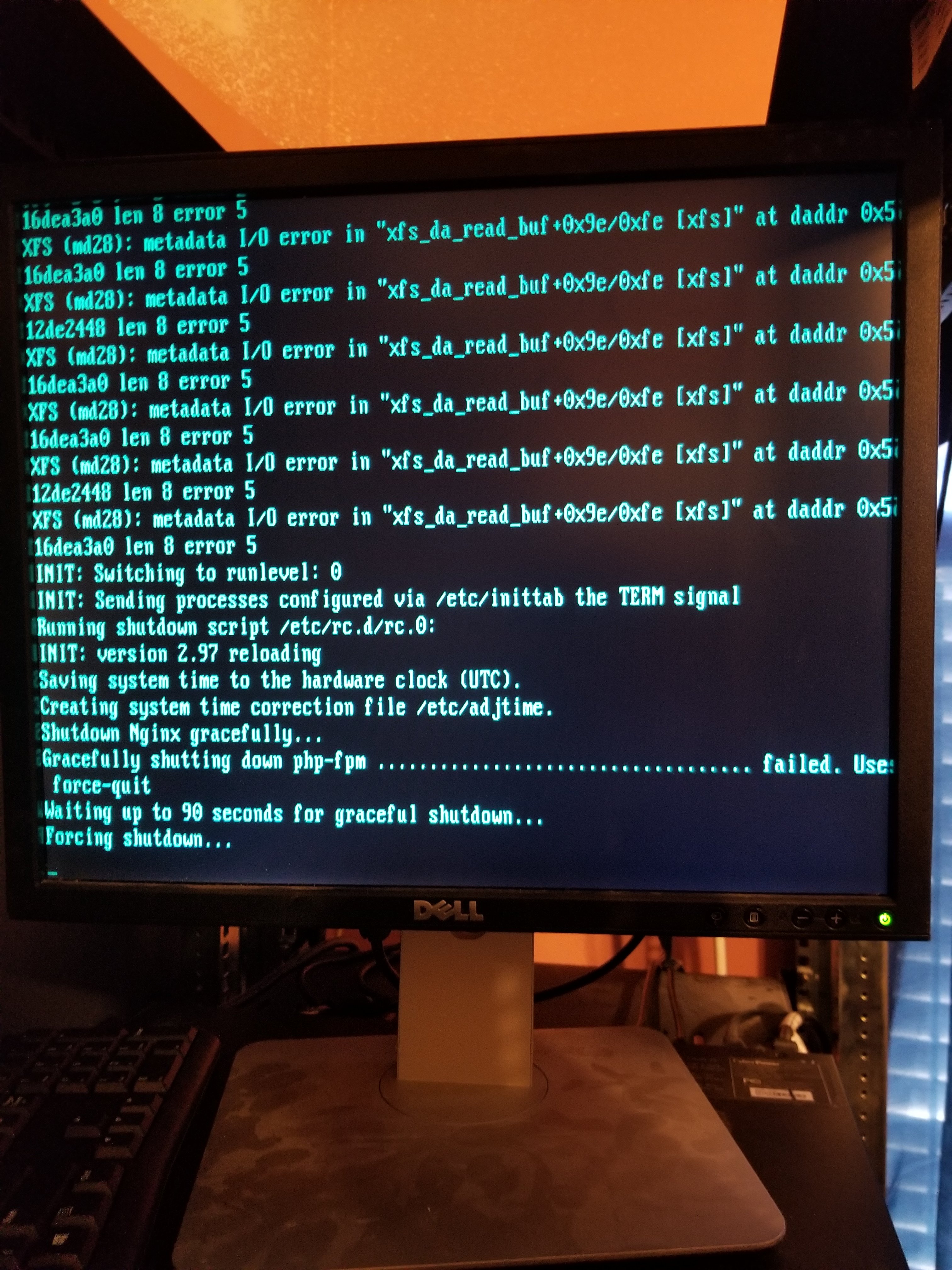

so I was able to get the unraid to boot back up but this time the two drives that were disabled were no longer showing up as even plugged in so I attempted to do as you said and shut it down and check the power and cables but upon trying to shut down it froze and wouldn't go any further. I let it run for around 6 hours as not wanting to interrupt it with another unclean shut down but to no avail, the hard drives stayed spun up the entire time and the cpu bounced back and forth from 60 to 80 percent usage, I eventually went over and hit the power button and watched as the system tried a forced shut down, another hour later and it still had failed to shut down so I held the button until it finally shut down. I know I know, this probably made this even worse, though I felt like there wasn't much choice at this point at it was no longer responding to any input and was simply spin its wheels at full speed most likely causing damage in its own right. I have the logs from before I tried to shut down and during the shut down when it was still responsive, as well as a picture of the screen as it tried to forcibly shut down. I fear the worse with this atm but trying to stay hopefully. any help would be greatly appreciated.

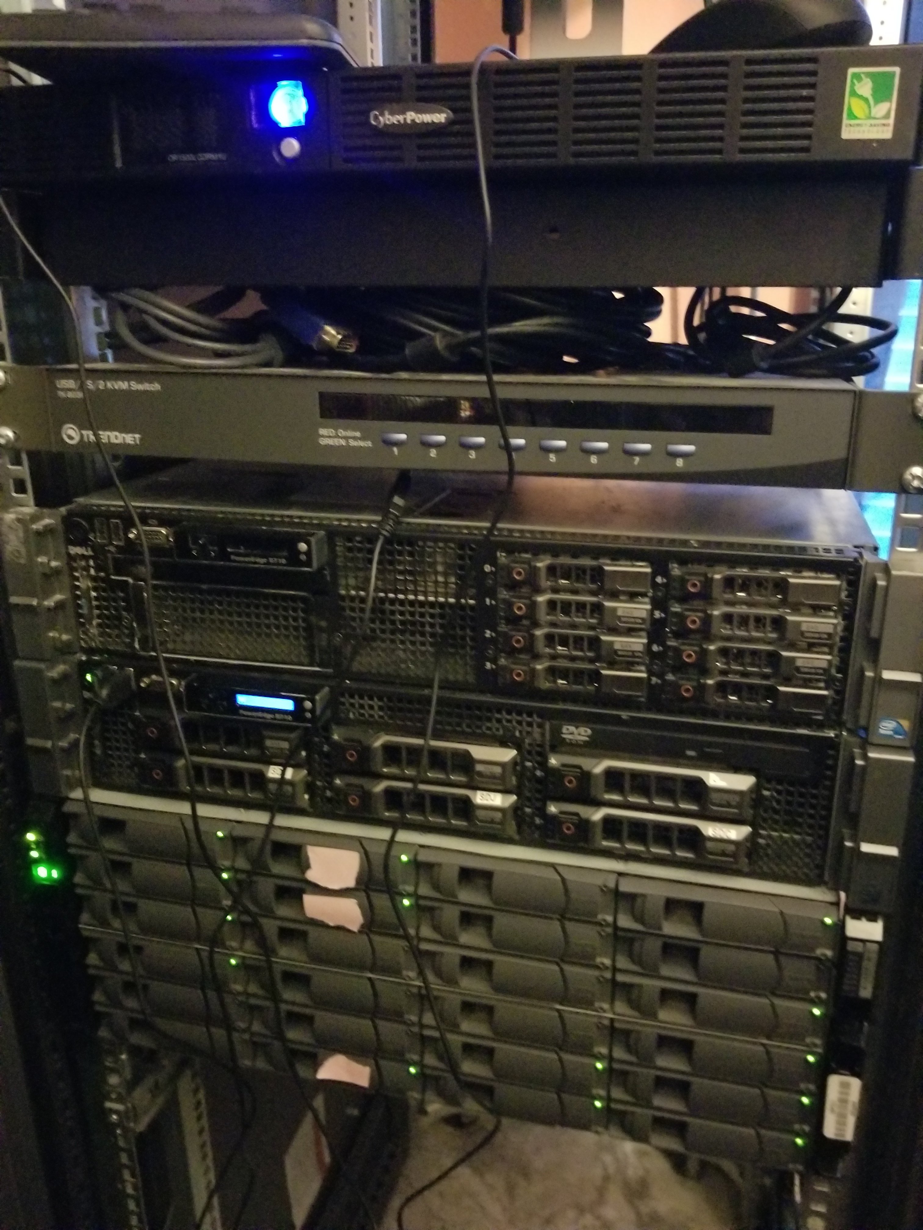

my system consist of a dellr710, net app ds4246, and Cyberpower ups
tower-diagnostics-20230430-0419.zip tower-diagnostics-20230430-1005.zip

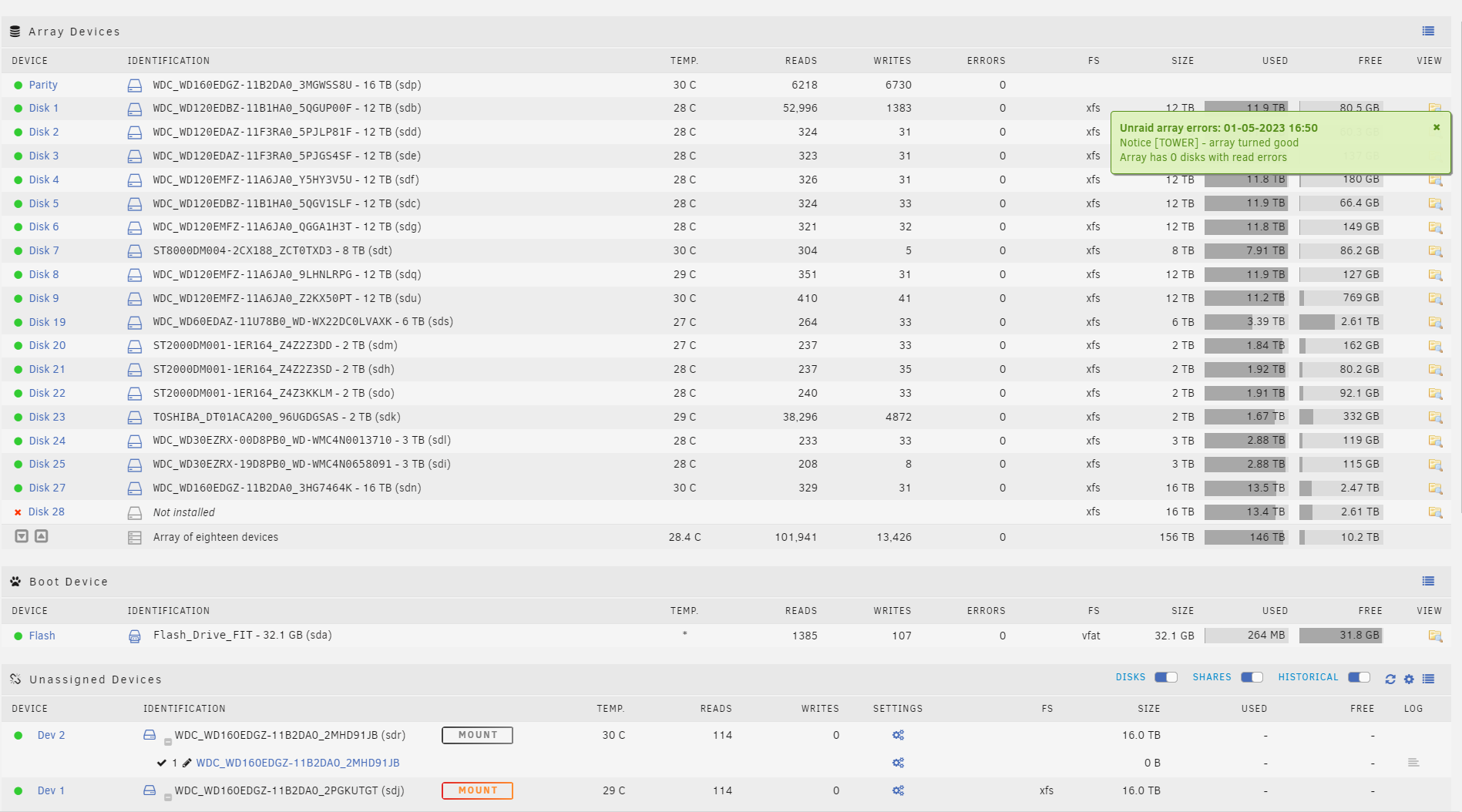

The screenshot shows that you need to check filesystem on disk28, but before that post new diags after a fresh boot and array start.

sorry it took so long, I spent most the night checking the connection and making sure the nic card didn't come unseated as I read on another forum that was a known issue, I didn't have any spare power supply's but I did switch them out with another dell r710 I have running and it seems they are good. I took a diag but am hestiant to shut the server down again and try to rebuild to two drives it dropped till I hear back from you so will just let it run for a bit and see how it goes till then.

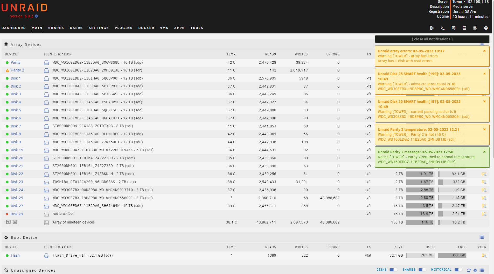

just noticed the insane amount of errors as well
Looks like emulated disk28 is mounted now. I assume (hope) that parity check was non-correcting. Is disk28 one of those unassigned? Which one? And the other was parity2?
SMART report for both looks OK though neither have had any self-tests.
Somewhat safer to rebuild to a spare if you have one and keep the original as is.

Im not 100% sure which one of the unmounted was the disk 28, and yes the other was the parity2 drive, unfortunately I don't have any spare drives of equal size but if you think it would be better to wait to rebuild, I will order one as I don't have any backups to the data on the unraid to answer your other question. Lots of family videos and pictures that aren't replaceable but I understand when it comes to computers some things cant be avoided. Should I run a self test on the drives?
oh I just noticed one of the unmounted drives is marked xfs and one is not, just like all the drives above except the parity drives so this may help tell them apart as well as one can be mounted and one can not be so looks like the drive 11b2dao 2mhd91jb is the parity one

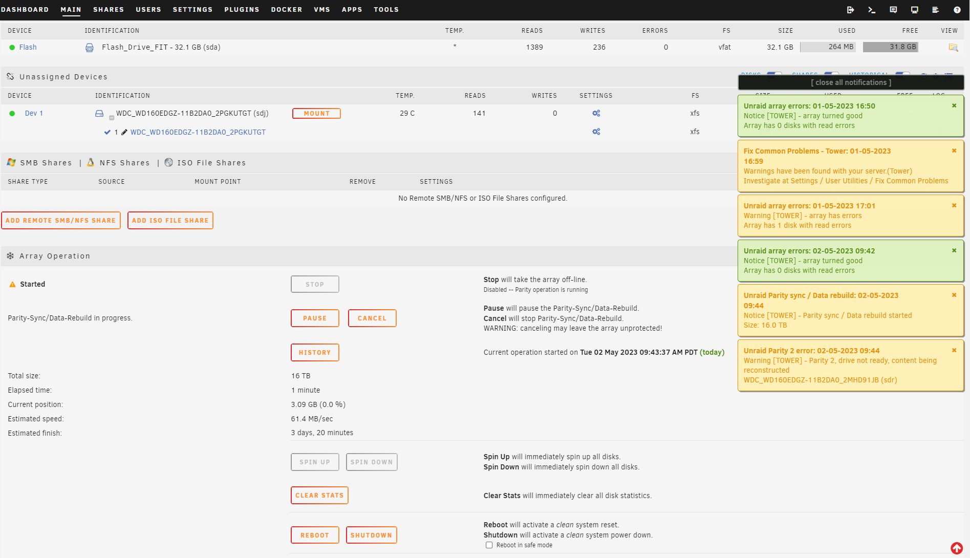

You should post new diagnostics so we can check how parity2 rebuild is going
also looks like disk 25 is having the same issues as before with bad sectors, and the udma crc count going up so I ordered a second hard drive to replace that one as well just in case.
tower-diagnostics-20230502-1457.zip
Disk 25 dropped offline, looks more like a power/connection issue but since it dropped there's no SMART.

my system consist of a dellr710, net app ds4246, and Cyberpower ups, The net app has a capacity of 24 drives plus the 6 the dell r710 has, they are attached via a sfp cable. I'm only using about half the available slots though of the netapp at the moment. they have a sata backplane 3.5 hard drive enclosure on the netapp. I ordered two more power supplies to this netapp as it original only came with 2 and had space for four. I'm not sure if this will make any difference but since power or cabling could be the problem I figured it was worth a try. the hard drives and pdus don't get here till Monday and the parity is still finishing so till then I'm left hoping. oh I linked a picture of my setup above, I do apologize for the messy cable management ahead of time.

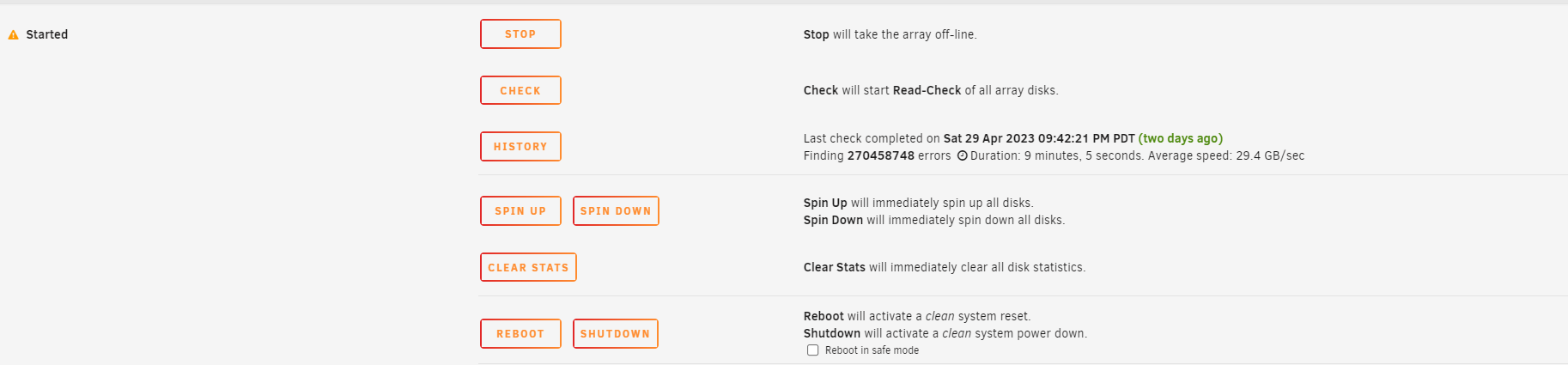

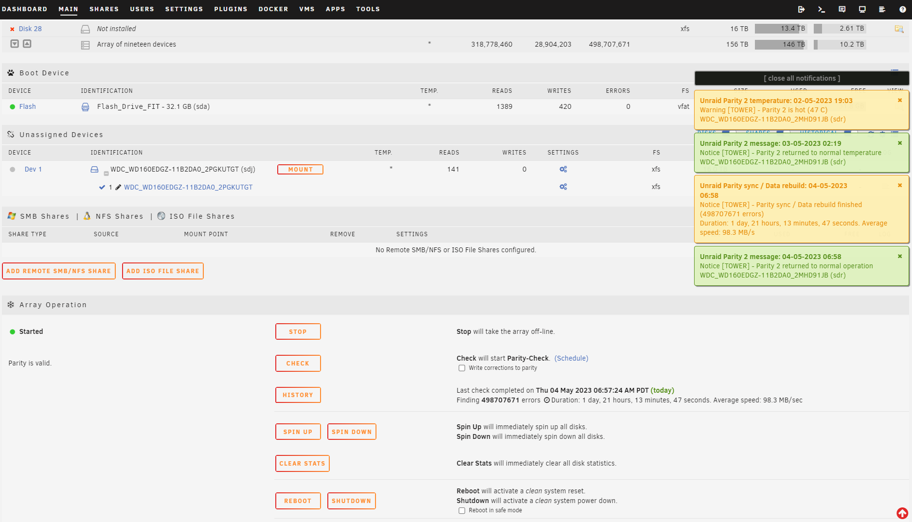

Just got home from work and the parity rebuild had finished, so I took a snip of the screen to ask about the insane amount of errors it found and what I could do to fix this problem since it seems to be persisting, and ran a diagnostic of the system, when the diag was done I switch back to the main menu to find that disk 25 had dropped again and become unmounted for the like 7th time now, but the parity is fine for the moment. I ran another diag after the disk dropped so they both will be down below as well as the screen shots. I am at a lose as what to do next. I have the replacement drives still on the way and the pdu's as well even though you said its doubtful they will be needed they were relatively cheap. any help would be appreciated, as I feel like I'm going in circles here and at any moment I could lose it all.
