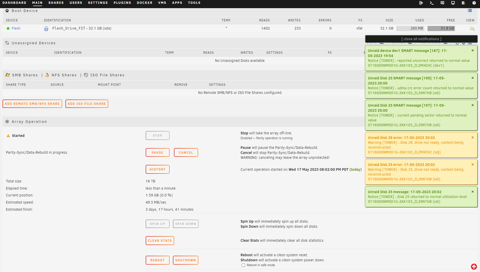

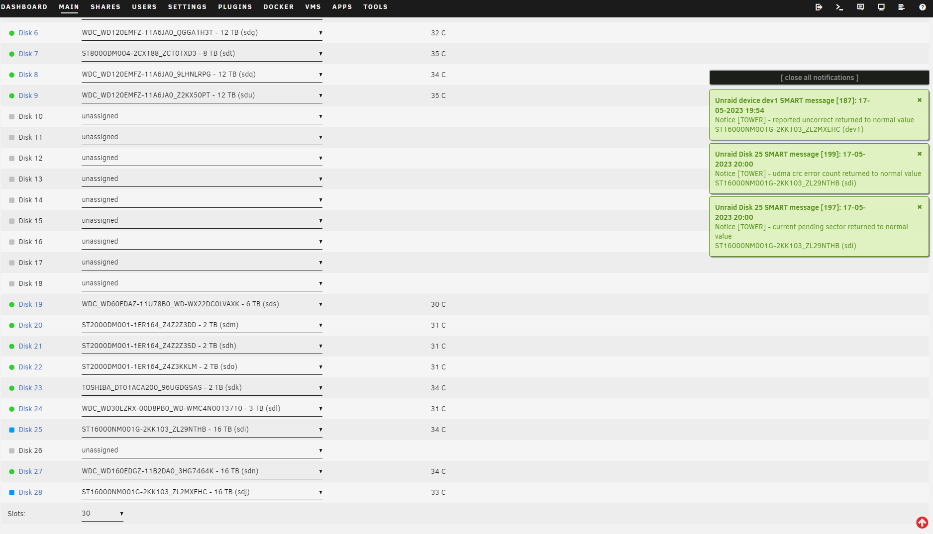

Sorry for the delay in posting, had to wait for all the items to come in. I got two new power supplies and the two new hard drives, I replace the ones having the issues and they are now rebuilding. I haven't replaced any of the internal cables but did come across another used disk shelf for a low price so grabbed that one and if things don't work this time I can either cannibalize that one or if it would work simply transfer all the disk over to the new one and boot it up (not sure if unraid would have a problem with the new hardware even if the disk are all in the same location??) Post the diag before the rebuild and after as well as screen shots.
tower-diagnostics-20230517-2156.zip tower-diagnostics-20230517-2205.zip
Everything looks good so far.
