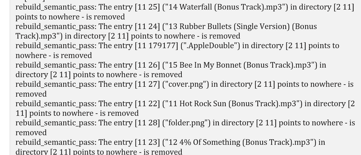

On log from repairing disk 1 i get some entries like this
So I guess these file have gone and will need replacing?

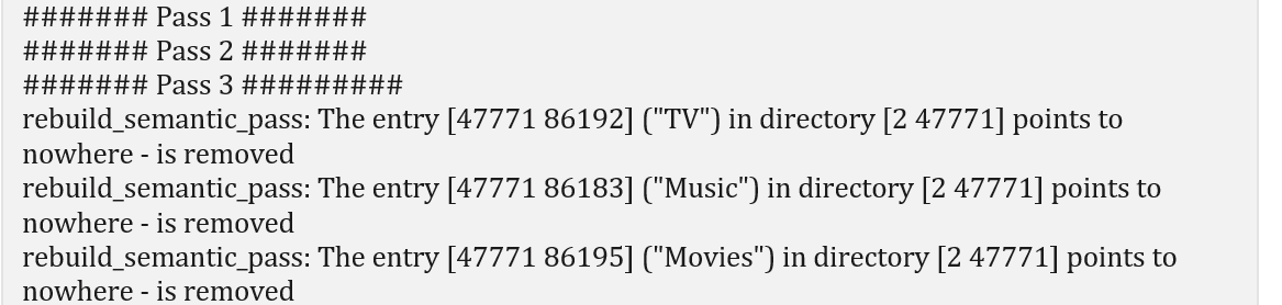

Also shows this:
These are some of my shares and I'm wondering if I need to be trying to fix this before putting in new disk 8 and rebuilding or should just go ahead and rebuild a new disk 8.
