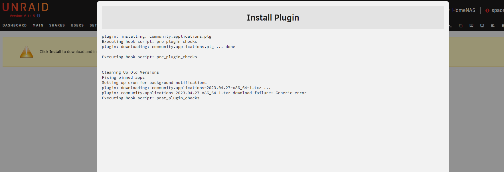

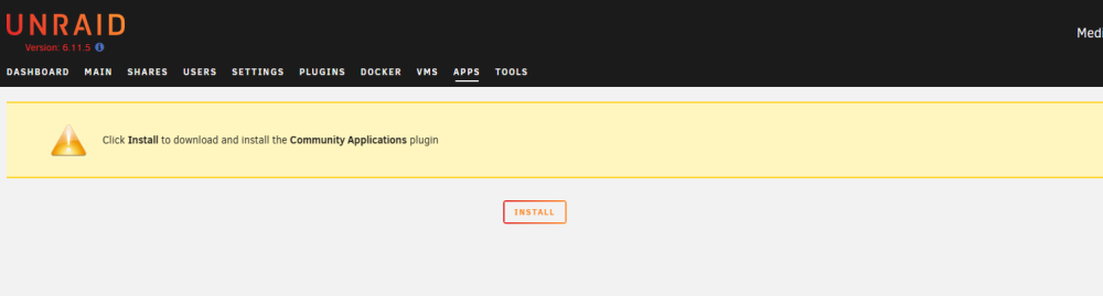

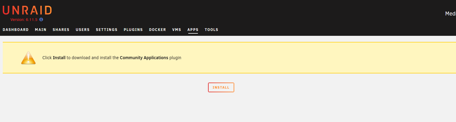

May 3, 20233 yr Hello, I am running unraid for a few year and has working community plugin. However, one day, when i login to check my server, i realised that it as me to install "community plugin" again. ( as shown below ) and upon pressing "install" , i receive another error " generic error" May i know what is wrong with my server? I have attached a copy of "diagnostic " report homenas-diagnostics-20230503-1046.zip
May 3, 20233 yr Community Expert Solution The syslog in those diagnostics show problems with the flash drive. I would suggest you put it in a PC/Mac to check it can be read correctly. It may be failing, so do you have a. backup taken since you last made any configuration changes?
