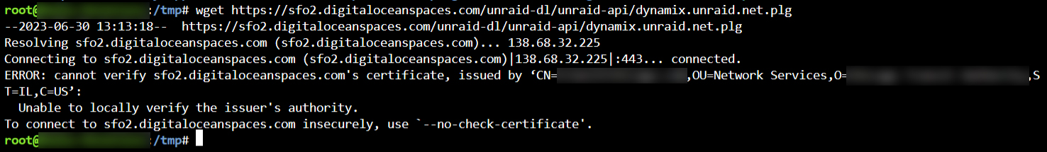

I'm still struggling with this issue. It's weird because I can install NEW dockers or plugins, I just can't check/install updates. I ran wget in the terminal and it won't download the file but does give me the option to connect insecurely. I don't know how - or if it's even possible - to do this via the GUI. Any ideas?

What is the part you blanked out? The correct CN should be:
   CN=*.sfo2.digitaloceanspaces.com,O=DigitalOcean\\, LLC,L=New York,ST=New York,C=US
If a different CN is listed then someone is trying to do a man-in-the-middle attack on you. I would talk to your IT department as something doesn't seem to be setup correctly on the network.

It was showing our companies domain name, so I assumed it was their cert. I'm not well versed in how certificates work. Strange, though, I can install dockers and plugins initially but not their updates.
I should add they use zscaler which, even on the desktops our IT department setup and control, can be a huge pain the butt.
