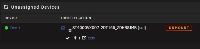

How is /mnt/disks/cctv mounted? How are you sharing it from /mnt/user?
Edited by apandey
See the screenshot.  its showing up as /mnt/disks/cctv
Edited by tvd1

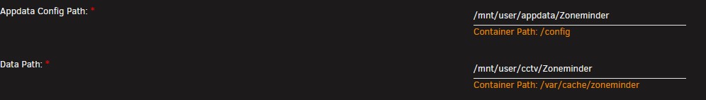

Do you have something configured to write to /mnt/user/cctv ?
From your comment above I would have expected Zoneminder to be configured to use /mnt/disks/cctv which is the UD drive - is this the case?
No i have it set up like this..

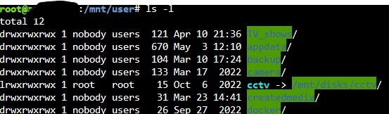

Is /mnt/user/cctv linked to /mnt/disks/cctv in any way? If yes, how?
That symlink is the problem. /mnt/user needs to be fully managed by unraid, and the errors are because it is encountering a symlink which is not a shfs mount. Trying to get status of that share in expected way is failing
If you want this shared, use the unassigned devices share functionality (it won't be listed under shares) or manually configure smb-extras in samba settings

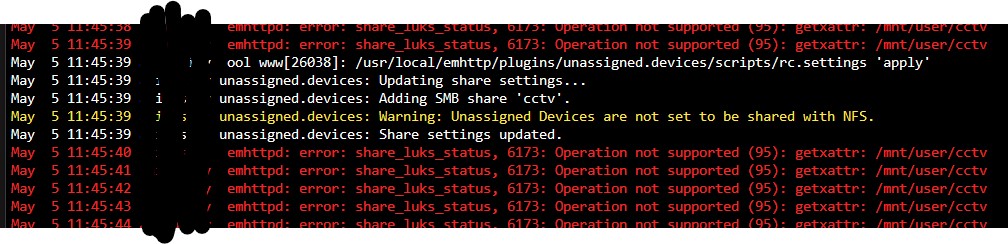

Okay i did that but it had no affect.  I'll have to post over there to see exactly what i should be doing, because i think i've checked everything, short of adding code to smb-extras.
Edited by tvd1
Something external is still using /mnt/user, that needs to be used by Unraid only.
