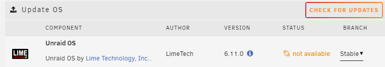

Hi folks,
I've been running 6.11.0 for a bit, and I know 6.11.5 is out, but when I go to the update page, it just says "not available" -- I'm also unable to install the Community Apps plugin. I'm not seeing any errors in the console.
Clicking "check for updates" just does "checking" for a while before saying "checking finished" with no indications it actually did anything.
Anyone run into this before? Any time I tried Googling "unRAID update not available", I got links to people having Docker apps give them this message [and I'm currently not running anything in Docker]

A bit of an update, but no progress -- I manually updated to 6.11.5, but the issue persists. I also realized that the time was wrong on the server; I thought it might have been an issue with the default NTP servers, so I tried putting in alternates from nist.gov, and it fails to update the time from any of their servers. I then decided to make sure I could ping them, but I can't -- "Name or service not known (-2)", and even pinging google.com gives this error. I'm looking into it being some network issue again -- we have been having issues with our domain servers acting strangely, so maybe they're not playing nice with DNS.
After manually updating to 6.12.1, the update function works again!
