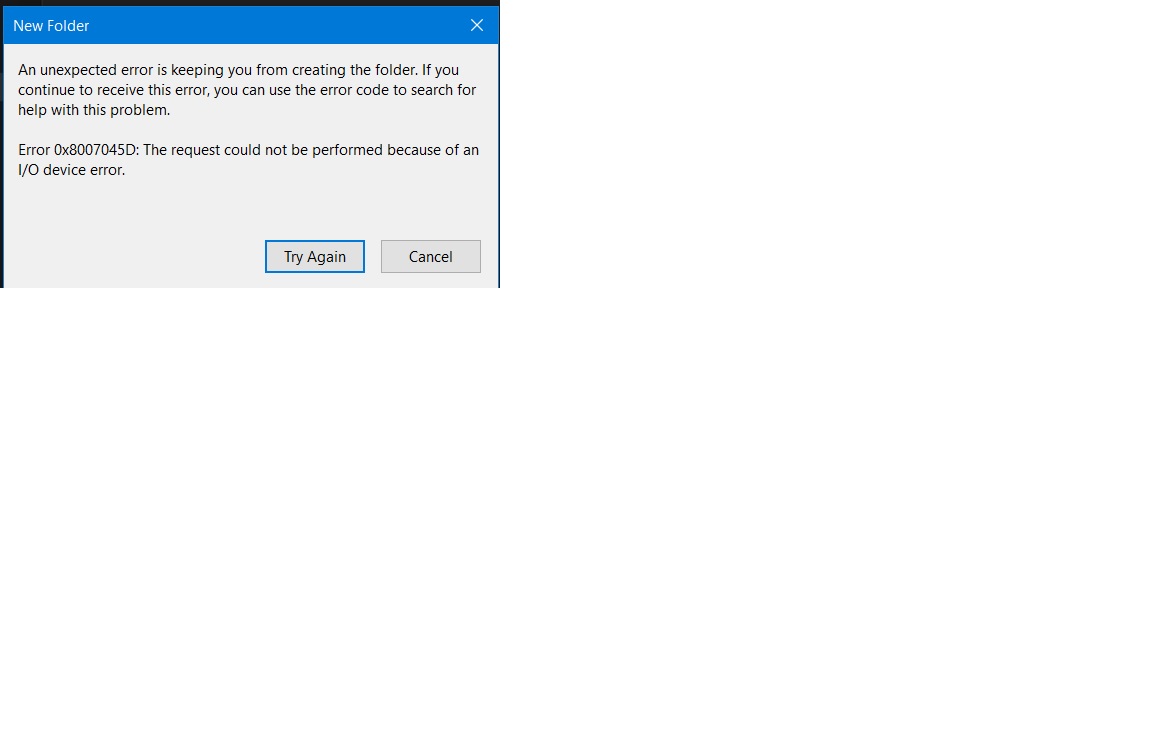

Hi guys,
I'm getting this error message 0x8007045D when I try to create a folder on one (and only one) of my shares.  The complete message is attached.  This only happens on one specific share and not on other shares.  Any suggestions as to why? If more information is needed just name it.
Thanks for your help, tzotz
