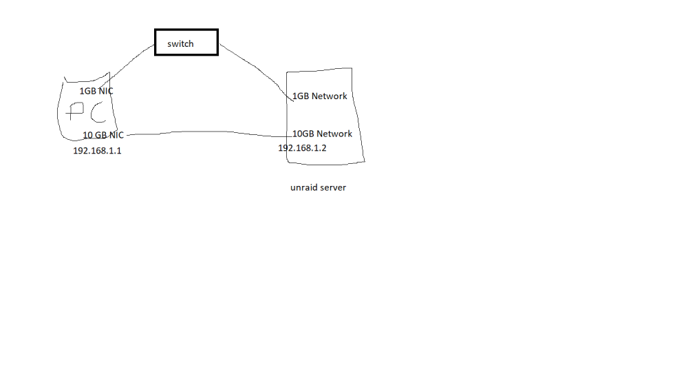

I try to connect PC direct to Unraid Server like this one \\192.168.2\  whe I try to creating a share system ask me about password, I try to use the unraid root user and pw, but dosent work
hope the draw helps
btw, admin connection I use the normal lan IP
thx for helping

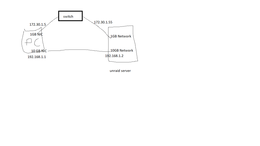

That picture is incomplete as it does not include the IP addresses when going via the router which will be different to those on the direct connection.

good day, hope this is better now

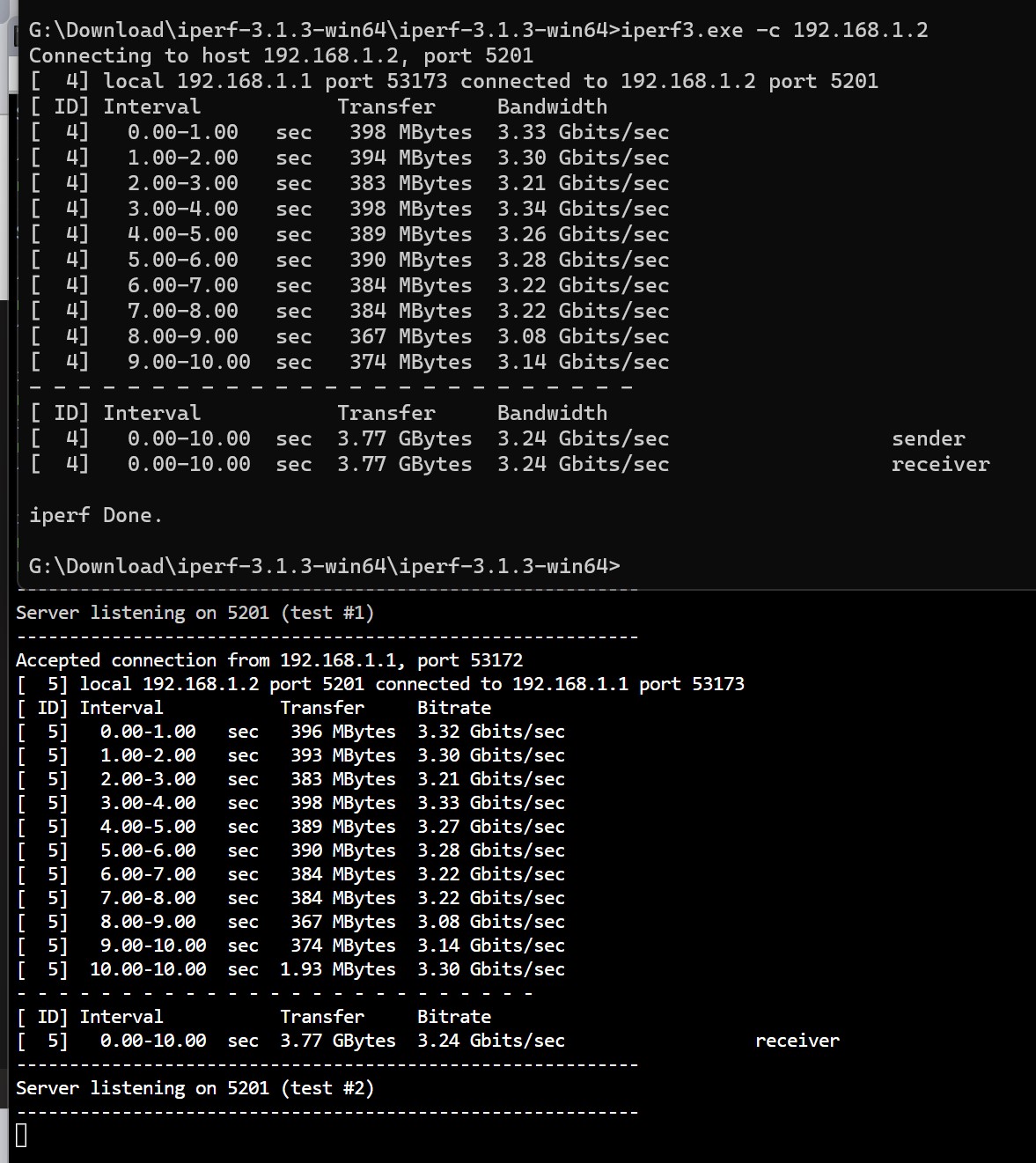

on top is the client and then unraid server
Something seems to be holding it off still. I can get 9+ gbps between a solarflare card on PC connected to a mellanox card on unraid over a DAC

[ ID] Interval           Transfer     Bitrate
[  5]   0.00-10.00  sec  6.39 GBytes  5.49 Gbits/sec                  receiver
looks better
