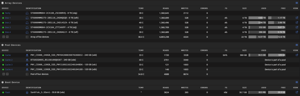

I have a recurring problem with my one of my Unraid server.
every time it does a Parity-Check, at the end or almost the server seems to crash.
No web UI, now answer to a ping and does not appear  on my router.
I tought it was comming from my version and that I was using a old disk as parity. But upgrade and changing the parity disk after it failed didnn't change much.
The only time the Parity-Check work is after a update. or when I changed the parity disk.
Spec
Unraid OS Plus
I5 10400T
16GB DDR4 2400MHZ
MAG B460 TORPEDO
Parity Seagate BarraCuda 8 TB
Seagate BarraCuda 6 TB
Seagate BarraCuda 4 TB
I have logs but can't find what's wrong ...
It seems to have a problem with my drive connections but I ve check them physicaly and nothings wrong.
The problem have impact on the nic, I have logs with the "normal" IP and the configuration IP 169.254.47.25 after fiew hours. I'll past the logs :
syslog when ending the parity check (ip 192.168.1.30)
Please post the diagnostics but looks like you are using a controller with SATA port multipliers, those are not recommended.
Hi thx for the quick answer. I have a PCI card for sata extention indeed.  Any recommendation about that ? I'lve maxed out the mother board sata port.
I've forget about this tool, there is the diag.
storage-diagnostics-20230505-1118.zip
You can use ad-don controllers, but avoid models with a SATA port multiplier like the one you have, see here for some recommendations:
