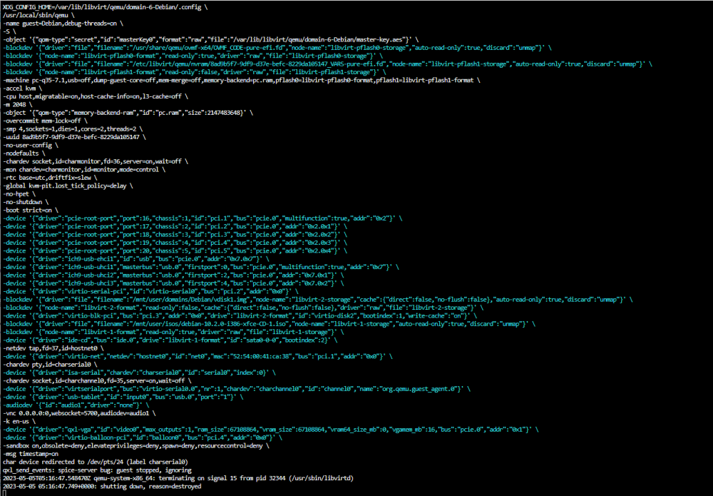

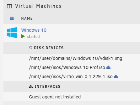

May 4, 20233 yr Hello everyone, I tried to install windows 10 as a VM and I always get the message in the log -> char device redirected to /dev/pts/24 (label charserial0) qxl_send_events: spice-server bug: guest stopped, ignoring Interface: Guest agent is not installed I have now installed two VM's and the error messages were the same. Do you have an idea Thank you
May 4, 20233 yr Community Expert 17 minutes ago, Spanokel said: Hello everyone, I tried to install windows 10 as a VM and I always get the message in the log -> char device redirected to /dev/pts/24 (label charserial0) qxl_send_events: spice-server bug: guest stopped, ignoring Interface: Guest agent is not installed I have now installed two VM's and the error messages were the same. Do you have an idea Thank you Sounds like you have not installed the virtio serial drivers. If you open device manager do you see any devices with error triangles? Also maybe be beacuse guest agent not installed.
May 4, 20233 yr Author 18 minutes ago, SimonF said: Sounds like you have not installed the virtio serial drivers. If you open device manager do you see any devices with error triangles? Also maybe be beacuse guest agent not installed. very stupid question... where can I find the device manager to install the Virtio Serial driver? I've looked everywhere and can't find anything
May 4, 20233 yr Community Expert 10 minutes ago, Spanokel said: very stupid question... where can I find the device manager to install the Virtio Serial driver? I've looked everywhere and can't find anything type device manager into the search box on windows should find it

May 4, 20233 yr 1 hour ago, Spanokel said: very stupid question... where can I find the device manager to install the Virtio Serial driver? I've looked everywhere and can't find anything Just open the virtual CD-ROM and launch the installer, should get pretty much everything installed automatically.

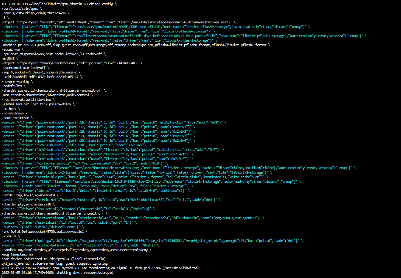

May 5, 20233 yr Author What do you mean by that? I installed the VM as stated. As soon as I go to start, does the error come up? I don't know what to do anymore! It doesn't matter which VM I install, the attached info appears Edited May 5, 20233 yr by Spanokel
May 5, 20233 yr Author Egal welche VM ich anlegen möchte, erscheitn im PRotokoll der Fehler: char device redirected to /dev/pts/24 (label charserial0) qxl_send_events: spice-server bug: guest stopped, ignoring Ich weis nicht mehr was ich machen soll
