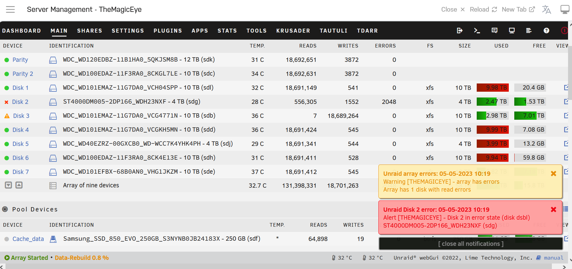

The copy of parity to the 12TB drive has completed successfully and I have just commenced the final step of starting up the array for the data rebuild onto what was the old 10TB parity drive. About 15 mins into this step another data drive, (not involved in the swap procedure at all) has gone and disabled itself.
I would appreciate advice on what is my best/safest course of action now?

Disk2 dropped offline, looks more like a power/connection issue, but since it dropped there's no SMART, let the rebuild finished then check/replace cables for disk2 and post new diags after array start.

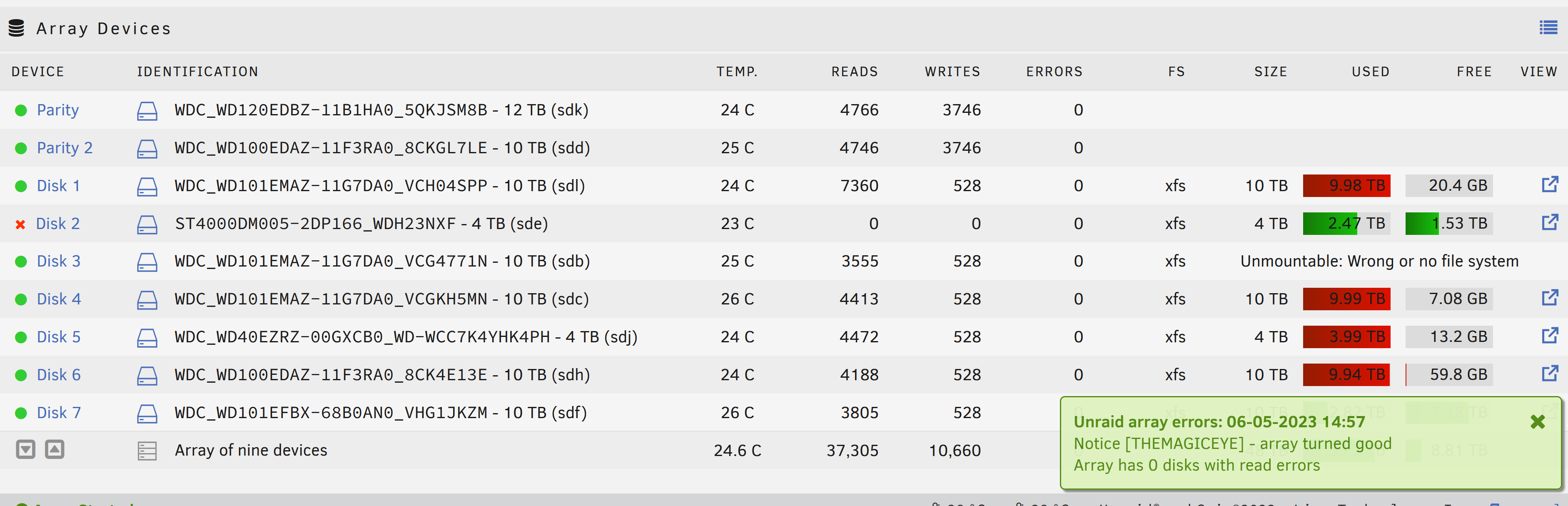

OK so have now replaced all my sata cables including for disk 2. Powering on see's a message suggesting the array has turned good and now has no disks with read errors. Do I now just stop the array and add disk 2 back into the array? Diagnostics also attached - thanks again

Sheesh have also just noticed the 10TB data drive that just finished rebuilding is reporting as Unmountable: Wrong or no file system. Can be seen in the screenshot of previous post.
Not sure what this is about as the rebuild appeared successful.
6 hours ago, JorgeB said:
Check filesystem on disk3.

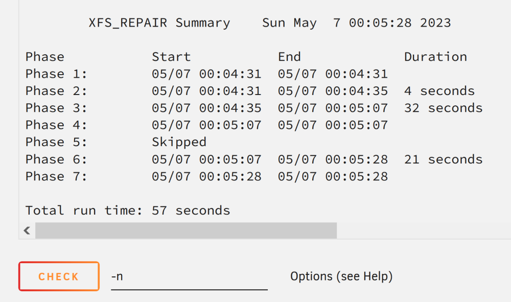

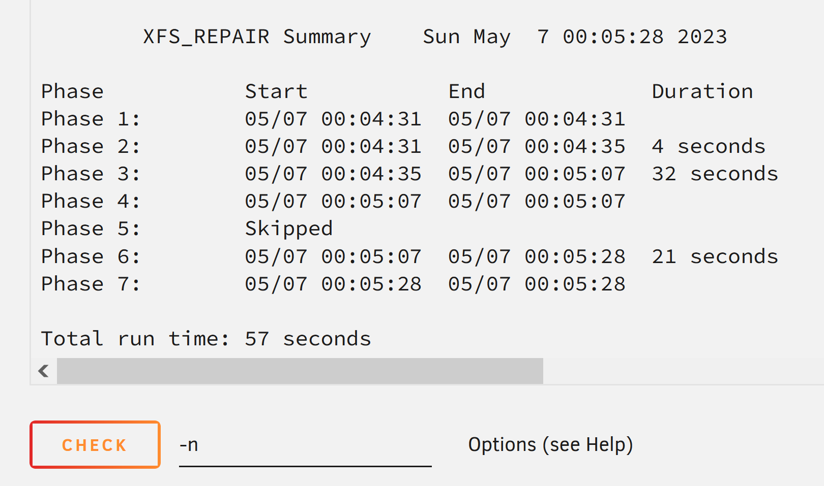

Things seem very off. First -nv check ran for about a second and reported no issues. Ran it again and had literally thousands of lines as the test ran, then provided the following results, again with no suggested repairs. Very unsure what to do from here - format disk 3 and rebuild it again?
themagiceye-diagnostics-20230507-0010.zip
A rebuild will not fix unmountable drive, and a format will wipe its contents so you do not want to do that.!

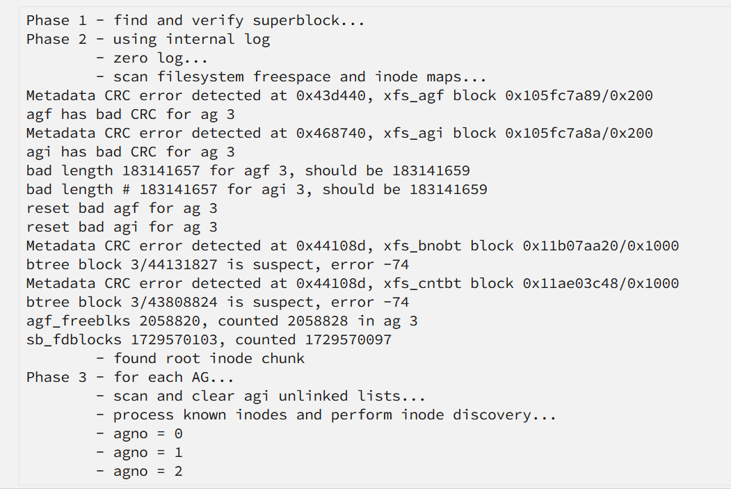

Run a quick memtest to rule out obvious RAM issues and if OK run xfs_repair again without -n.

Alrighty, so passed the memtest without any errors, ran the xfs repair again without the -n. It found some issues (see screenshot), but appears to have fixed them as when I ran it again with the -n there were no issues this time around. Fired up the array out of maintenance mode, and Disk 3 is back!
Thank you so much!
