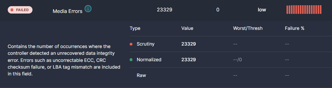

Scrutiny is showing a ton of medium errors, but it's been doing this on both drives, from day 1. I updated firmware at the time, but it didn't seem to have any affect, and the drives have been running fine for well over a year at this point.

Both devices are reporting read errors, these look like device problem for both, though one is worse than the other, from SMART:
cache1
Media and Data Integrity Errors:    23,329
cache2
Media and Data Integrity Errors:    4,105
Thanks for the quick response!
They were overheating originally, so I added some heatsinks, though my understanding is that the SSDs with throttle performance to avoid errors just like this, so I'm not quite sure what's going on.
Look for a firmware update, IIRC there are knwon issues with some devices from this model that an update can fix, not sure if it's this one though.
Updated. I'll keep an eye on it and report back. Cheers.
