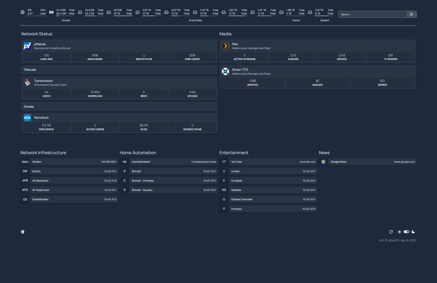

i simply wan't it to look something like this. (picture below)
can soemone point me to figure out how to maneuvre in the yaml files.

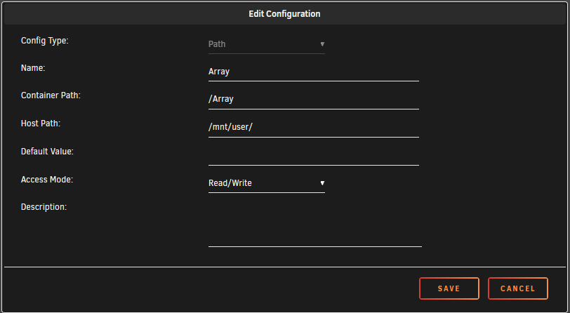

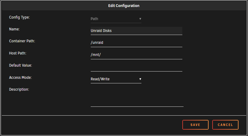

So Yaml files edit best in Notepad++ and I have my appdata folder accessible in a windows share.

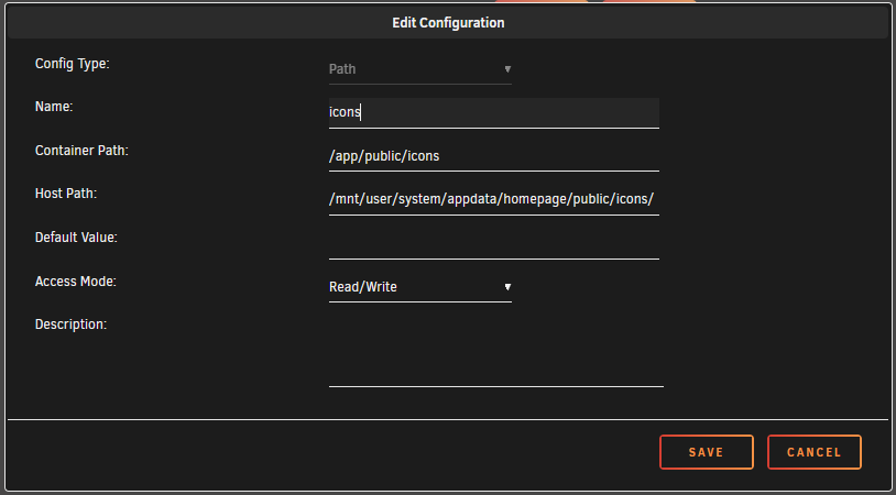

Create the additional Paths:
My appdata folder is on a SSD pool
Not Happy with this yet
I should probably switch these to read only.
Did you create the icons folder? .../appdata/homepage/public/icons/ and then:
Run the Container
While the container is running, open the WebUI.
Opening the page will generate the configuration files.
You may need to set the permissions of the folders to be able to edit the files.
Click on the Homepage icon.
Click on Console.
Enter
chmod -R u-x,go-rwx,go+u,ugo+X /app/config
chmod -R u-x,go-rwx,go+u,ugo+X /app/public/icons
chown -R nobody:users /app/config
chown -R nobody:users /app/public/icons
The three sections I've modified are:

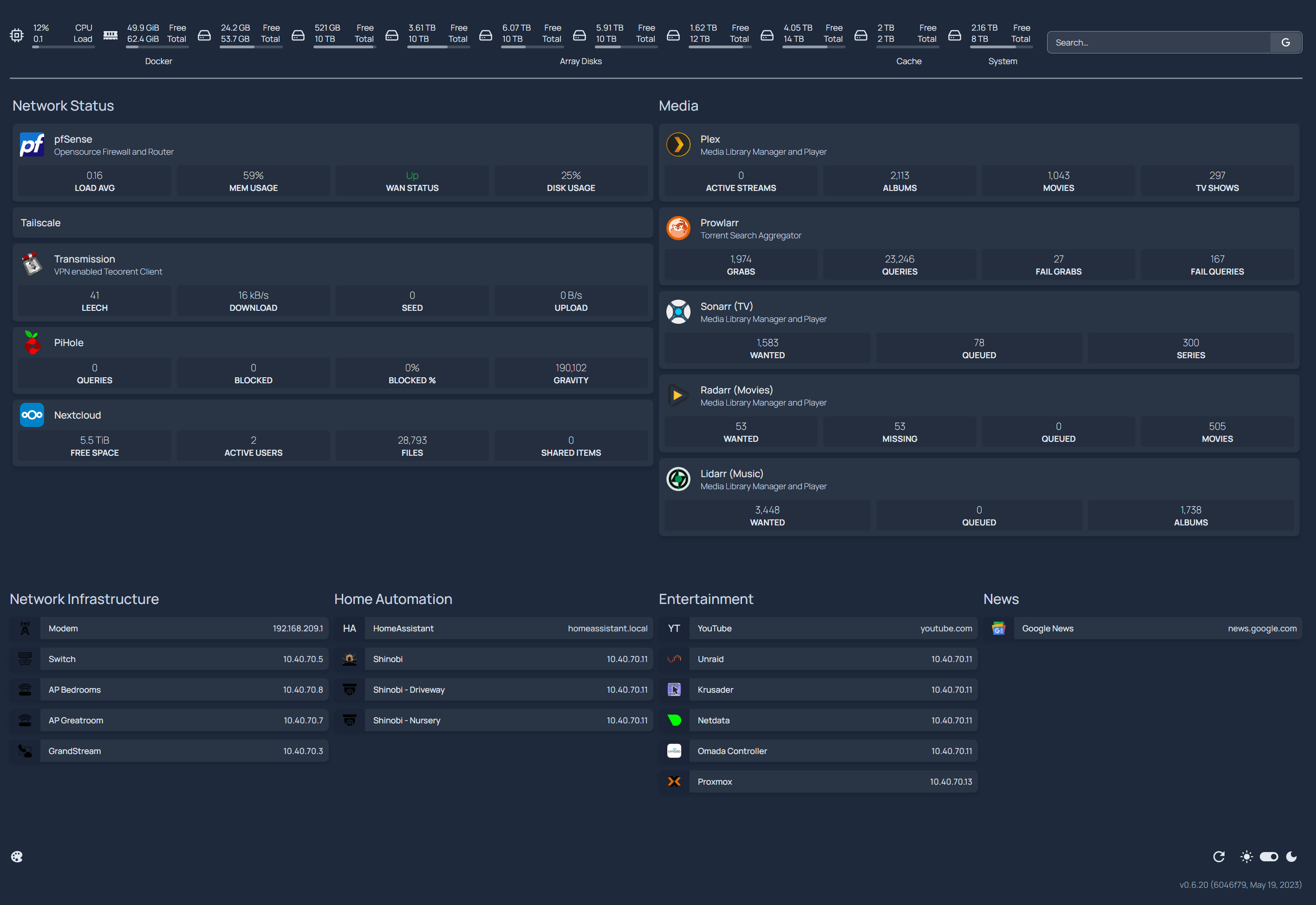

Final Product (reworked a bit as I wrote this):
Notes:
  • Most Fields lines can be left blank and they will show all 4... if you only want some, or you want different ones you can pick and chose.
  • No backslash at the end of the url
  • I get my icons by draging them from the dashboard to the folder
  • My PiHole is not functional (at the moment)

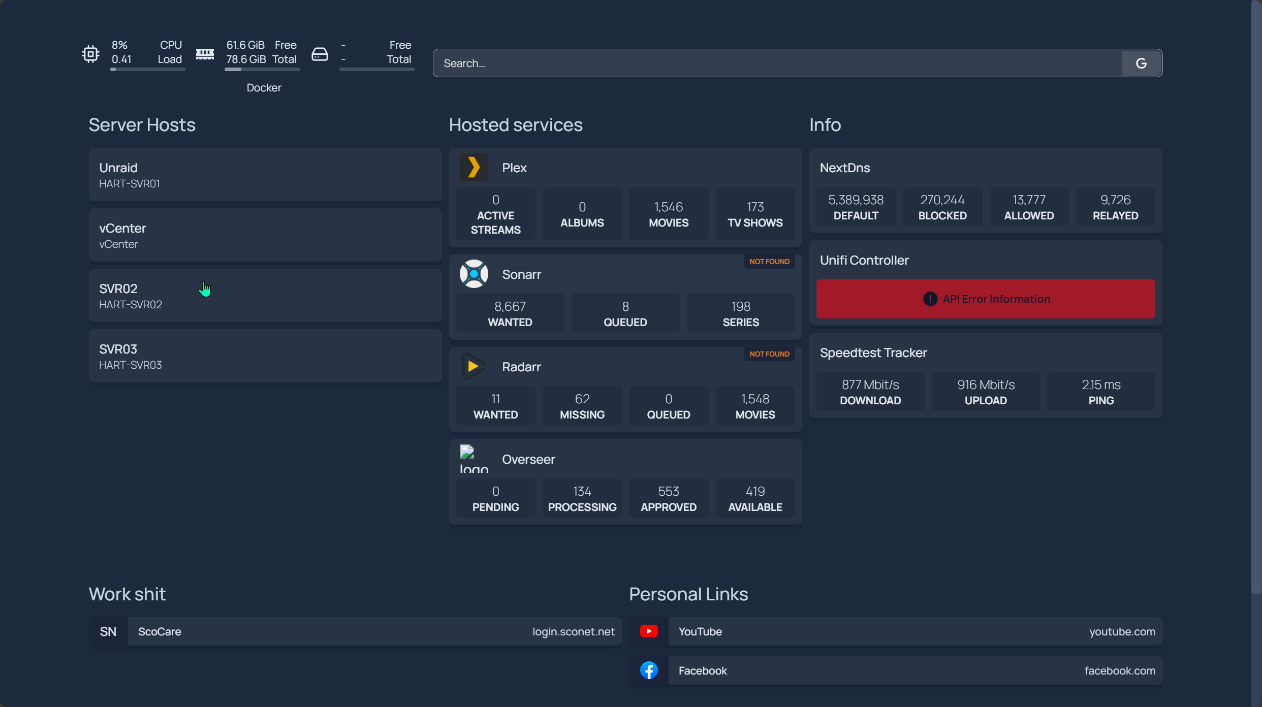

I'm having issue with the Drive widget at the top. I did take you .yaml file and configured it in a way for my homepage but now it's just blank. not sure if anyone has seen this before.
theres also issues with the unifi controller. im assuming it does not work with Unifi dream machine controllers but im still looking into this.
Sorry to necro this, but did you find a solution to this?  I mapped the path to my unraid disks and set up the disks in the widgets yaml as mentioned.  Ended up getting the same thing as you, a blank set of disks widgets.  Not sure why.
**EDIT**
**Note: Discovered that the solution below causes Unraid to map user shares directly to disk1, etc. Whilst the solution works, it also generates warnings from the 'Fix Common Problems' plugin.  Still looking for a solution that works around that issue**
Found the solution on reddit.  I mapped container paths to each disk individually:
/disk1 = /mnt/disk1/
/disk2 =/mnt/disk2/
etc.
You can map the whole array at '/mnt/user/' and the system/boot drive at '/boot/'.
I mapped them all as read-only...seemed sensible.
