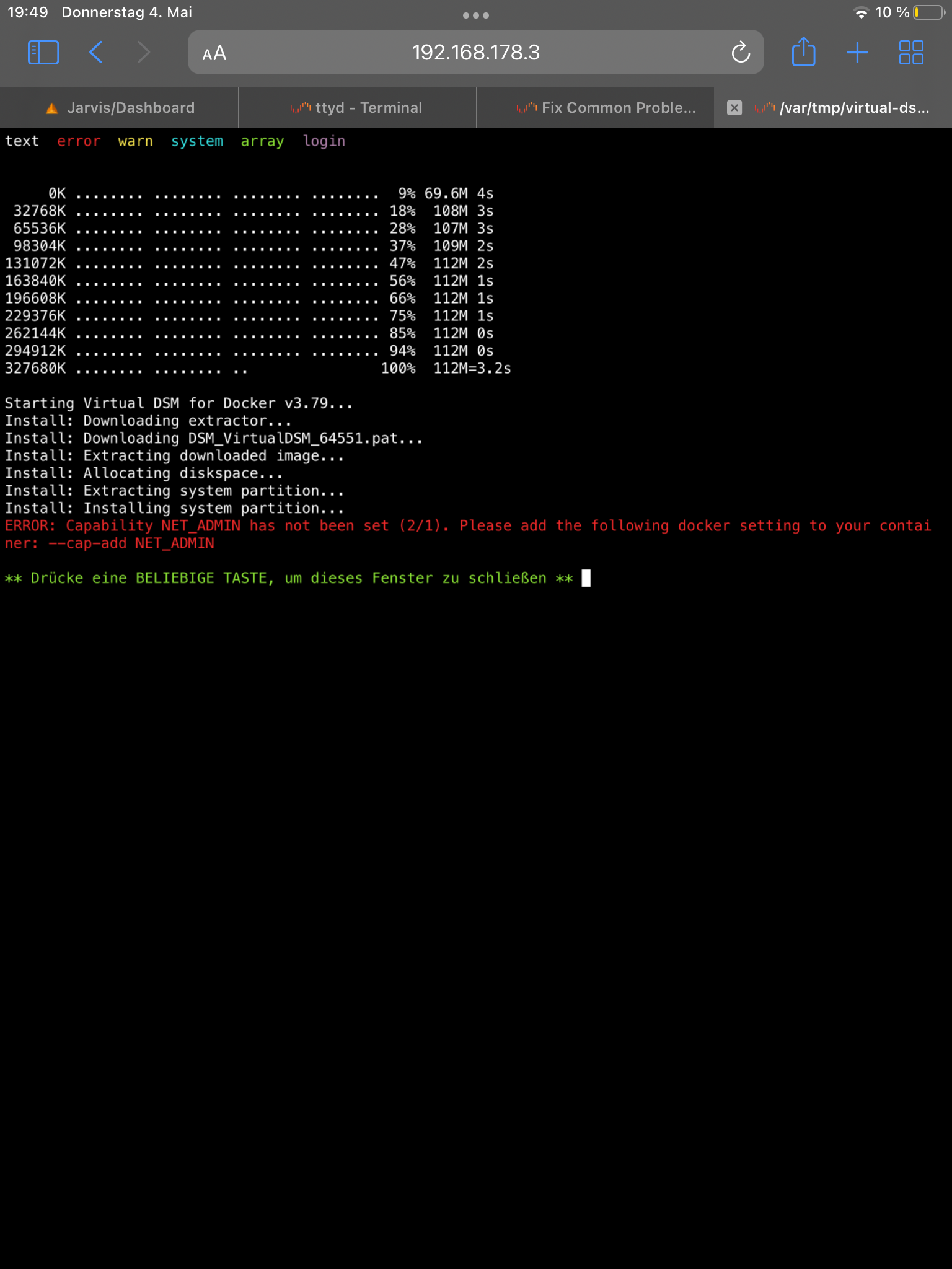

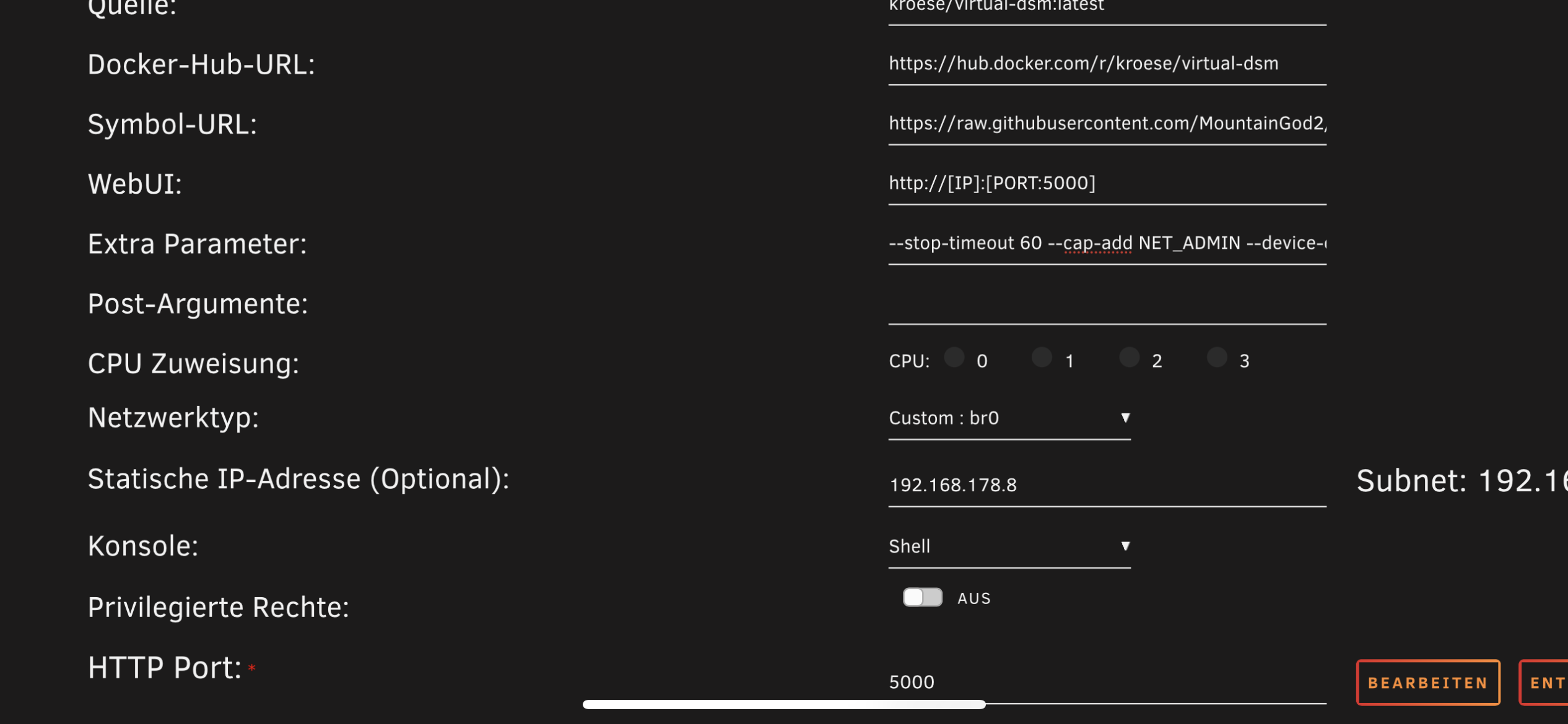

I tried to install Viritual DSM and must have done something wrong in the settings.
At the beginning everything looked fine during the installation, then I let the system do it and after 10 minutes the Docker was stopped and could not be started anymore.
I looked in the log data and there was an error message.
I have attached the log file as an image and the settings.
Please help
GreetingsIMG_0009.thumb.png.e84748175d9fd078204728e18841c8f1.pngIMG_6150.thumb.png.c51e7e7f0dd0c644763b0c04394515cb.png

 I think the problem is that your br0 network type is set to IPVLAN instead of MACVLAN.
You should change it to macvlan, and enable the setting "Host access to custom networks" in unRAID. After that it should work with DHCP=Y.
If it doesn't, please make sure you are using the latest version and post the logs.
If you do that, be aware macvlan causes crashes on some systems. This is the reason the default was changed to ipvlan.

Okay, where can I change things in Unraid?
What should I do if this leads to crashes?
Switch back to ipvlan.
