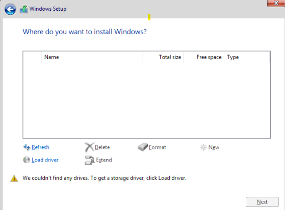

May 6, 20233 yr I am able to boot Windows Tiny-11 setup iso and start the Windows's setup, but it does fails to find any drive to install WIndows. It appears to be missing a device driver to dected the VM disk I created using unraid (Add VM) Where can I find the required device driver?
May 6, 20233 yr Community Expert Solution 1 minute ago, JackSafari said: I am able to boot Windows Tiny-11 setup iso and start the Windows's setup, but it does fails to find any drive to install WIndows. It appears to be missing a device driver to dected the VM disk I created using unraid (Add VM) Where can I find the required device driver? add virtio cd and load from it and look for the storage driver virstor.
