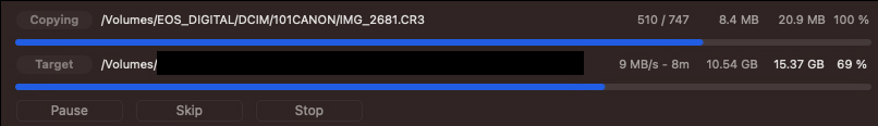

Im a photographer and almost daily I move more than 20GB of data to my unraid server from my mac via the sd card reader.
all of my devices are connected via ethernet (cat6)
I used to get transfer speeds of about 60-75MB/s on my PC.
now when doing the same through my mac studio I usually don't get any faster than 1-30MB/s
See if this discussion helps
You may also want to disable smb signing if it's enabled on Mac, as that will severely affect performance
