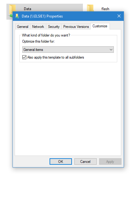

May 24, 20233 yr Community Expert Does it work better if you spin up all the drives (Look on MAIN tab under the Array Operations section for this button) before you open Windows Explorer to access your shares? One other thing to try is set this option for each share in Windows Explorer as shown here: You get here by right-clicking on the share and pick Properties from the drop-down list.

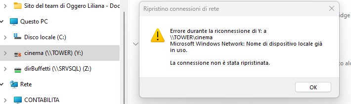

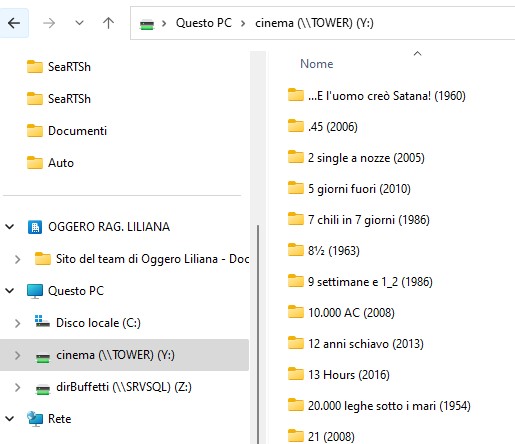

May 24, 20233 yr Author Also with a share I have same problem: after some clicks all works: Edited May 24, 20233 yr by Flavio61
