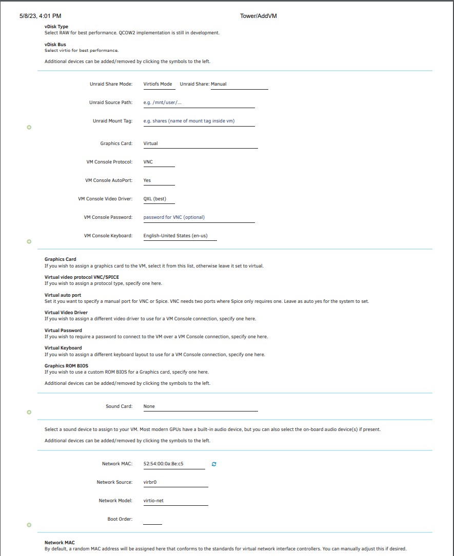

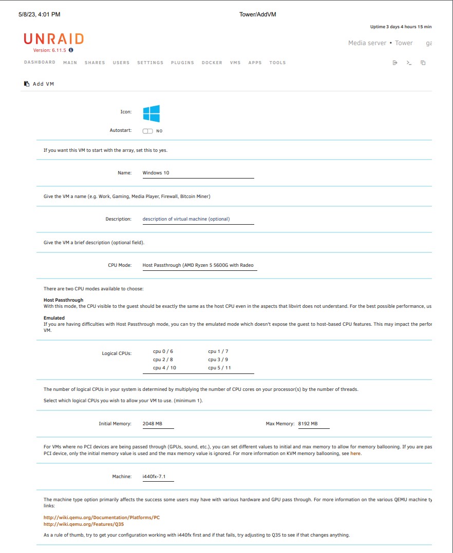

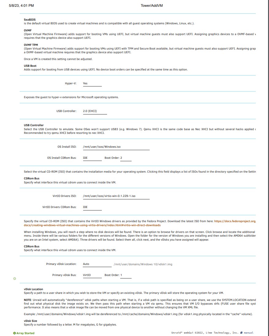

I was able to use tightvnc, use the ctrl+alt+del to give me the boot options. I was able to get windows 10 installed. Now I'm having issue connecting to a network. It appears all the drivers are isntalled.
Do you have any unknown devices? NIC driver must be installed.

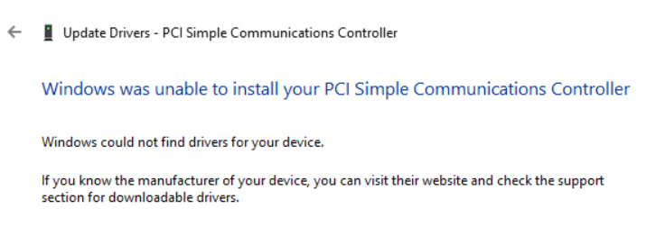

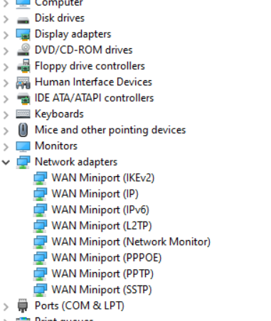

No, not on the first install. I did reinstall the vm because it doesnt take long to do. I have 3  devices in "other"
Install the Virtio drives, of of those might be the NIC.
I've tried and I keep running into this
Post the VM XML to confirm a NIC still exists, or choose e1000 for the "Network Model", that one doesn't require a driver.

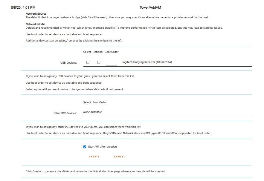

There's no NIC configured, how did you change to e1000? Update to v6.12-rc5 and post the for view for the VM.
I changed netowork model to e1000 when setting up the vm again. I upgraded to v6.12-rc5. The libvert log is now kicking out an error after the update.
