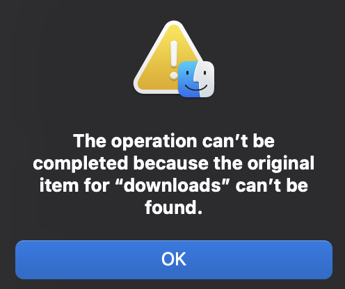

A note, when I try to open the downloads share from the root share I get that it can't be found... Edit: I re-connected to the root share and now its just saying I don't have permissions like the rest are.

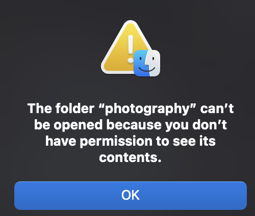

When I try to open photography from the root share I am getting that I do not have permissions.

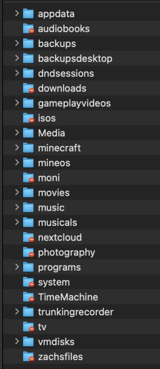

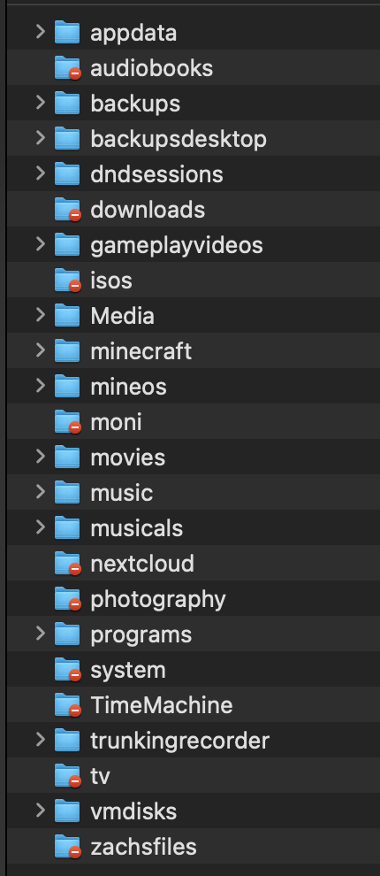

Here is a screenshot from finder.

I am noticing that it seems that files with the + at the end of the perms are the ones for the most part giving me the issue, where might the ACLs come from?
See this example of a   "+" sign in the permissions.
That can be a problem. This "+" means that ACL (Access Control List) permissions have been assigned to this resource in addition to the standard Linux permissions.  Start by reading here:
     https://forums.unraid.net/topic/116389-access-denied-printer-unraid-share/#comment-1058963
I understand that AD (Active Directory) can sometimes do this but then you had better always be using AD to control access via SMB.
