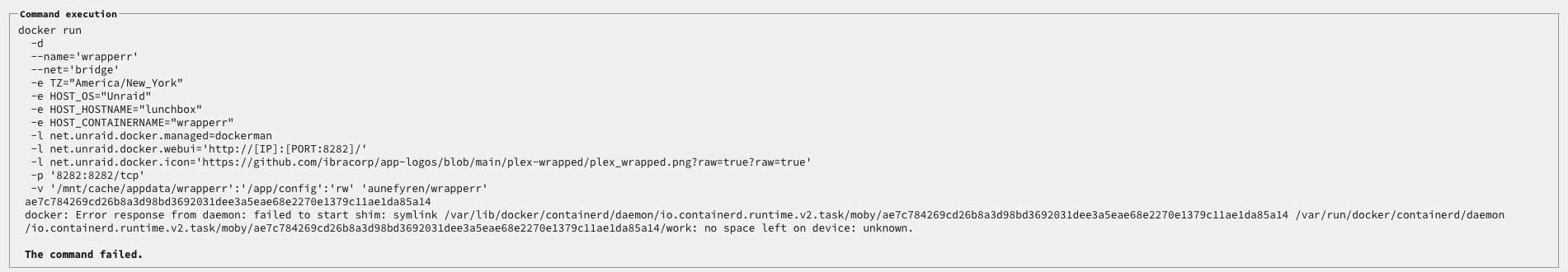

Today some of my containers stopped and could not be restarted. Trying to start these containers results in an "Execution Error" pop-up. When I actually get the docker run command to run I get an error message that I've attached as a screenshot.

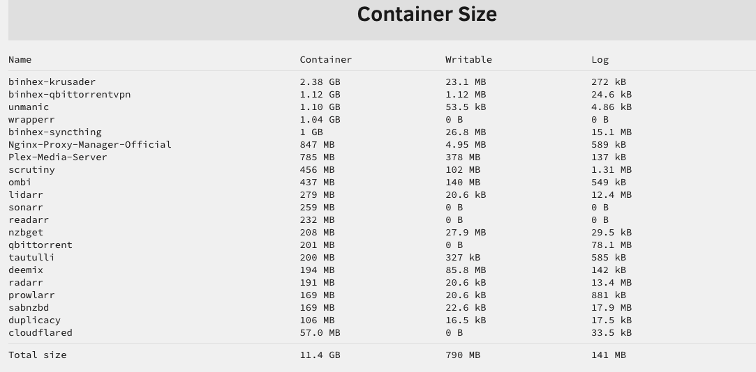

My docker image doesn't seem to be out of space, neither does cache or system so I'm stumped as to what is causing this issue? All my paths seem to be in order and no ports seem to conflict.

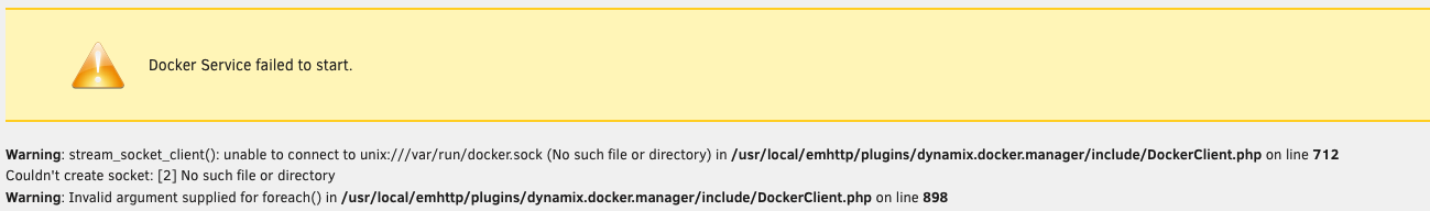

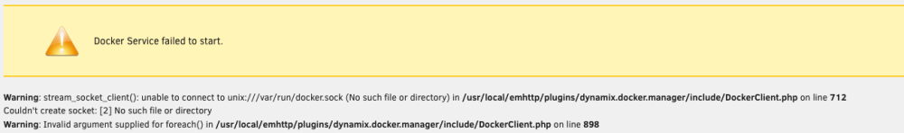

I just tried restarting docker completely and now get the following error:
1497167402_Screenshot2023-05-08at11_55_07PM.thumb.png.da61db622a04d08e1f4077662adf03d8.png
