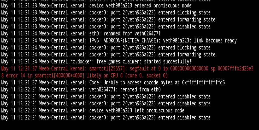

just had a few segfaults:
May 12 17:37:06 Weeb-Central kernel: smartctl[26804]: segfault at 0 ip 0000000000000000 sp 00007ffe308ded48 error 14 in smartctl[400000+4000] likely on CPU 0 (core 0, socket 0)
May 12 17:37:06 Weeb-Central kernel: Code: Unable to access opcode bytes at 0xffffffffffffffd6.
May 12 17:56:54 Weeb-Central kernel: smartctl[9730]: segfault at 0 ip 0000000000000000 sp 00007ffcbc08bdf8 error 14 in smartctl[400000+4000] likely on CPU 16 (core 36, socket 0)
May 12 17:56:54 Weeb-Central kernel: Code: Unable to access opcode bytes at 0xffffffffffffffd6.

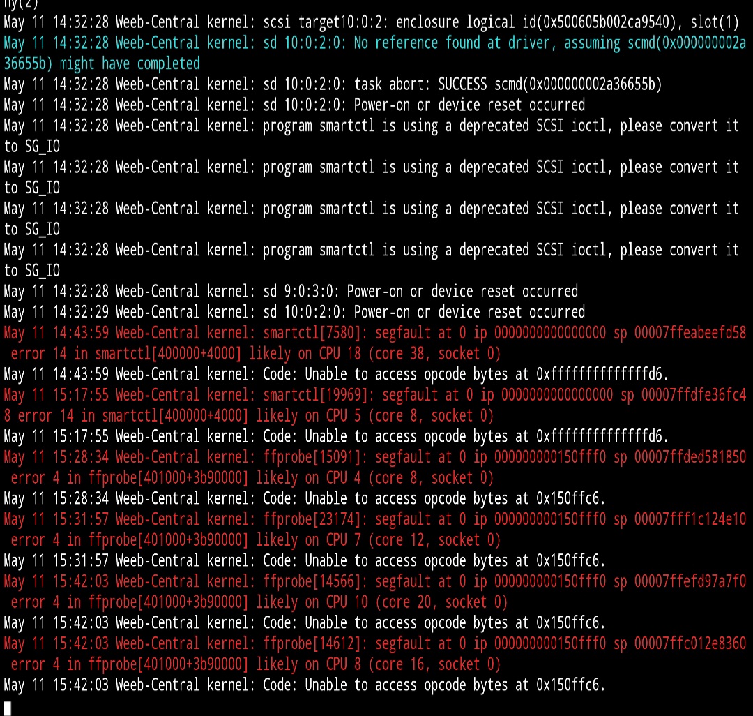

I moved everything back to the old hardware and I just got another segfault. Since it is on SmartCTL this makes it seem like it would be one of the HBA cards. Any thoughts?
I am assume SmartCTL has something to do with the smart checks on the HDD's
