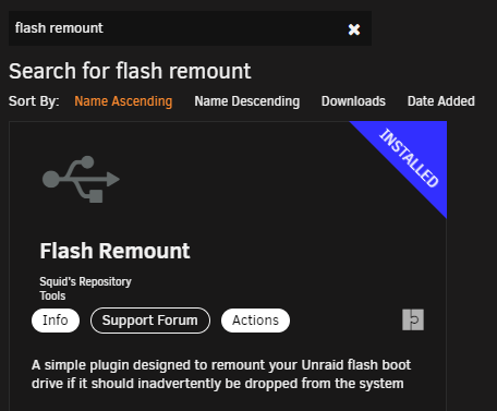

Short of a different flash or port, you can try this
You will however have to have the flash working in order to install it.  (And then reboot after its installed)
21 hours in, parity achieved, seems like a good solution.  Marking solved.
seem to solve my problem too on a ITX board.
It's not a perfect solution.  If I recall correctly, it messes up if the array happens to be stopped and a reconnection happens.   Unfortunately that issue is out of my hands.
