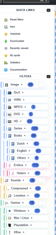

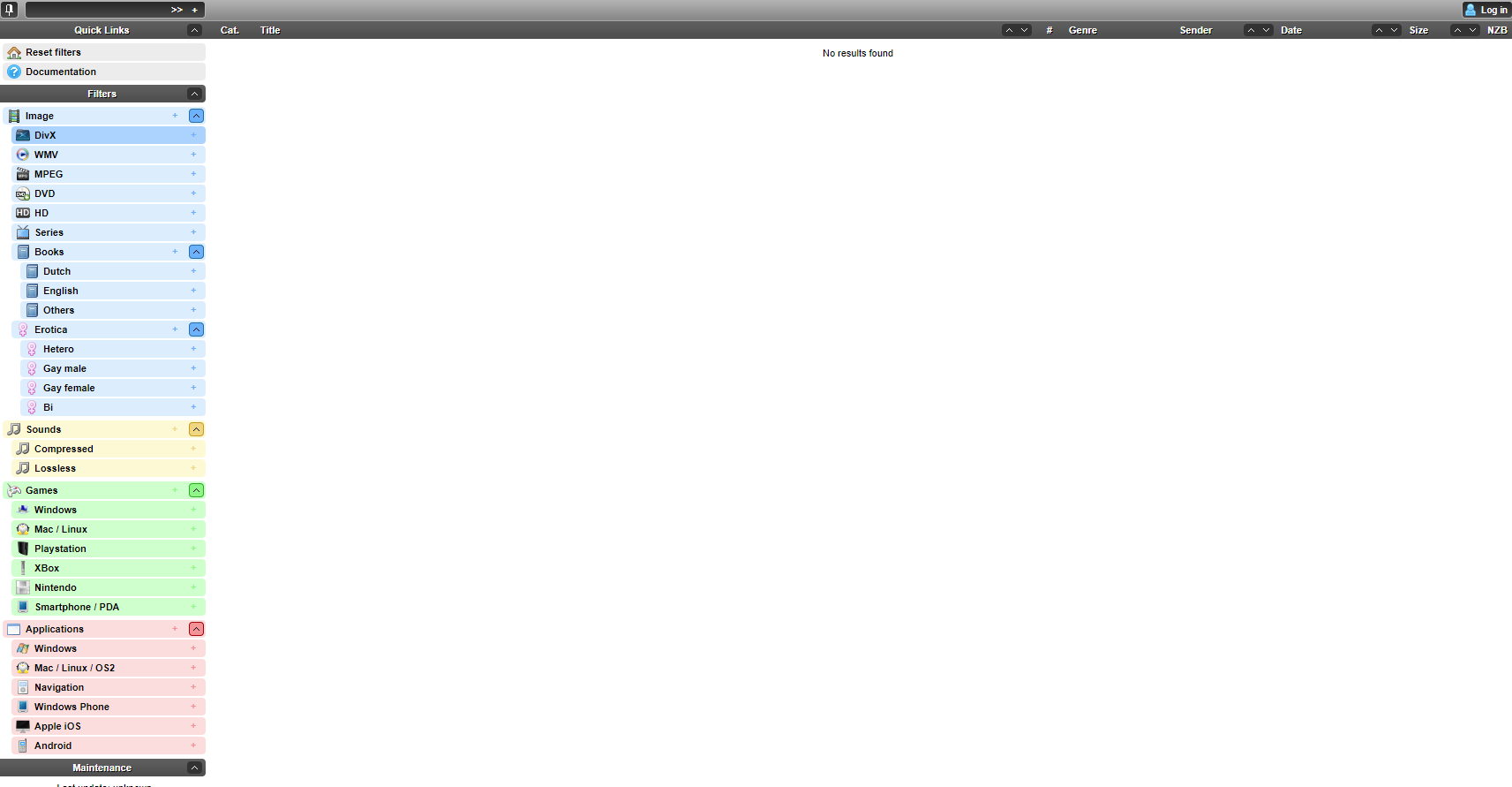

How come my Spotweb looks like this now?

On 11/27/2025 at 3:13 AM, TallMan206 said:
mine looks the same as well, not sure why
