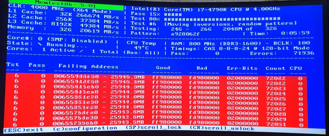

I think i have a big problem.
are all the RAMs need to be replaced
2 hours ago, JorgeB said:
You can run it again with one stick at a time.
Thank you for your support you were correct 2 of the 4 sticks need to be removed for the server.
