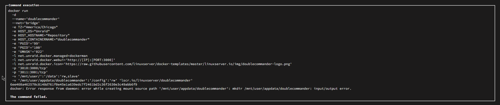

Hello. I replaced a drive and my array is working fine but I first ran into an issue restoring an Emby backup and now after both Krusader and DoubleCommander both locked up on me, I can't reinstall them. get this error:

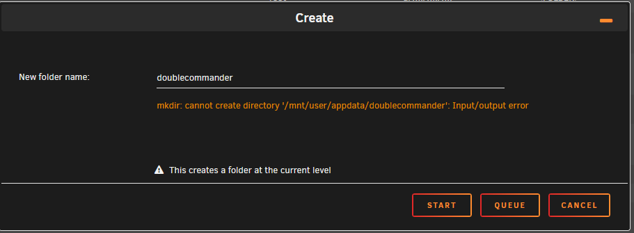

I even tried to create the folder in question with Dynamix File Manager and get this error:

On 5/12/2023 at 2:11 AM, JorgeB said:
Check filesystem on disk17, then reboot and post new diags if there are still issues.
Thanks, I had already figured this out and ran xfs_repair which fixed it for about 12 hours and now unRAID has disabled the disk. I have a replacement coming and that should fix the issue. Thanks for the response.
