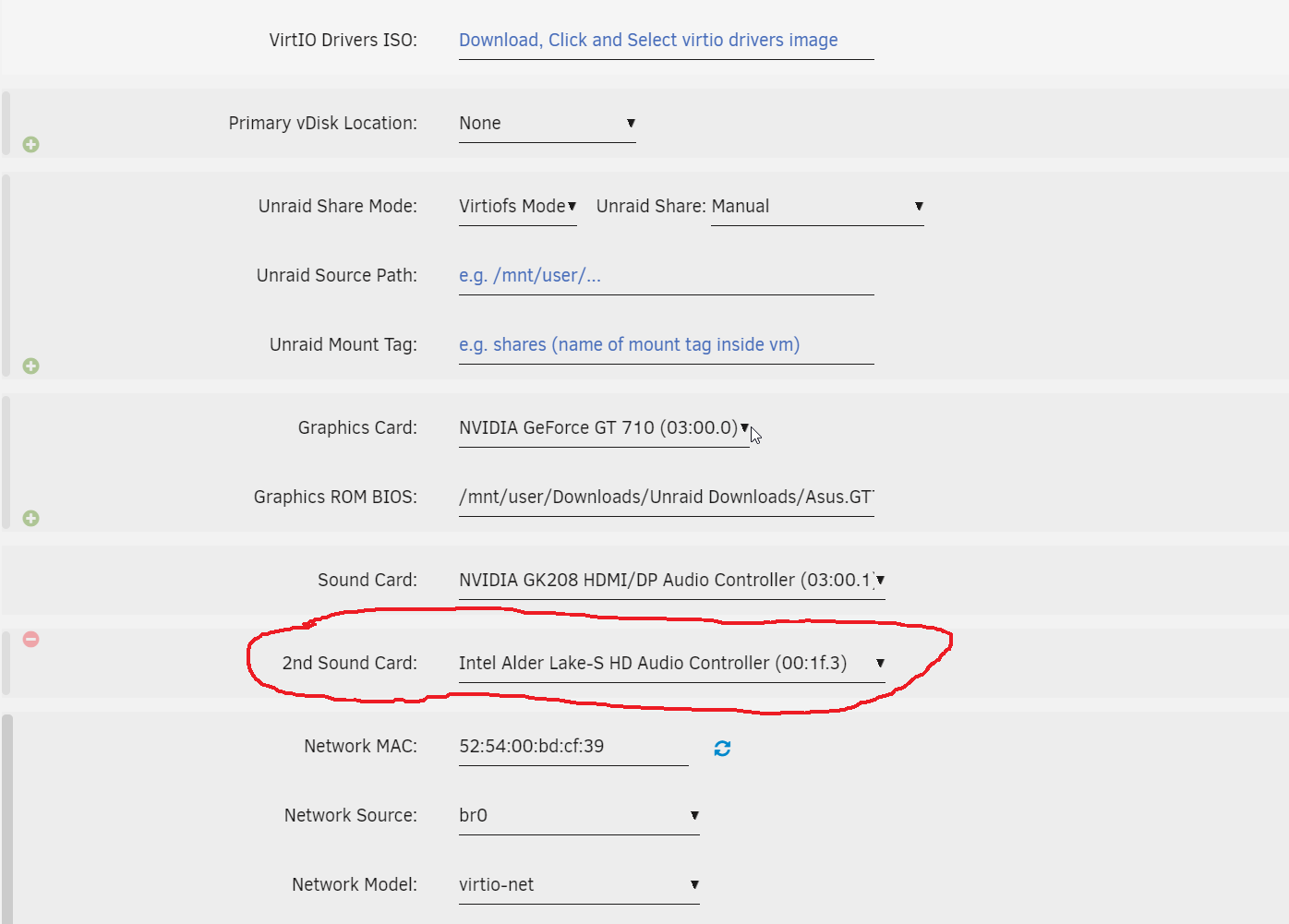

I have a new system and have already passthrough the GPU to the Win11 VM.

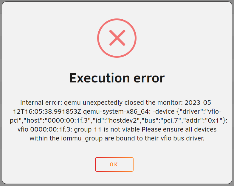

Now I also want to passthrough the onboard audio, but I get this error message.
I can't get any further, maybe you have some advice.
Thanks and many greetings
Try to enable pcie acs override and see if iommu group 11 can be splitted; then attach to vfio at boot 00:1f.3, your audio, and see if it works.
