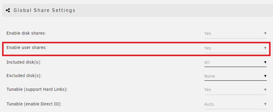

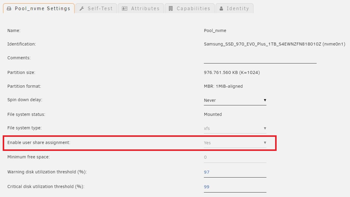

As you can see on the screenshots below User Shares and Disk Shares are both enabled within Global Share settings.

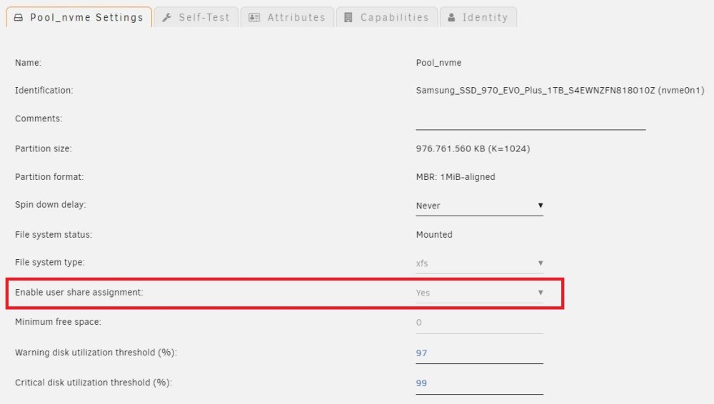

In addition the only setting for User Shares within the pool settings is enabled as well.
Screenshots and listings above proof that there must be something wrong, but I have no idea what might be wrong.
Adding the missing share "system" leads to a hanging "Starting services" for several hours. A reboot does not fix that.
To make it clear: My really fat system runs perfect since a very long time but there was always that system thing that I never found a solution for.
