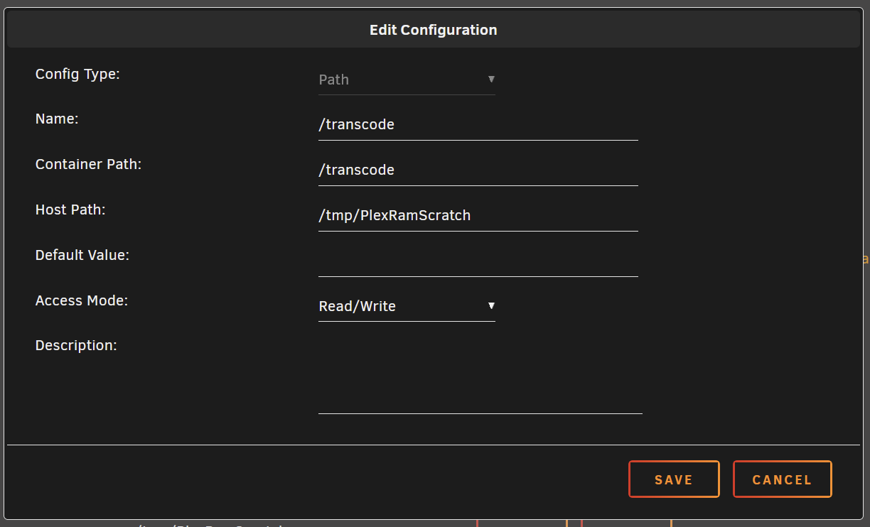

I have this in my go file in the config folder on the Unraid flash drive:
mkdir /tmp/PlexRamScratch
chmod -R 777 /tmp/PlexRamScratch
mount -t tmpfs -o size=16g tmpfs /tmp/PlexRamScratch
It creates a PlexRamScratch folder in /tmp which is in RAM.  It is limited to 16GB in size.  You could make it smaller.  I have 64GB RAM on my server so 16GB is not a big deal.
Then in the Plex docker container /trancode (container path) is set to /tmp/PlexRamScratch (host path).
Of course, in Plex, the transcode location is /transcode
