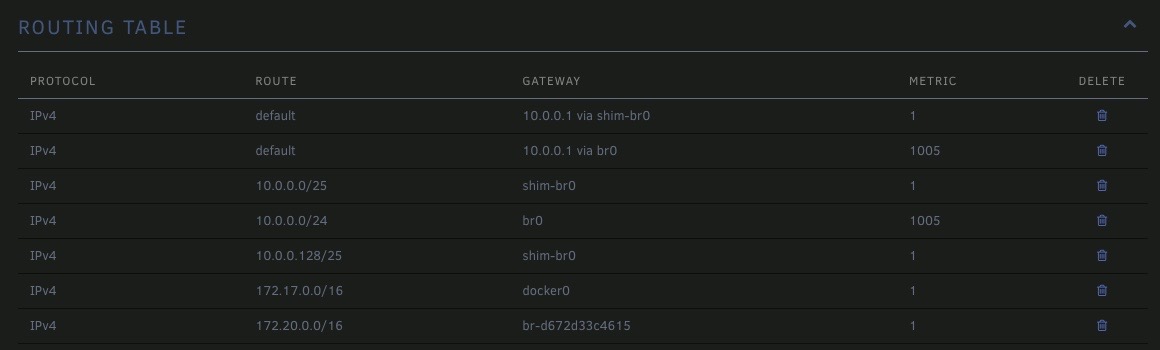

Before I start docker, there are only 2 entries in the routing table:
default            10.0.0.10 via br0
10.0.0.10/24     br0
When docker starts, I get the routing table attached.  Using the 'docker network ls' and 'docker network inspect', the entries for 172.17.0.0/16 and 172.20.0.0/16 appear.  I don't know where the shim-br0 entries are coming from.  They're obviously related to docker, but don't show up with the 'docker network' commands, and my theory is these are the problems.  Unable to delete them. Only way to get rid of them is to disable Docker again.
Thanks Hoopster.  Not sure why I couldn’t find that.  I unchecked this option and I haven’t seen this error again since so I’ll mark your post as a solution.  Though I had this exact same setup on the old hardware, and it never caused problems on the network.
