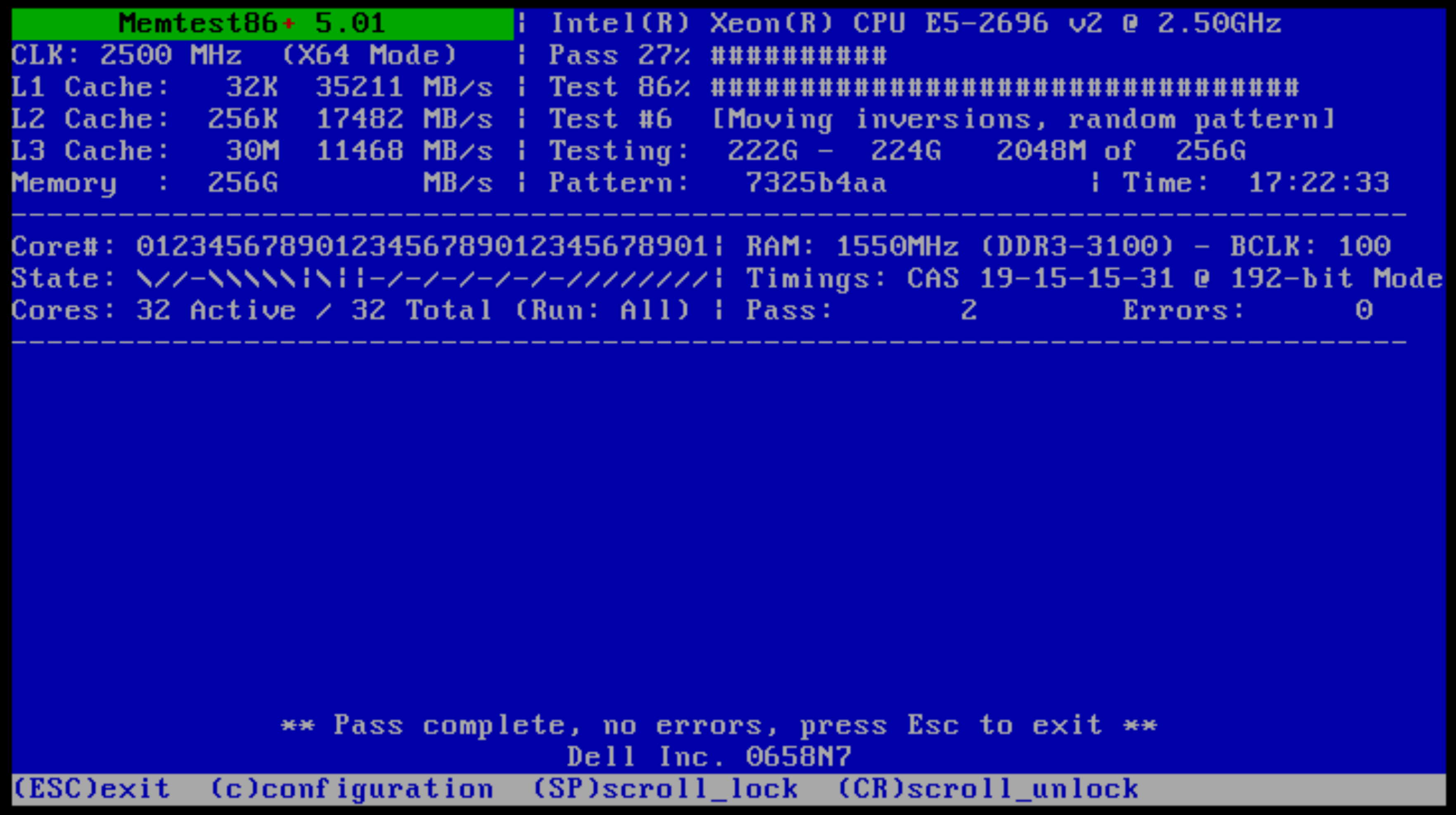

So for the whole background, I precleared both of these drives and they post read failed so I did some looking around and saw people recommending memtest to other people, so I ran memtest  for 24 hours and had no issues.

@JorgeB I'm closing in on my second 24 hour memtest run with no errors. I'm still considering letting it just go for 72 or 96 hours because that's how long a preclear takes.
Assuming I get though the memtest with no issues would you still suggest pulling half the RAM and running the preclear or do you have any other ideas on troubleshooting paths I could take?
Yes.
