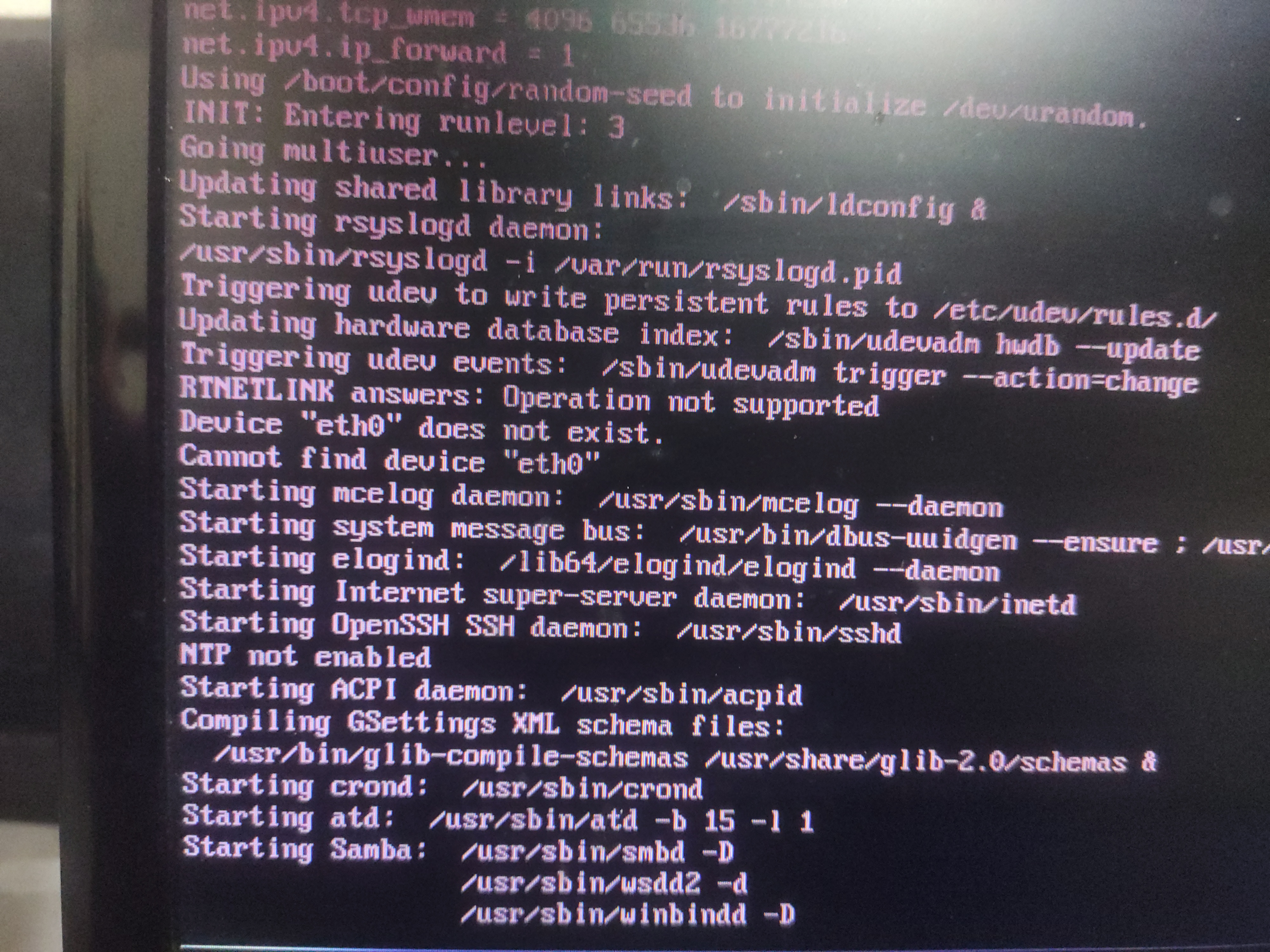

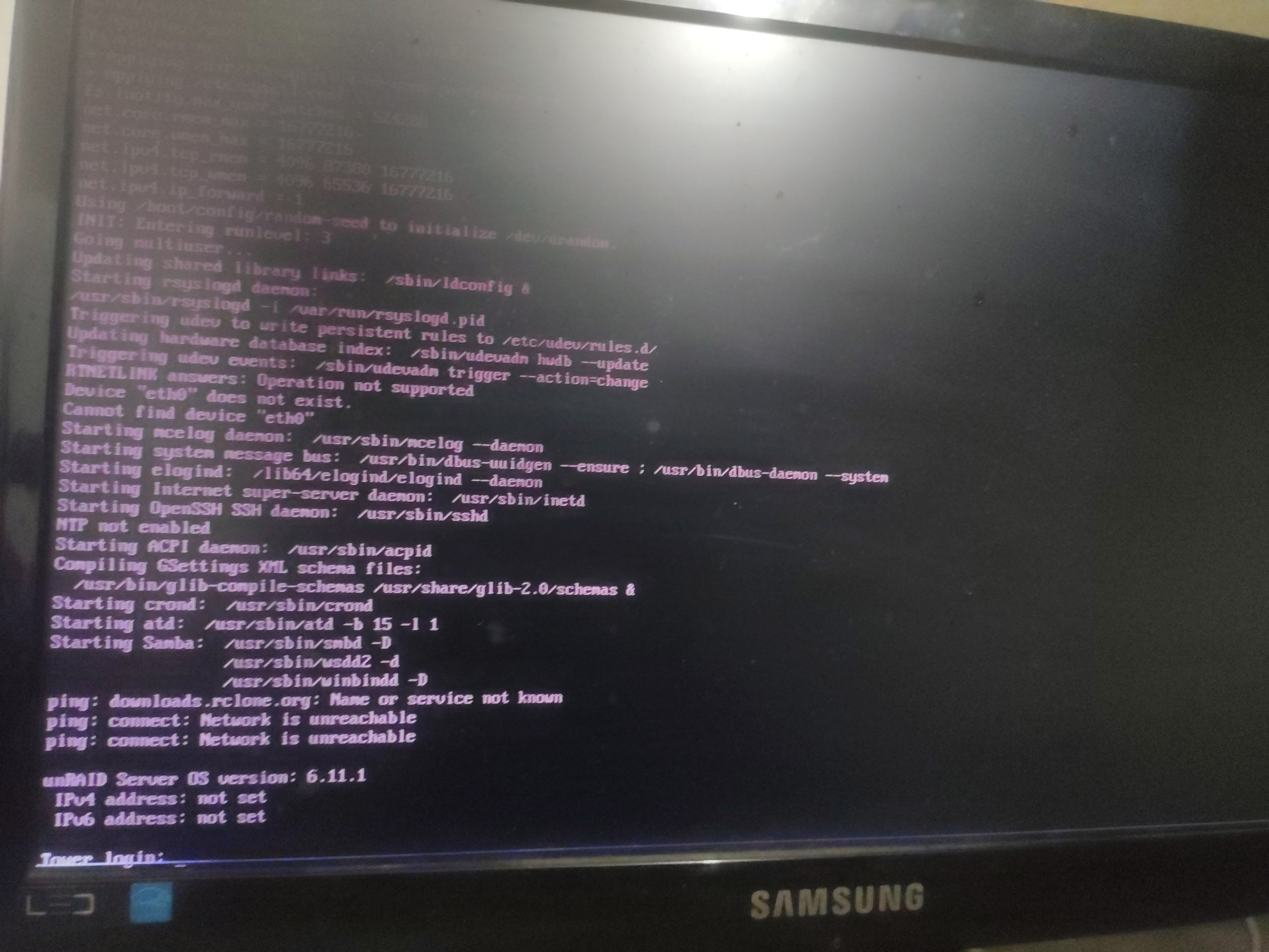

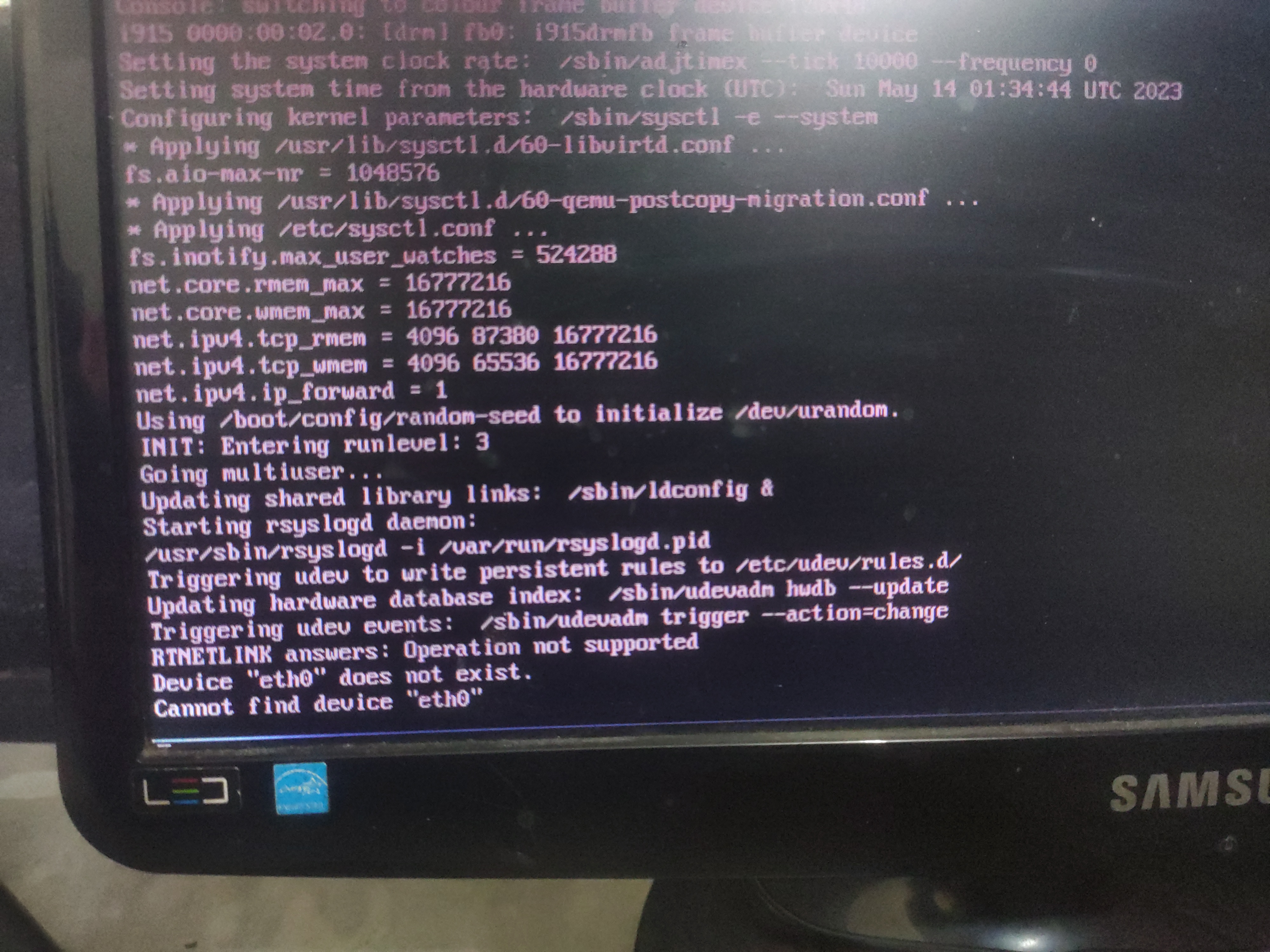

Sarequl Basar Posted May 14, 2023 Share Posted May 14, 2023 Hello guys, I haven't used my Unraid server for like 3 months. today I started my server it was working fine. then I had to move pc to another room. Then started my server, but it's showing the "eth0 does not exist". I have rebooted multiple times (from console), and changed the cable. (even Lan light was not coming). then I had unplug the PC and plugin again. then the Lan light shows up. but still showing "eth0 does not exist" (but lan light is blinking). I have attached photos of the console/terminal. Please help me. Thank You Quote Link to comment

JorgeB Posted May 15, 2023 Share Posted May 15, 2023 There's no NIC being detected by Linux, this is not a software problem, I assume the board has an onboard NIC? Check the BIOS to make sure it's enabled, if yes try with an add-on NIC. Quote Link to comment
itimpi Posted May 22, 2023 Share Posted May 22, 2023 Are you sure it is stuck? It is quite normal for that message to appear for a few minutes before the boot completes and the network starts up. Quote Link to comment

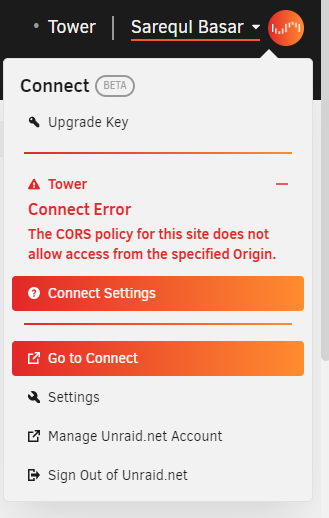

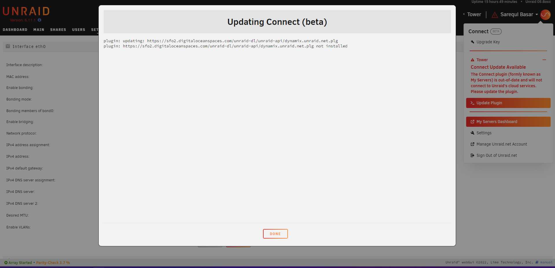

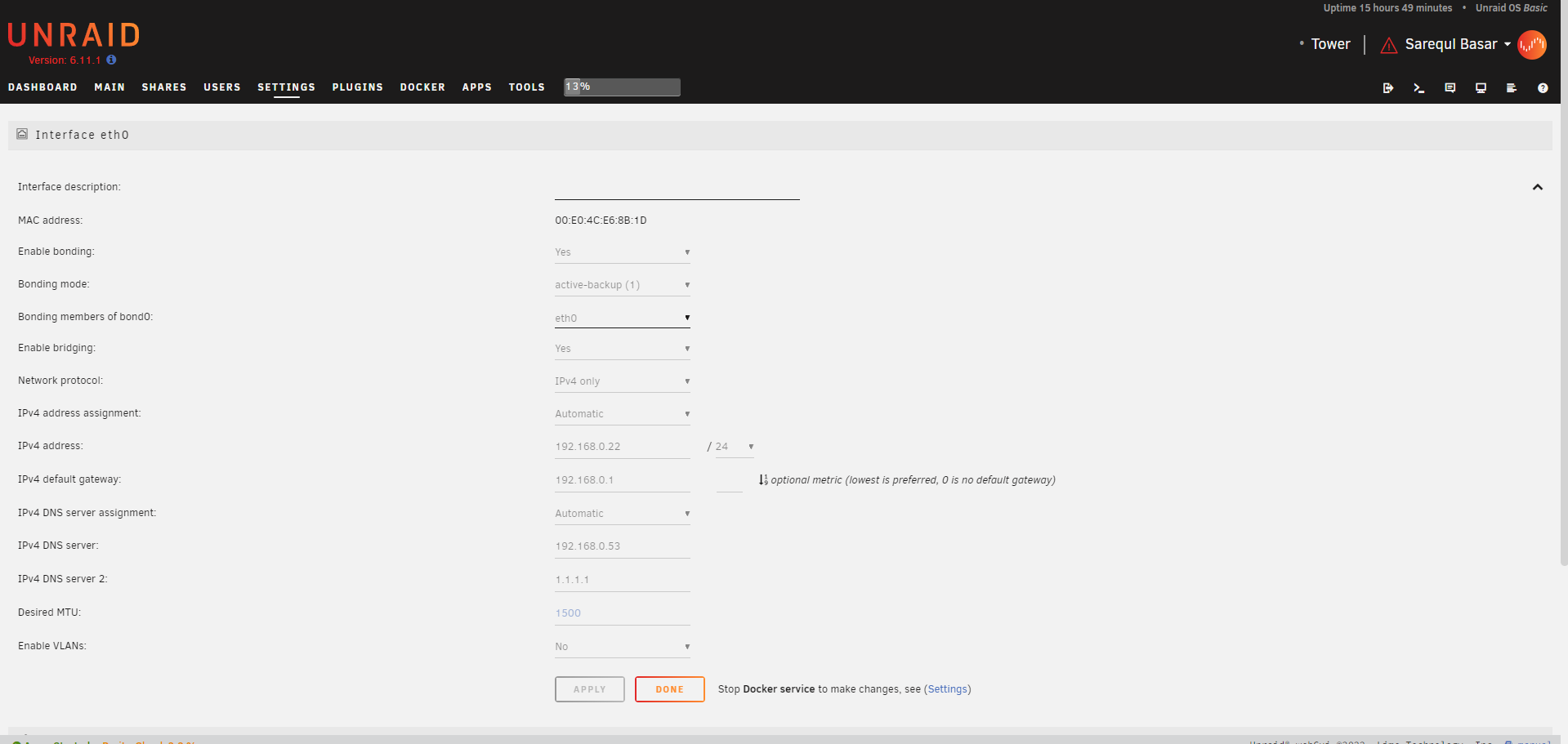

Sarequl Basar Posted May 22, 2023 Author Share Posted May 22, 2023 Hello, Thank you for the response. and sorry I have deleted that message as it was fixed after waiting a long time. but I am facing another issue. probably because of my unraid version is old. I have attached the screenshot. would you please help me? Quote Link to comment
Sarequl Basar Posted May 22, 2023 Author Share Posted May 22, 2023 (edited) I have update the nameserver to 8.8.8.8. still same issue. update 1: after changing the dns to 8.8.8.8 and 8.8.4.4 I was having cors issue. so I go back to my local dns as 1st dns server and 2nd dns is 8.8.8.8. let's see if the cors issue fixed or not. update 2: still facing the cors issue. Please help me. Edited May 22, 2023 by Sarequl Basar Quote Link to comment

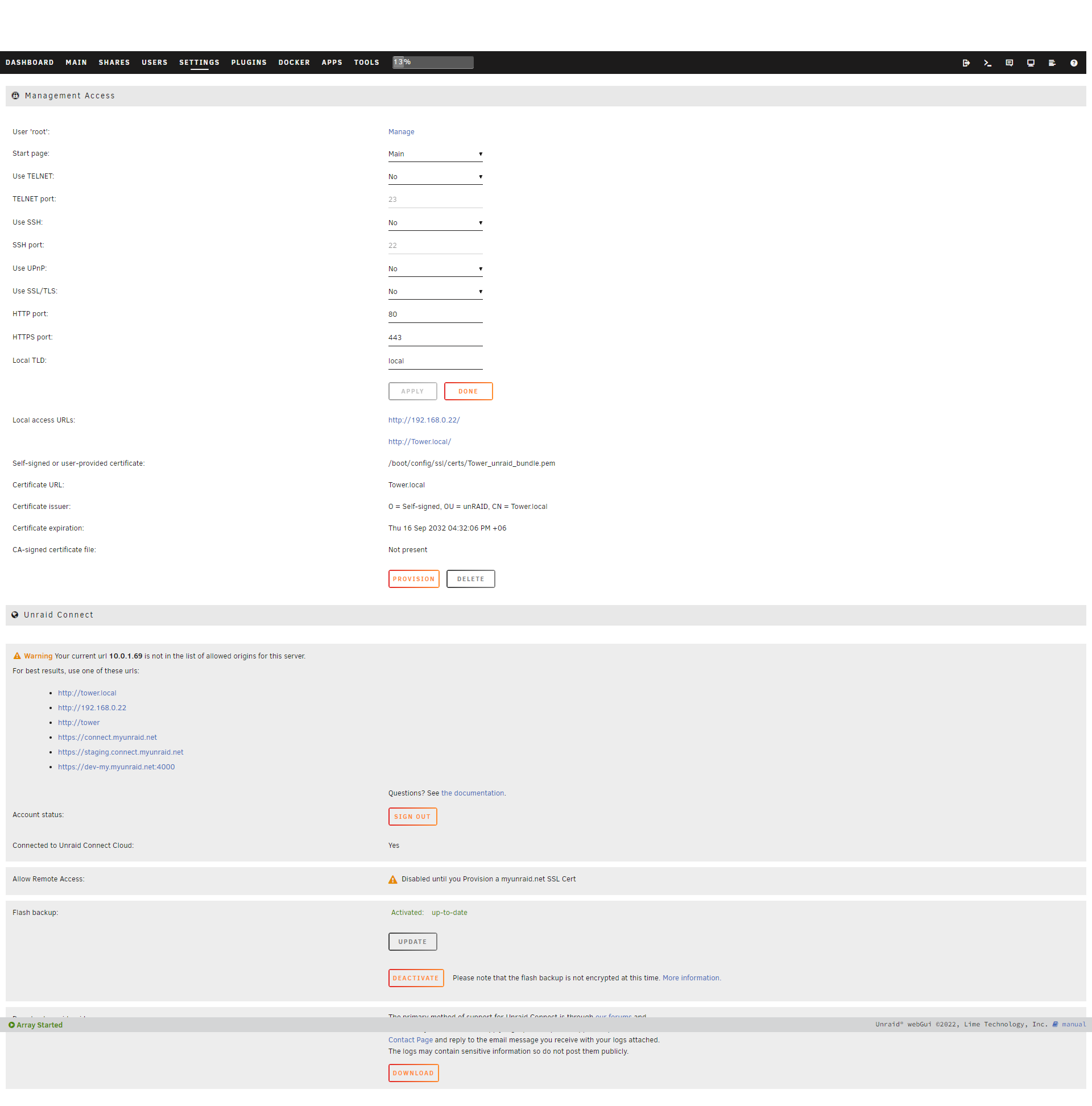

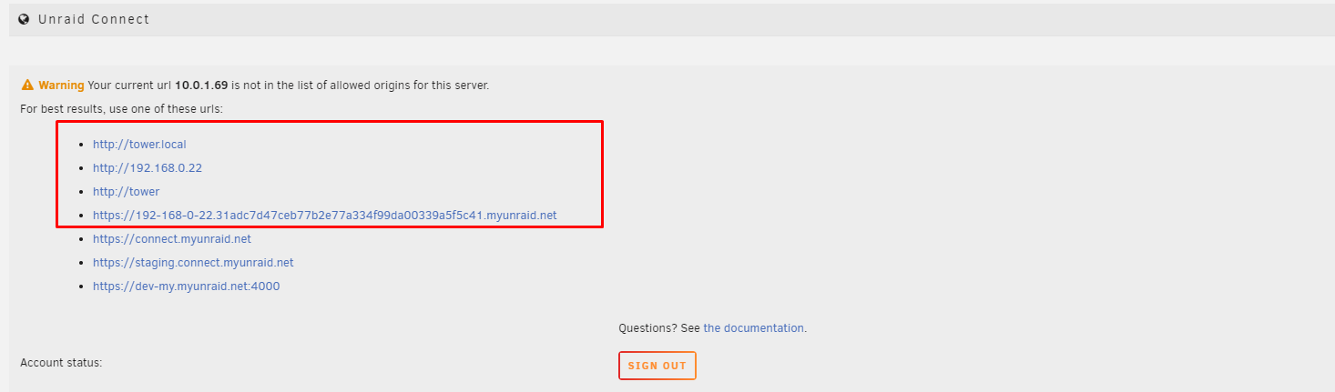

Solution Sarequl Basar Posted May 22, 2023 Author Solution Share Posted May 22, 2023 Hello, the cors issue fixed when I used these urls. also the plugin got update I think. my pc is connected directly to the mikrotik router. and my server is connect to my local network router. as most of the time I use my pc, so I use port forwarding to use unraid webui. is there any way to fix this for my 10.0.1.69 url? Please let me know. Thank You Quote Link to comment
