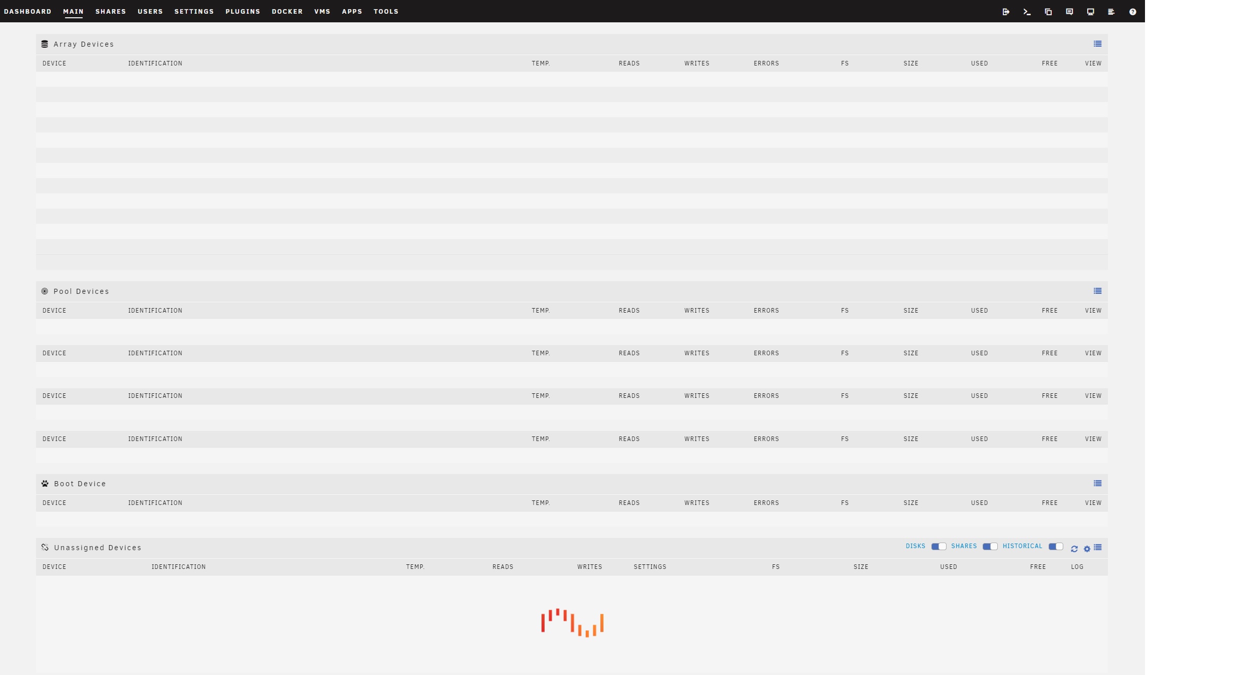

Another issue is that my server array freezes and have to restart. The server becomes unresponsive with the unraid "wait" logo. I can click through the tabs but everything becomes unresponsive, including running a diagnostic.
Attached is a log after restart and starting array.

I am at this point starting over fresh with docker so all I am looking to do a fresh start of docker. I've deleted vDisk file and all appdata but everytime i enable docker - it starts, fix common problems reports above and then eventually my array crashes (as explained above post)
I am also getting the following error in system log: May 16 16:34:32 unraid root: error: /webGui/include/InitCharts.php: wrong csrf_token
SOLVED: It was my browser crashing...
