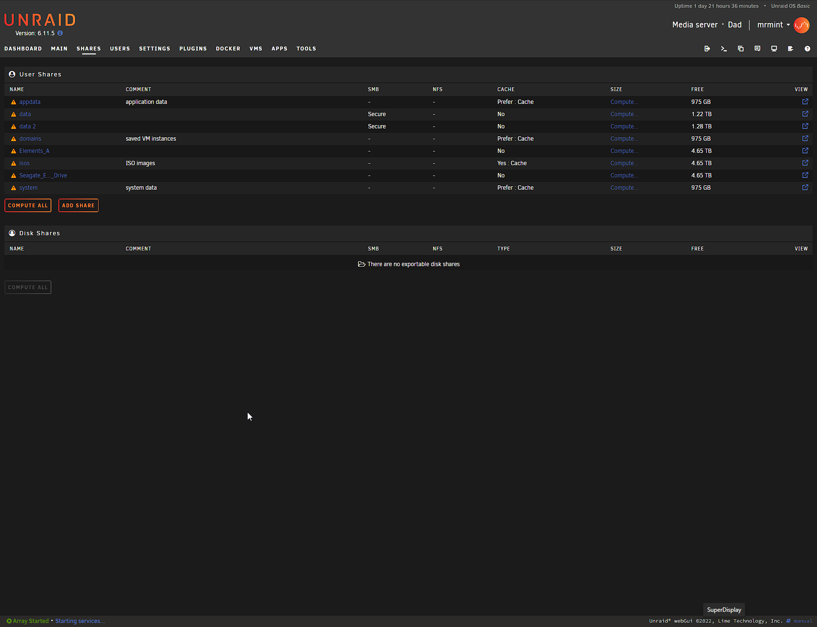

I am now on my 2nd attempt of 14tb data migration. The first one 'failed' as krusader crashed and as the data was split across drives I didn't know how to check what data had transferred ( I am a noobie) . On my most recent attempt I thought I was being smart by basically transferring one unassigned disk at a time directly to a single disk on the array thinking that I could then update the my share with all of the disk. The transfer went well, however, when I went to update the share to include all the disks the data would not show for all the disks?
I am stuck and feeling a little stressed at the thought of having to start all over AGAIN :(
Is there an easy fix so that I can either merge shares or create a new one with all the disks and data showing? I would appreciate any help you can offer. This is for my dad and I just want him to be able to view all the data across all the disk from one share in windows.

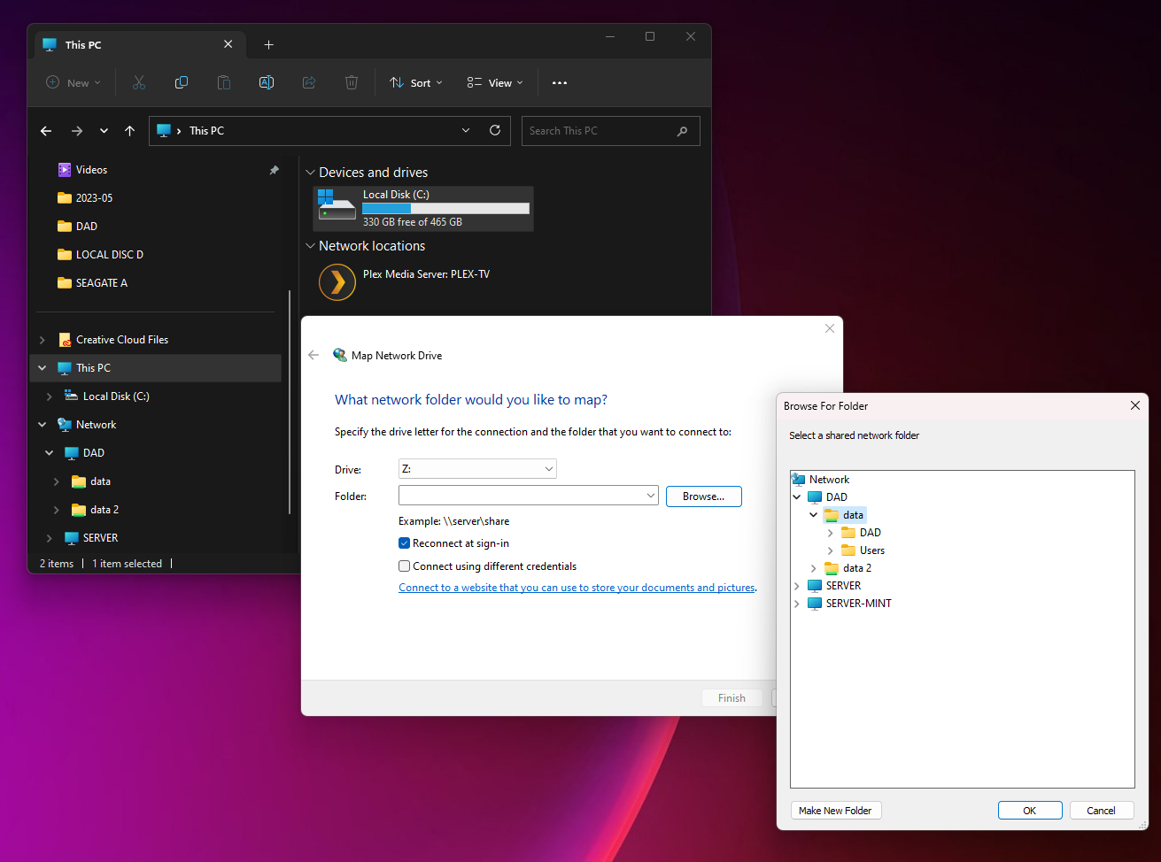

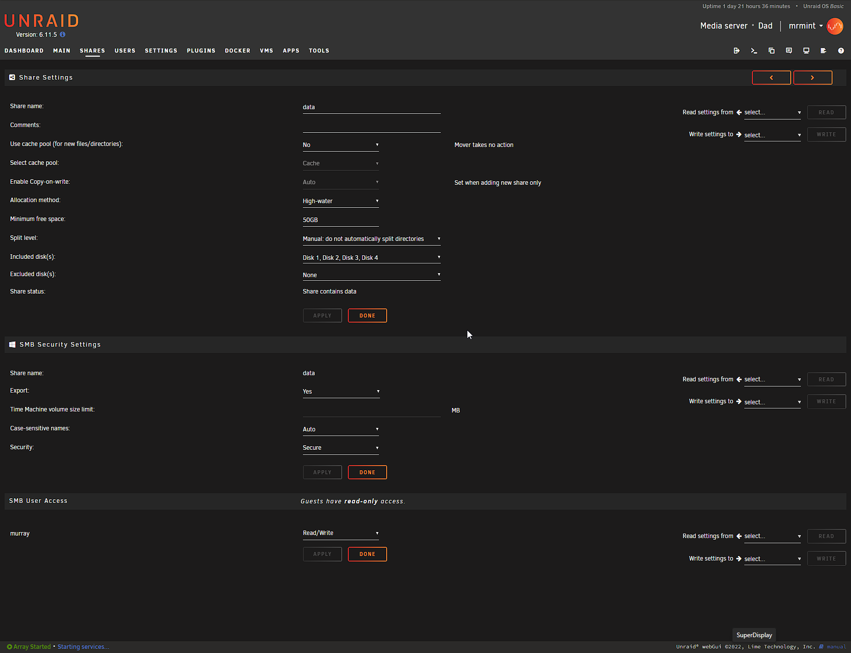

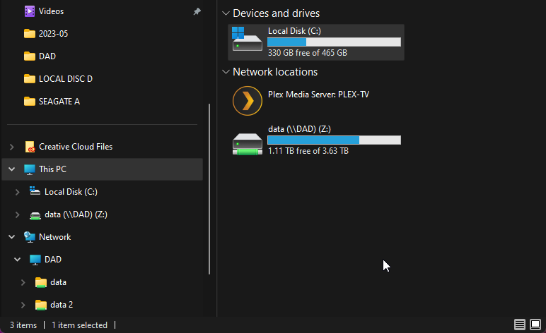

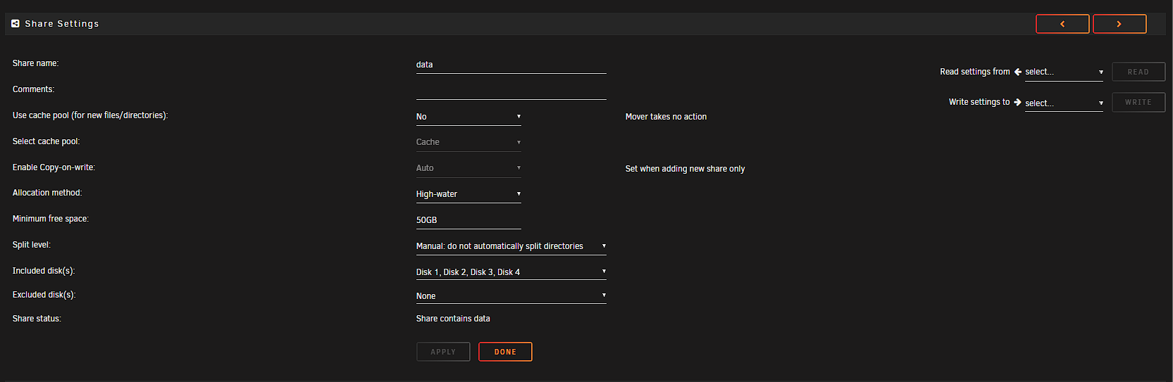

Sure, so when I add the share it only shows the data from one disk not all of them even though I change the share to include all disk once I had finished the data migration.
Attached you can see me adding the SM B share but once I do I am only seeing one disk worth of space instead of all 4.
Thanks for the help

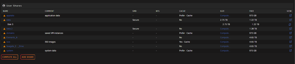

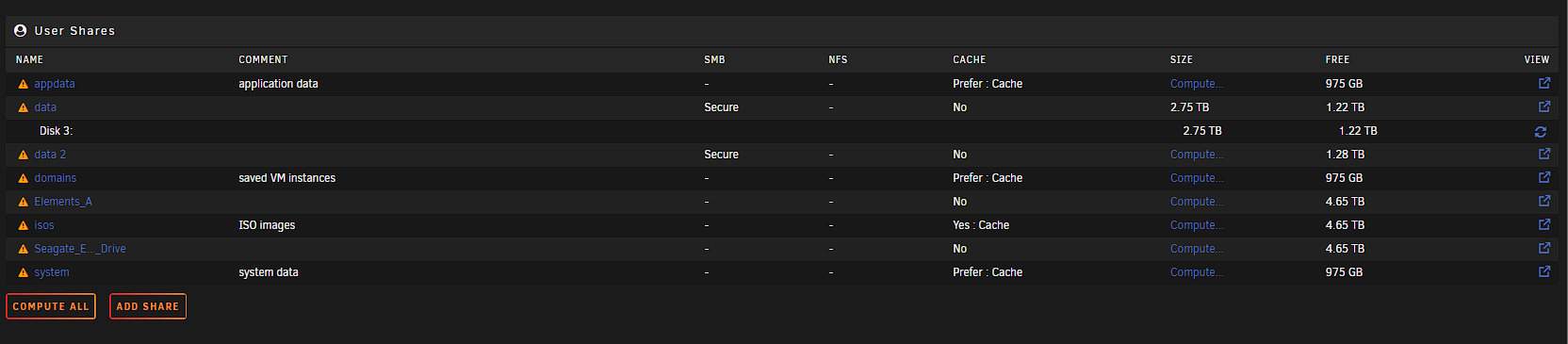

On the shares page click on "compute" for the data share, then post s screenshot of the results.
chrome_vjtZNdPowQ.thumb.png.e268487517b93fa5bfc5b0f6c278c9b0.pngchrome_t4yeZEao05.thumb.png.62a0ae4d10e4433317d3f5a297847e6a.png
That share only exists on disk3, so it's correct, like mentioned shares are just top level folders.
OK. So how do I 'fix' it as per my original post. I would like a share that shows all the disks.
If the folder exists on multiple disks then it is automatically a share of that name covering those disks.
you have not shown anything that shows the folder for the ‘data’ share currently exists on any drive except disk3.   If you were using Krusader to move the files then you also need to check that permissions are correct (if not use Tools->New Permissions) as files with the wrong permissions may not be visible over the network.
