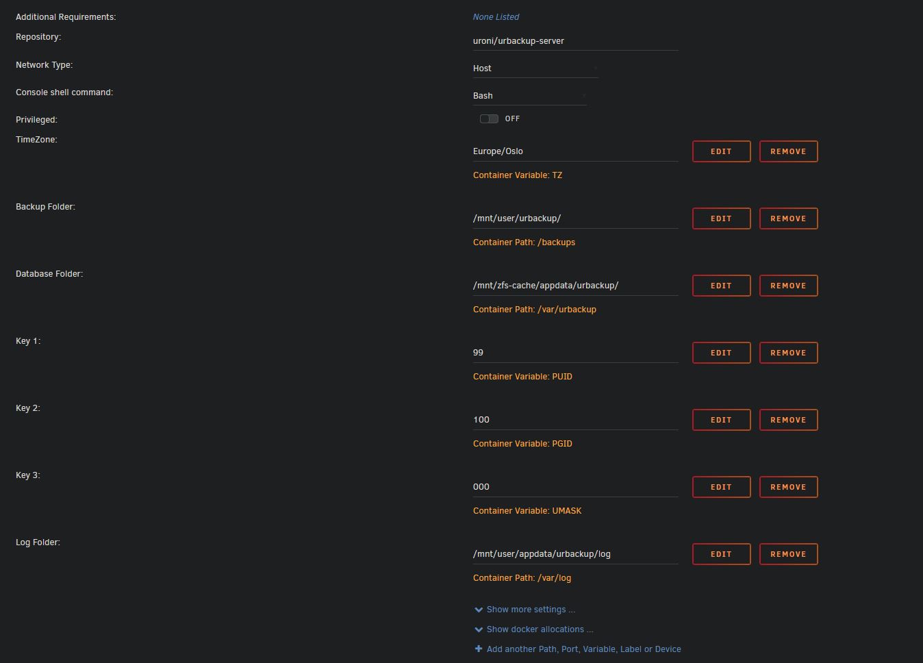

December 22, 20232 yr On 12/20/2023 at 10:59 AM, Masterwishx said: Can you post you container config? Maybe you have some errors in browser console also? Do you have some ad blocker enabled? Reinstalling the container now, restarted the container, and now it works 😮 But I have not installed the client yet. Installing the client, waiting for backup to be done and will see what happens then I do have ad-blocker, but tried it in Edge where I have no addons installed and same happens there. Before I restarted the container, the Urbackup logs say: "Downloading server version info... Downloading dataplan database..." and nothing else happens in the log it seems, not sure if its supposed to update the log with when its done downloading By container config, do you mean a picture of the container settings or from a file?
December 22, 20232 yr Author 2 hours ago, isvein said: By container config, do you mean a picture of the container settings or from a file? As you wish,you can post screenshots, if you still have issue

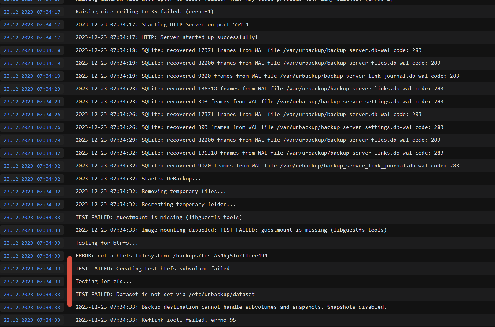

December 22, 20232 yr 6 hours ago, Masterwishx said: As you wish,you can post screenshots, if you still have issue Ok, after an backup of my desktop, shutdown of the container, waiting some time because I got busy and then restarting, at first it wont work and throws the same login error, but then I also get some SQLite lines in the log and after a while it works again. The only change I did this time was that I made an admin user and password in the web-gui. The docker image is an btrfs image on an zfs-mirror pool Also looks like it test if the storage (in my case the unraid array, xfs) is ether btrfs or zfs, but both fails. But for some reason, it seems to come back online now, but to me it also seems that the SQLite database gets corrupted? 2023-12-22 20:52:52: WARNING: Shutting down (Signal 15) 2023-12-22 20:52:52: Exited Loop 2023-12-22 20:52:52: Deleting at.. 2023-12-22 20:52:52: Deleting SelectThreads.. 2023-12-22 20:52:52: Deleting lbs... 2023-12-22 20:52:52: Shutting down plugins... 2023-12-22 20:52:52: Deleting server... usermod: no changes 2023-12-22 22:16:52: Starting HTTP-Server on port 55414 2023-12-22 22:16:52: HTTP: Server started up successfully! 2023-12-22 22:16:53: SQLite: recovered 550 frames from WAL file /var/urbackup/backup_server.db-wal code: 283 2023-12-22 22:17:21: WARNING: Error: Unknown action [login] 2023-12-22 22:18:09: SQLite: recovered 50113 frames from WAL file /var/urbackup/backup_server_files.db-wal code: 283 2023-12-22 22:18:09: SQLite: recovered 3 frames from WAL file /var/urbackup/backup_server_link_journal.db-wal code: 283 2023-12-22 22:18:09: SQLite: recovered 35 frames from WAL file /var/urbackup/backup_server_settings.db-wal code: 283 2023-12-22 22:18:09: SQLite: recovered 550 frames from WAL file /var/urbackup/backup_server.db-wal code: 283 2023-12-22 22:18:09: SQLite: recovered 35 frames from WAL file /var/urbackup/backup_server_settings.db-wal code: 283 2023-12-22 22:19:25: SQLite: recovered 50113 frames from WAL file /var/urbackup/backup_server_files.db-wal code: 283 2023-12-22 22:19:25: SQLite: recovered 3 frames from WAL file /var/urbackup/backup_server_link_journal.db-wal code: 283 2023-12-22 22:19:25: Started UrBackup... 2023-12-22 22:19:25: Removing temporary files... 2023-12-22 22:19:25: Recreating temporary folder... TEST FAILED: guestmount is missing (libguestfs-tools) 2023-12-22 22:19:25: Image mounting disabled: TEST FAILED: guestmount is missing (libguestfs-tools) Testing for btrfs... ERROR: not a btrfs filesystem: /backups/testA54hj5luZtlorr494 TEST FAILED: Creating test btrfs subvolume failed Testing for zfs... TEST FAILED: Dataset is not set via /etc/urbackup/dataset 2023-12-22 22:19:25: Backup destination cannot handle subvolumes and snapshots. Snapshots disabled. 2023-12-22 22:19:25: Reflink ioctl failed. errno=95
December 23, 20232 yr Author 9 hours ago, isvein said: Ok, after an backup of my desktop, shutdown of the container, waiting some time because I got busy and then restarting, at first it wont work and throws the same login error, but then I also get some SQLite lines in the log and after a while it works again. your Setting and logs looks OK , for btrfs,zfs storage you neeed to configure it , also snapshots not working in docker as uroni said ,when asked on urbackup forum: not sure about ```WARNING: Error: Unknown action [login]```
December 23, 20232 yr I found an post on the urbackup forum that talks about the SQLite errors that goes back to over a year ago. But I made an post about the login thing and no answer on that yet.
December 23, 20232 yr Author Not sure if SQL has error, its just getting data form Wal when server starting, but will check it
December 23, 20232 yr Author 4 hours ago, isvein said: I found an post on the urbackup forum that talks about the SQLite errors that goes back to over a year ago. But I made an post about the login thing and no answer on that yet. Please use urbackupsrv remove-unknown -u root and urbackupsrv repair-database Then restart urBackup, Fixed for me
