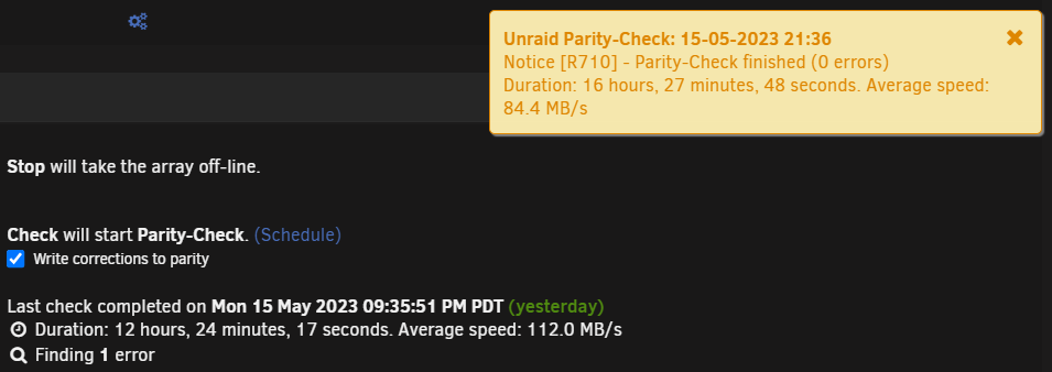

Hello. I ran a parity check and the notification tells me there were 0 errors, but the Main tab shows there was 1 error.
Is this a known issue? Kinda weird that they would show different results, although I imagine the result on the Main tab is correct.

Parity history shows 1 error as well.
Action	Date	Size	Duration	Speed	Status	Errors
Parity-Check	2023-05-15, 21:35:51 (Monday)	5 TB	12 hr, 24 min, 17 sec	112.0 MB/s	OK	1
Data-Rebuild	2023-05-08, 12:43:16 (Monday)	5 TB	16 hr, 27 min, 48 sec	84.4 MB/s	OK	0
Parity-Check	2023-05-01, 19:09:46 (Monday)	5 TB	16 hr, 9 min, 45 sec	85.9 MB/s	OK	0
The longer explanation is one of my drives started throwing read errors. I tried rebuilding it in a naive belief that it was a one-time event. Unsurprisingly, it was not.
I then used the clear_array_drive script to zero out the drive without losing parity and then permanently removed it from the array as I don't really need the storage anyway.
To be safe, I ran a parity check afterwards and it came back with 1 error, but the notification says 0 errors.
