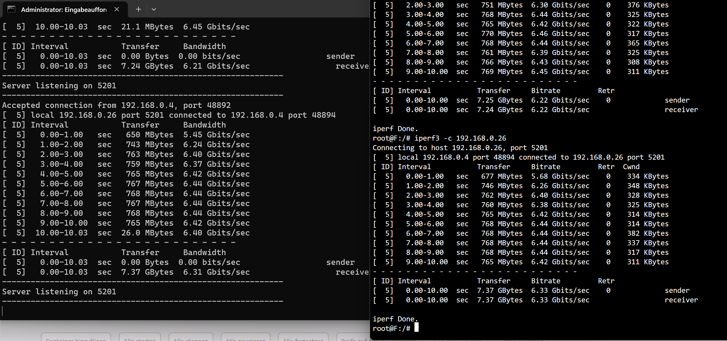

Ive bypass the switch and now doing back to back im still getting the same 2.5-3Gbe testing with iperf3. Both card are plug into a Gen 3 X16 Pcie Lane.

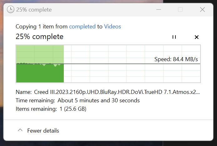

Before this i manage to get the max SSD SATA6 speed which is about 400MB/s but recently i notice that i only manage at about 40-60MB/s that's where i start to test the connection and notice my 10Gbe only do 2.5-3Gbe speed. and file transfer wont even goes above 80MB/simage.png.6a5d2041a7ee348d7b858e0bb87a6f14.png

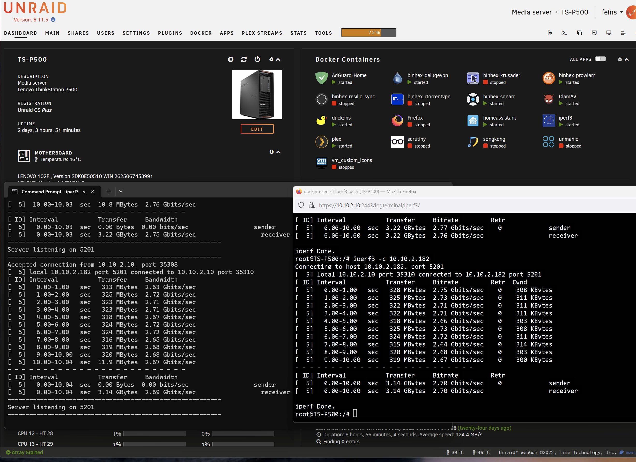

54 minutes ago, feins said:
Now iperf3 for unraid is in docker now
Yeah, maybe, but still I would set up this docker to use "host" networking instead of a bridge. Would show the real IP Addresses instead of the virtual ones.
(and mayb a bit faster because the detour is not there anymore)
I've just tested myself... the docker is eating up a lot of performance. but not even close to your results...
anyway, you must have done somthing to the docker. the default is "host" mode, I've just checked it. So you have modified the setup somehow

Ive tried if don't bridge eth1 i don't get any DHCP IP. Even if i configure static IP on both Port i can only ping to the Server but cant reach the internet seems it don't route out.
I didn't change anything while installing iperf3 as i don't change the default setting for docker unless been told or instructed. I will change it to Host and try.
Seems same result. poor throughput between Unraid and Windows.

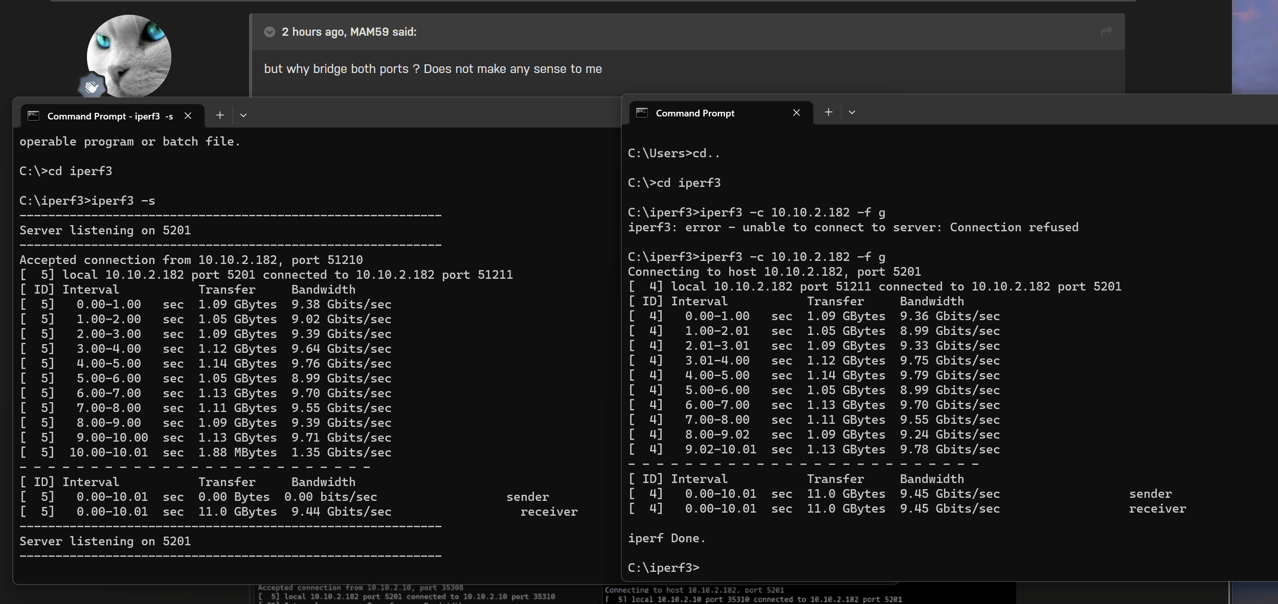

I just perform a loopback test on my workstation and seems loopback i manage to get 10Gbe throughput.
