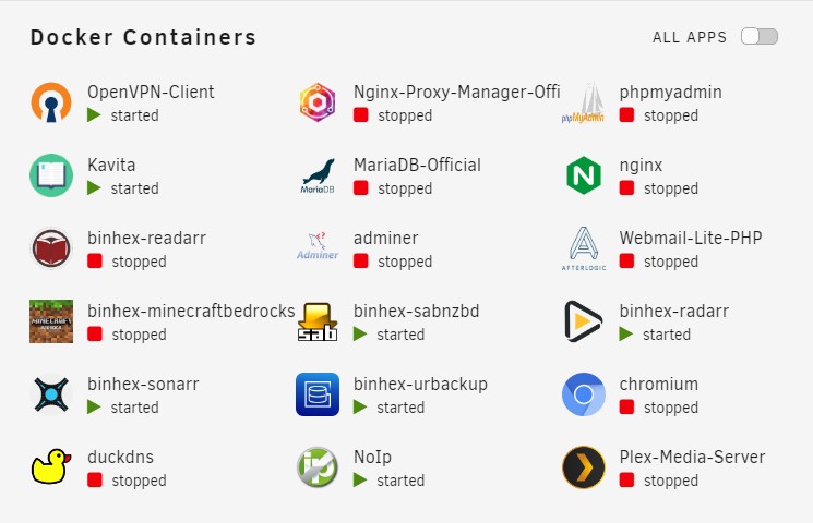

Downgraded From 6.12.0 RC5 to 6.11.5 Docker Issues
After downgrading I'm having issues with some of the dockers not starting and kicking out an "execution/server error".

On 5/17/2023 at 7:36 PM, Squid said:
As a test, can you try uninstalling the nvidia plugin, reboot and see if there is any change.
I did an experiment and uninstalled one of the dockers, then re-installed. That worked. So I did the same with the rest fo the dockers. I only had issues with Webmail Lite not connecting to the databse. That was resolved entering in the info again. Thanks!
  • 5 weeks later...
Oof yea. same problem here. I rolled back from 6.12.0 (live) and now only a couple of dockers work - and googling my error sent me to your thread :)
Thanks for updating on a work around at least. Not sure what I will do at this point, reinstall everything, or go to 6.12.1 and hope for the best.
Small edit to add: looks like it works fine again if you re-update. I went to 6.12.1 from 6.11.5 directly, rather than reinstall my docker images, and they all start up again.
Edited by Chunks
From the 6.12.0 release notes:
https://docs.unraid.net/unraid-os/release-notes/6.12.0
If you revert back from 6.12 to 6.11.5 or earlier, you have to force update all your Docker containers and start them manually after downgrading. This is necessary because of the underlying change to cgroup v2 starting with 6.12.0-rc1.
