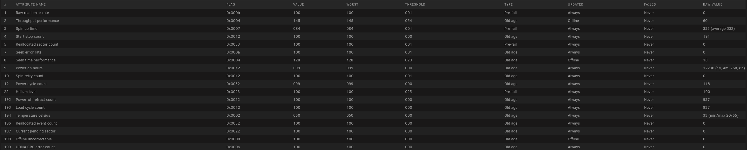

It looks like the disk simply just stops responding for some reason, I am unsure what to make of this.
SMART data
708261699_Screenshotfrom2023-05-1721-46-00.thumb.png.3b2b1c26fa116ecb9ab628fe0bacea6e.png
