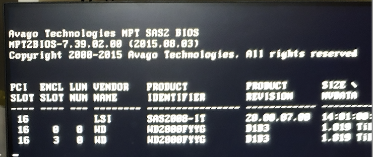

I've recently purchased 2 x SAS drives from ebay and connected them to a Fujitsu 9211-8i.
On startup, the disks are not detected.

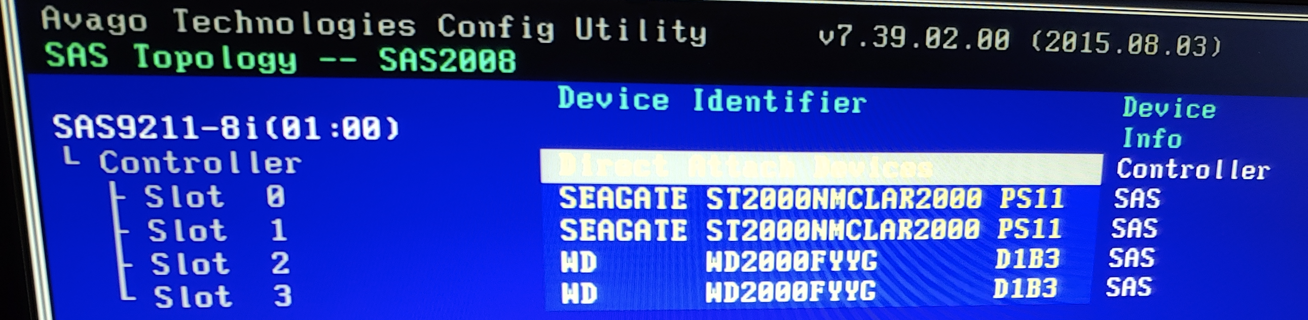

But they show up inside the Avago Config Utility ie Slots 0 and 1 (ST2000NMCLAR2000 PS11, but has ST2000NM0001 on the label )
1051361383_ScreenShot2023-05-15at8_13_22pm.thumb.png.54cac554e60a8441c822c430fb83f57e.png
I've successfully formatted them using the config utility, but still the same issue. I tried other breakout cables and connected to an HPE H240 HBA but still no luck.

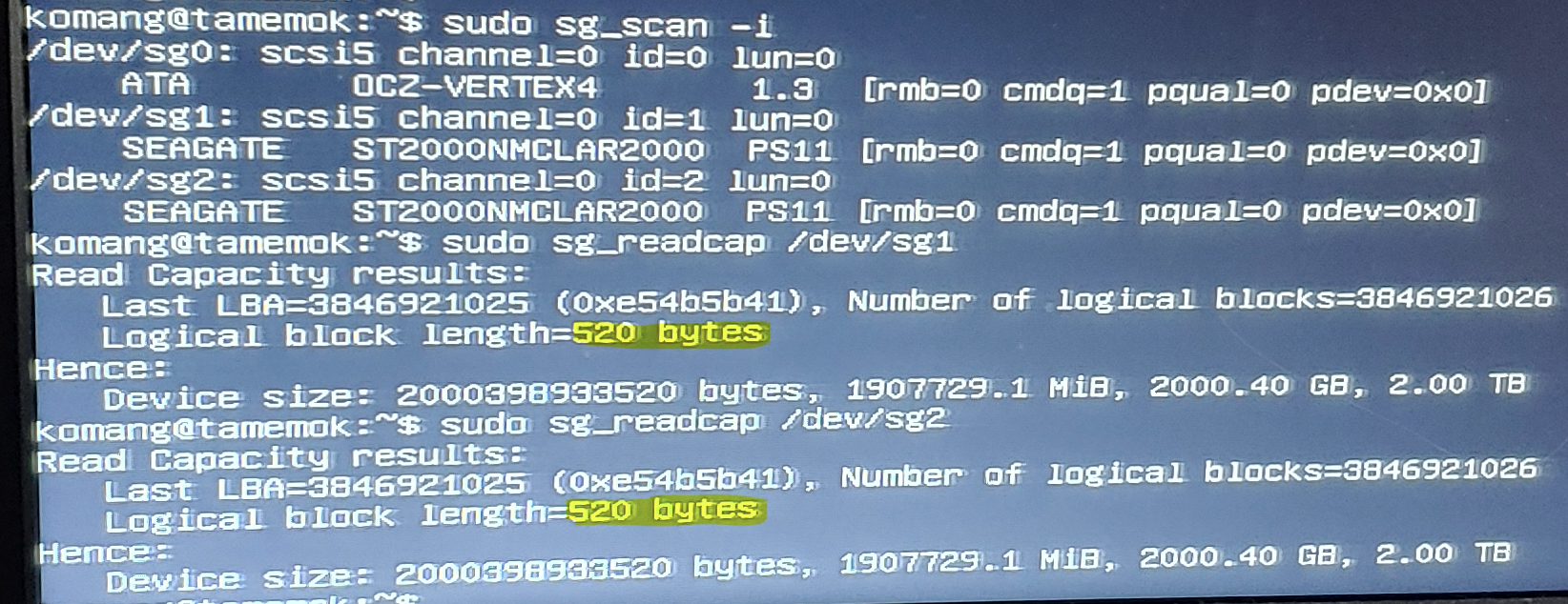

TLDR: 520 byte block size, needs 512. How to fix
The problem was the block size. The disks were pulled from an EMC device and had a 520 byte block size.
948740273_ScreenShot2023-05-20at7_17_20am.thumb.png.3783d1b5e1e05891d3ed77c824cefcf9.png

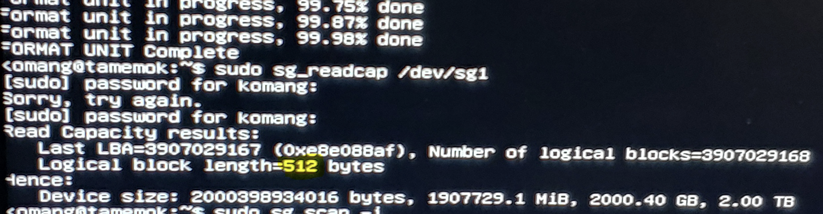

Installed Ubuntu Server 22.04.2 amd64 and didn't need to install ligsgutils2 & sg3-utils. Formatted disk to 512
1736416397_ScreenShot2023-05-20at7_21_33am.thumb.png.a78eb57e8946509eba34f00d3d942c4f.png

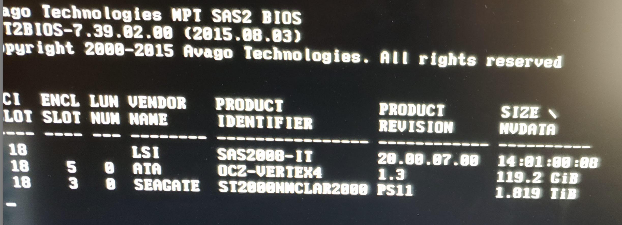

Disk finally detected on startup ie Slot 3 ST2000NMCLAR2000 PS11
